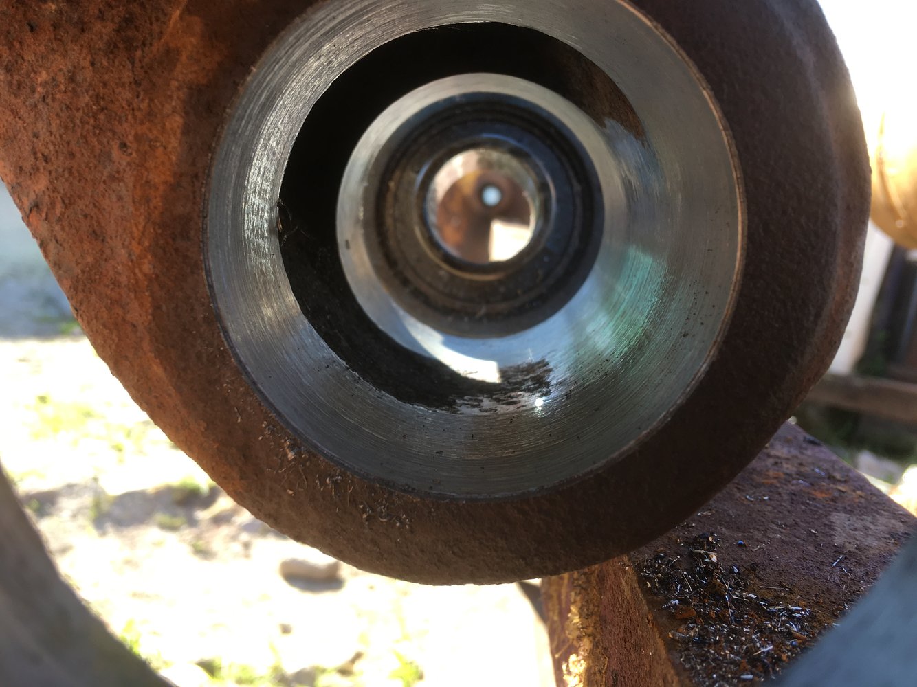

Thankyou @Agroshield I will have a good think about what you have written.These two are good:
Understanding the Boring Bar ISO Code System
Confused by boring bar ISO codes? This quick guide explains what each letter and number means so you can select the right boring bar for your application.www.cutwel.co.uk
MMC HARDMETAL U.K. LTD
www.mitsubishicarbide.com
For your bar: (S) steel (12) 12mm dia. (M) 150mm long (S) screw mounted insert (C) insert shape (L) lead angle 95 degree (C) relief angle 7 degree (L) left hand (06) insert size 06.
For the insert: (C) insert shape 80 degree rhombus (C) clearance 7 degrees (compare with relief in the bar code) (M) tolerance. M is standard; only other common one is G (for ground) (T) fixing method hole (compare with screw mounted for bar) (06) insert size, same as bar code (02) insert thickness (02) corner radius. The HMCTP125 is likely specific to the insert manufacturer.
One thing to note is that the corner radius has a big bearing on the fragility of the insert. A larger radius (06 inserts can be had in 00, 02, 04 & 08) might help with the type of cut you are doing - maybe the 08 radius for the first pass of the welded bore and then change to an 04 or 02 for finishing. Using an 02 from the start may be one of the reasons for the broken tips you mention.
I could only find one reference to your insert, from protool, and they do not provide a translation of the manufacturer-specific part. If you go for a brand name insert, there will be a data sheet available with this info. on it. One thing to note is that carbide is available in different grades - some are tougher then others, some more wear-resistant than others. For the initial pass of the welded bore, you need an insert with the maximum toughness until you have removed enough material to obtain a uniform bore.
Even if you go for an HSS tool as suggested above, the grind on the roughing tool will be quite different to that of the finishing tool.
It’s all a learning curve at present.

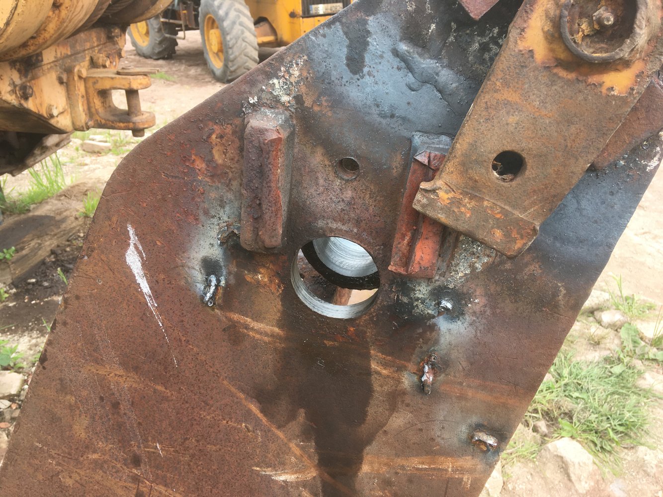

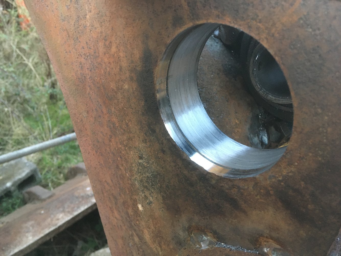

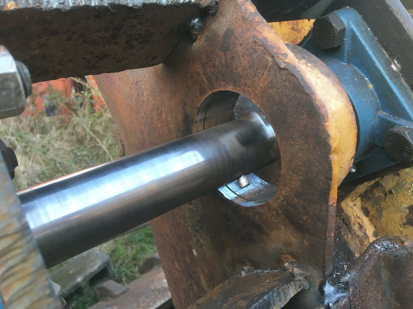

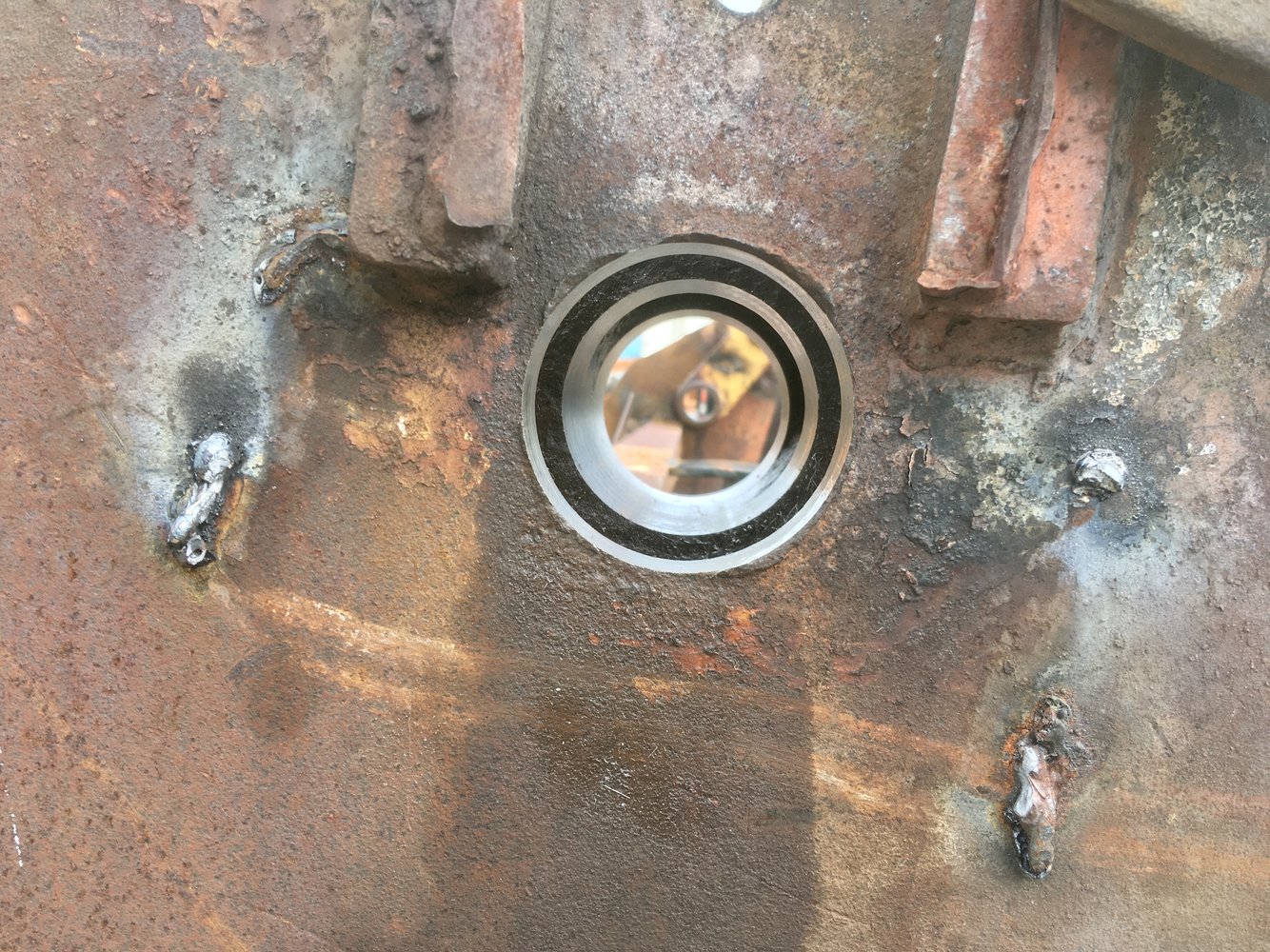

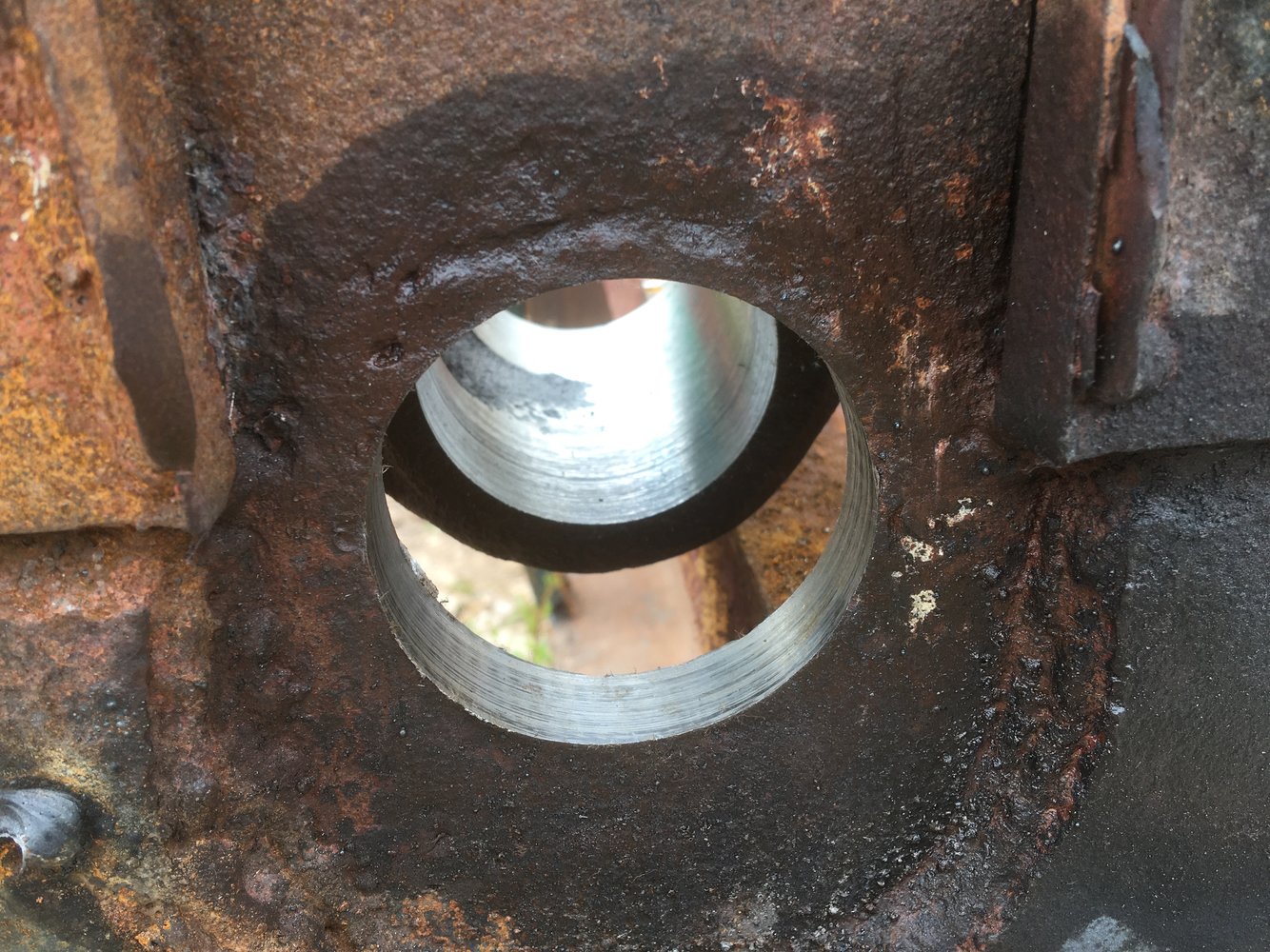

I should have stated that the bores have not been welded up in any way as we thought this may complicate things further.
The plan is to take out just enough to get a round hole in each of the bits that need doing then we can have a bush made up to fit.
The 2 sizes chalked on are what we stated with and the size we ended up with to get a true hole.
Hope that all makes sense lolol
