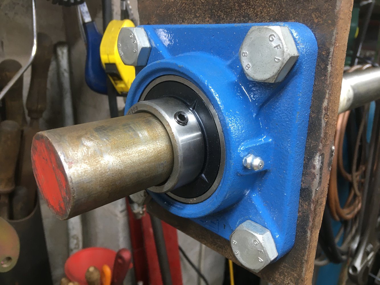

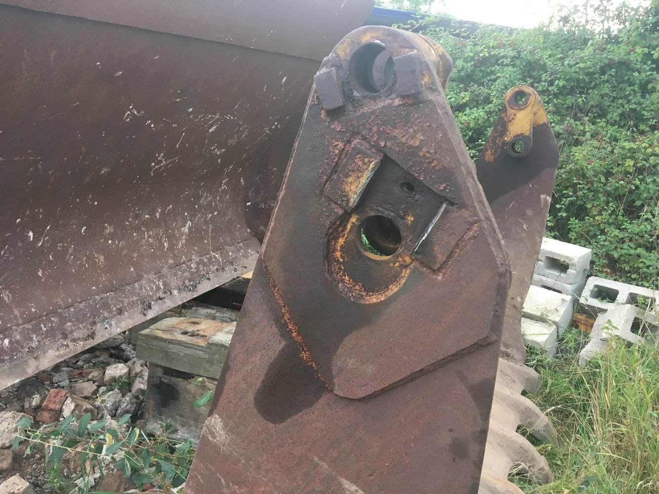

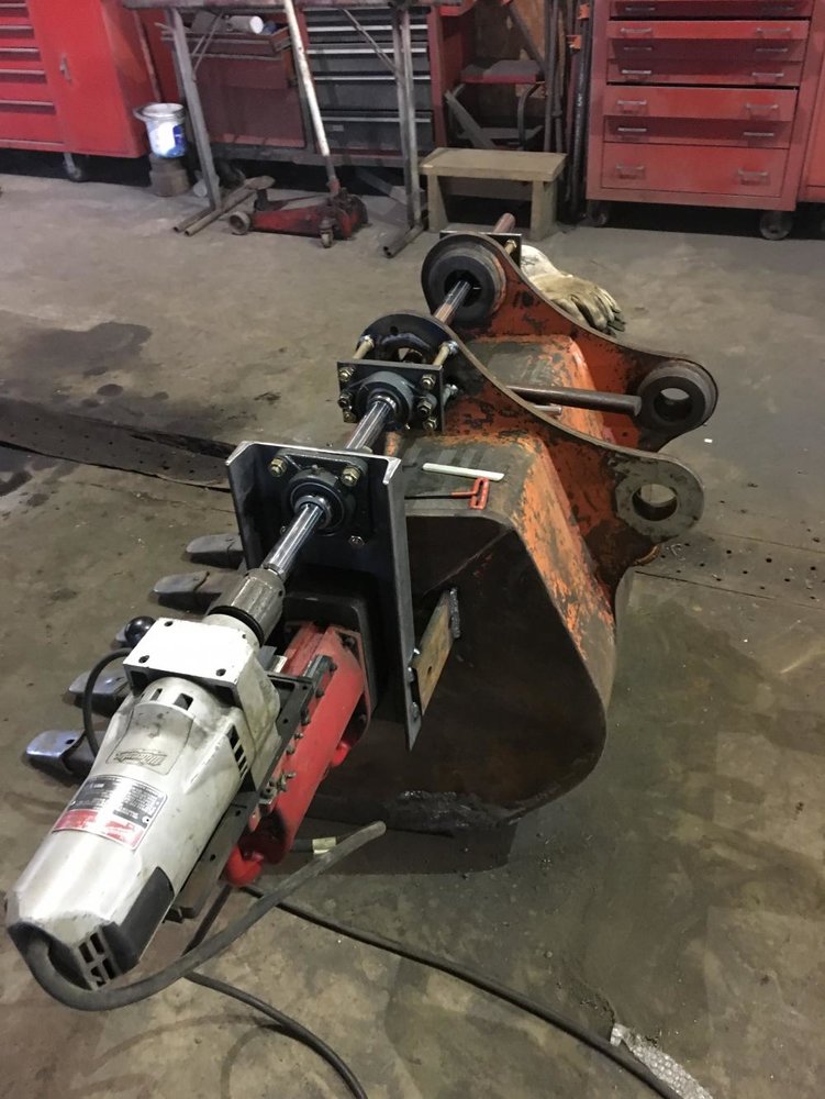

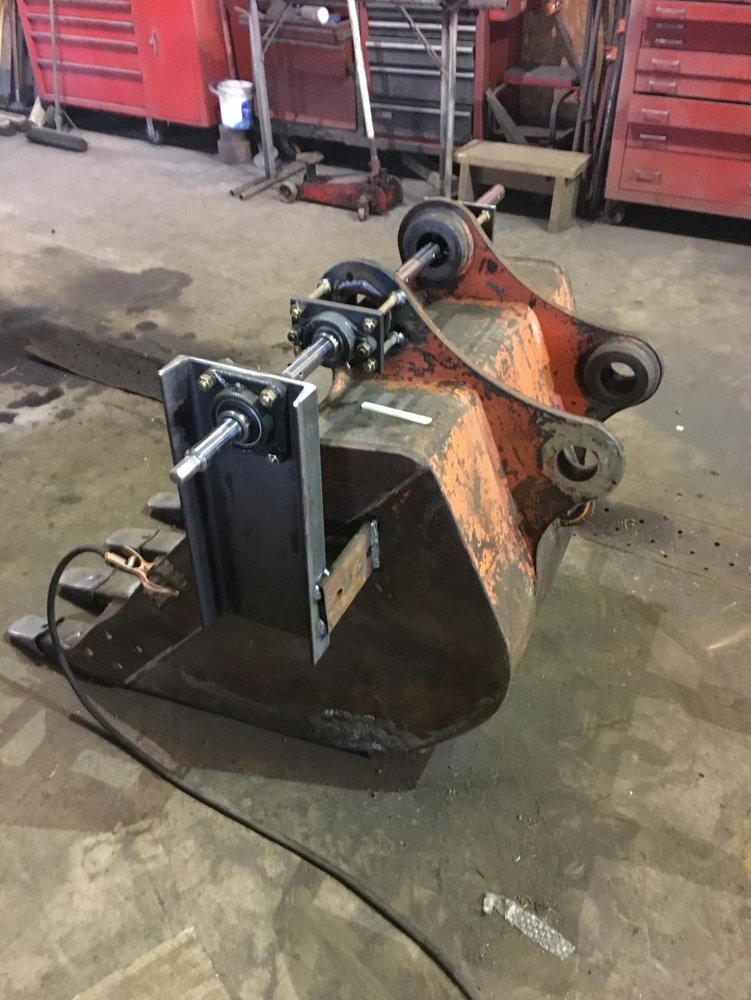

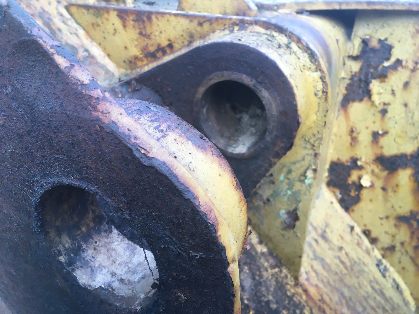

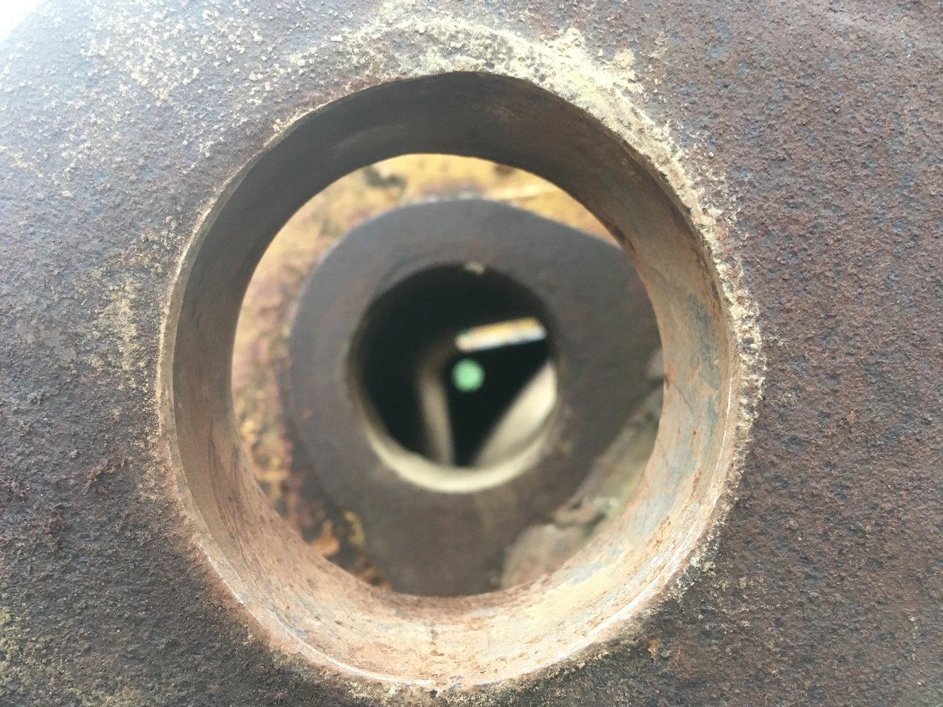

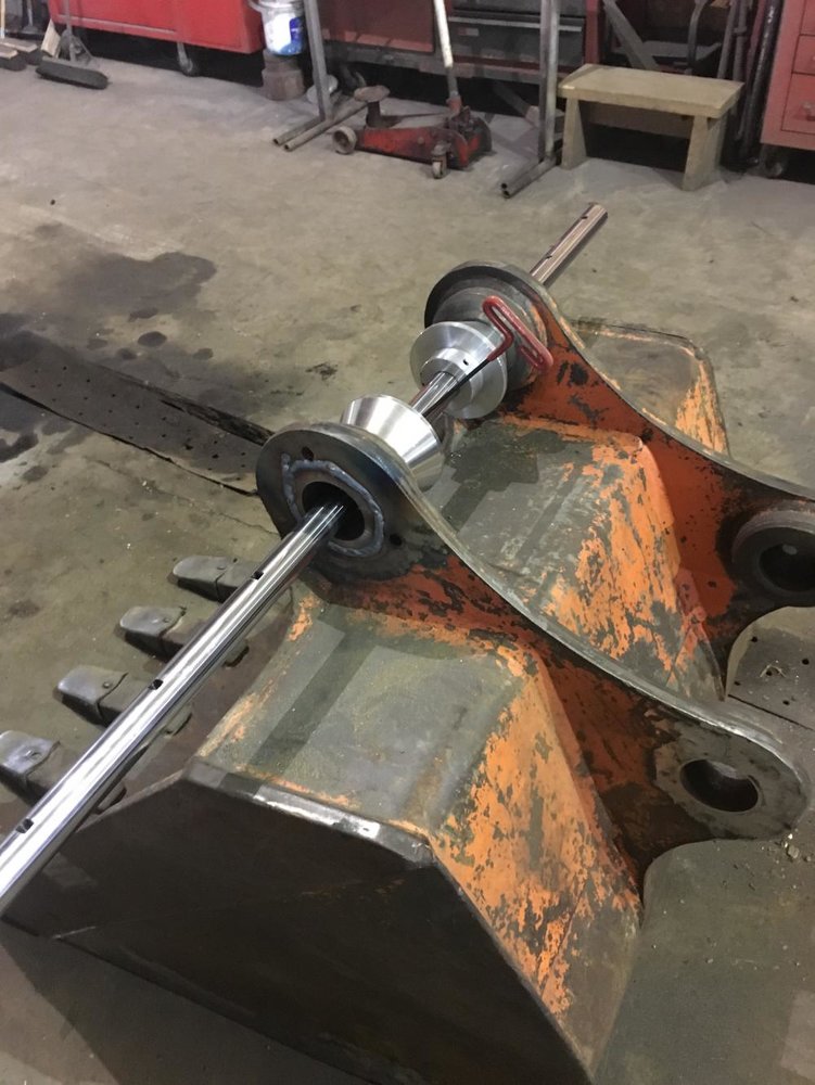

I should have stated that the bores have not been welded up in any way as we thought this may complicate things further.
The plan is to take out just enough to get a round hole in each of the bits that need doing then we can have a bush made up to fit.
The 2 sizes chalked on are what we stated with and the size we ended up with to get a true hole.
Hope that all makes sense lolol
