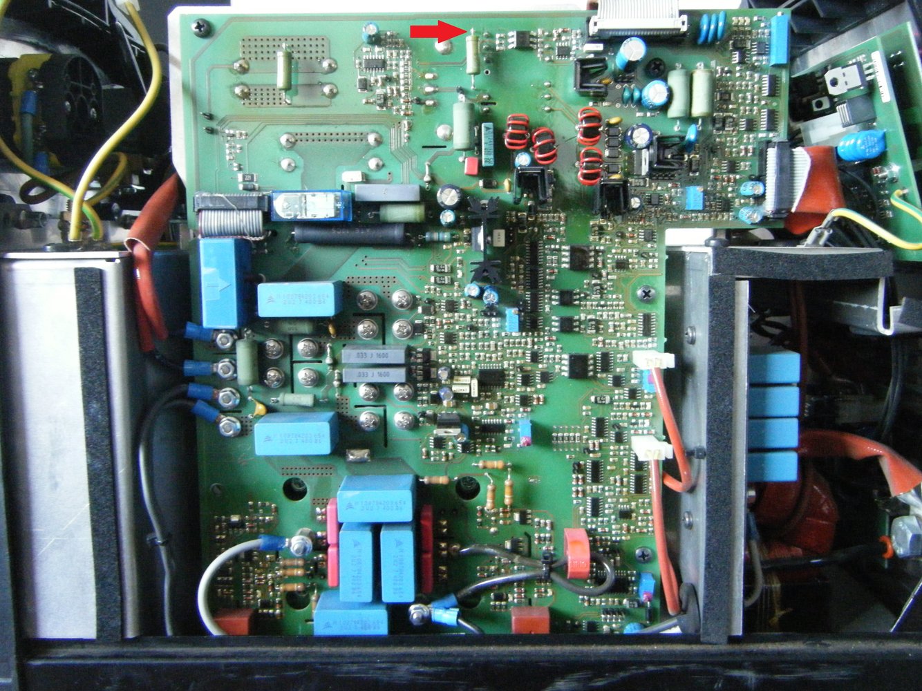

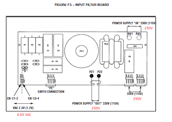

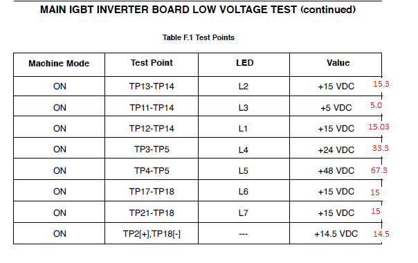

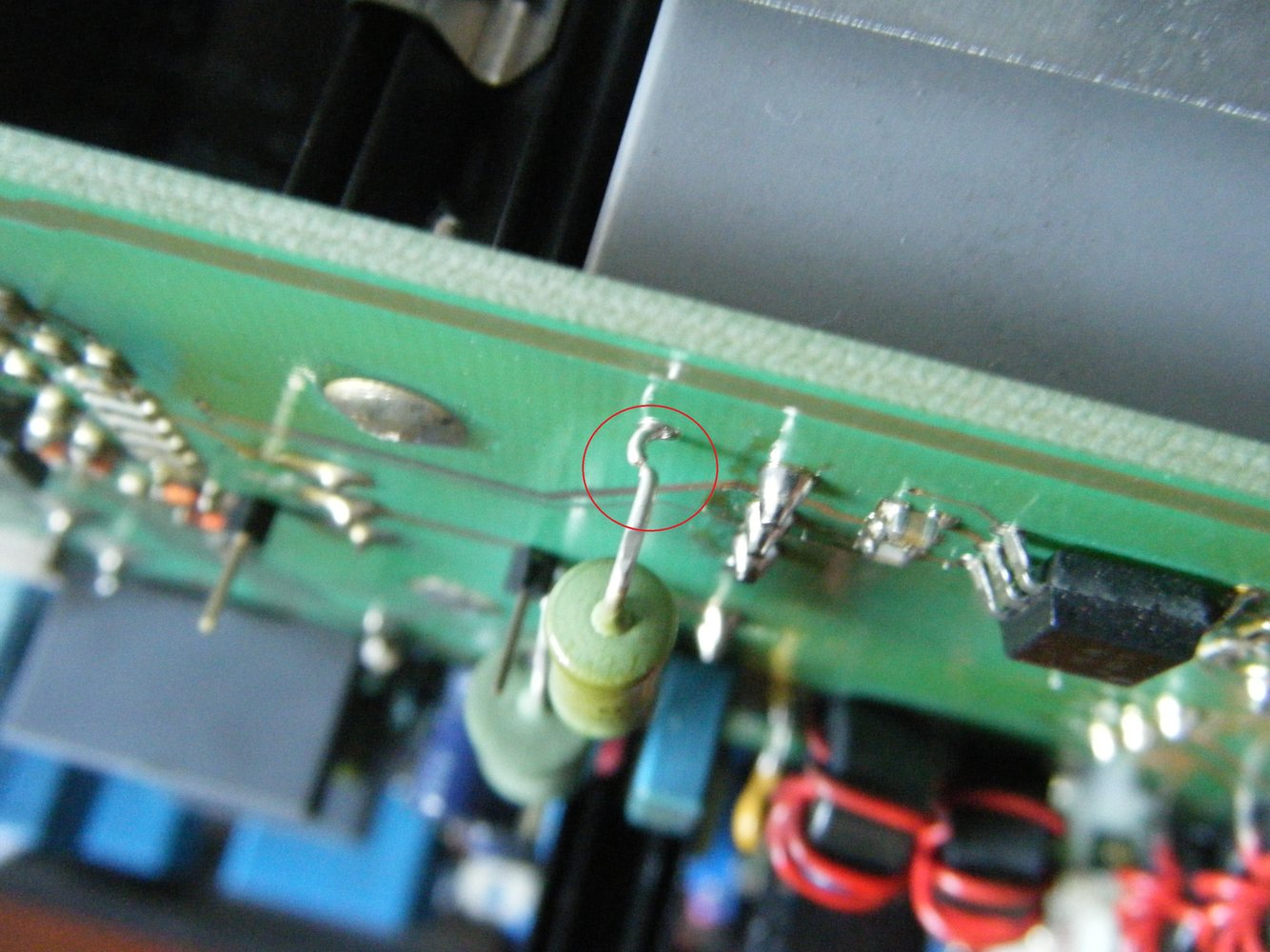

I'm a hobby welder and treated myself to a Lincoln V205-T ac/dc machine to get into Tig, bought second hand from a retiring self employed mobile welder, it was his spare machine so had basically lived in his van, or so the story went. It worked fine for me for about a month (240V supply in my garage), then I got the E11 error, 'input voltage too high'. Switch it off and then on again, it worked fine as normal. This got me by for another month or so, I dont do much welding day to day. Last weekend, it took 2 or 3 power cycles before it didnt throw the error, then welded fine for almost 4 hours. The following day I just couldnt get it to not throw the error no matter how many times I cycled the power. I wondered if the fact I have my welder supply on a Type D slow blow MCB, could this have been confusing the voltage detecting filter board, so I tried it on another circuit in my garage without the D type MCB, same error, I then tried it on a 110v supply, as its obvs the voltage sensing dual 110/240 model. This time i get E12, 'input voltage too low'. Took it to local lincoln repair shop, they fixed it with factory reset and gave me it back (i assumed it was a more conclusive factory reset than I had already performed), or so they thought, E11 within seconds of turning her on when I got it home. Returned to repair shop, now told it needs new inverter board at £1200.
The fan comes on when its powered up, it throws the E11 in all modes, tig or stick, it throws it whether HF is set to on or off, from a factory reset of all parameters it will turn on, the fan will be on, and within 5 minutes just sat on standby, no buttons pressed, no trigger touched, it will throw E11.
