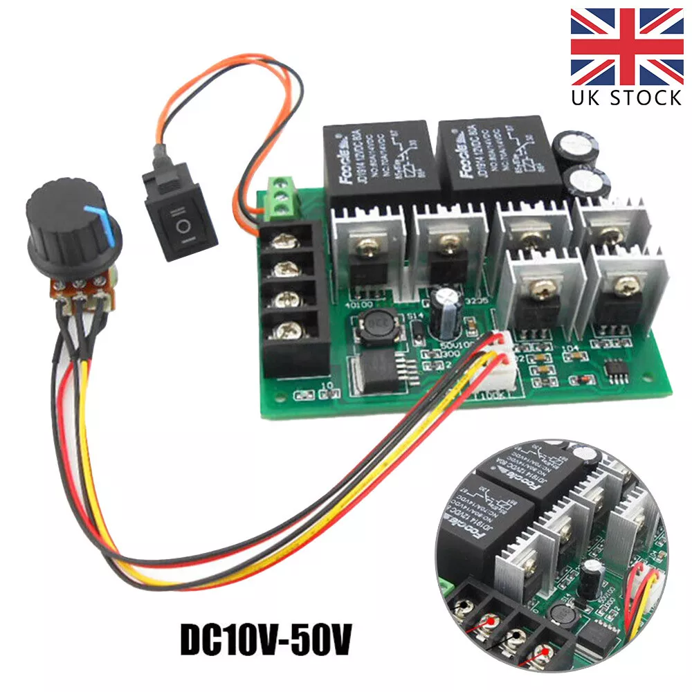

This is the motor control that I have, it's fed by 12v dc which is fine, I can reduce the speed with the pot and change motor direction with the 2 way switch. (The motor actually runs fine in reverse just by swapping the polarity, I tried it to begin with, with a 12v battery).
The coupling that I made, which is fastened to the motor output shaft, has a grub screw in the other end and a grease nipple on the opposite side. I nip in the grub screw when I want the table to motor feed or unscrew it when I manually feed.
Now, I definitely need a stop switch incase the table was ever to reach the end of it's travel when motor feeding, if that was to happen for any reason it would probably burn the motor or some of the electrics. It would also be good to stop the feed at the desired length of travel on every cut, so a limit switch would need to be moveable along the length of the table.
If I was to fit a limit switch which opened when the desired travel was reached, I would have to switch off the motor, undo the grub screw, wind the table manually until the limit switch closed, then tighten the grub screw and start the motor in reverse. This is what I am trying to avoid by having a reverse switch.
The table resistace stops the motor abruptly, I think it would be ok to change into reverse immediately although a time delay as someone suggested would be better.
