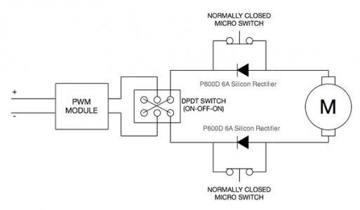

You could do it with the trigger switch from a cordless drill.
When the table reaches the end of the stroke a lever would operate the fwd/rev switch first selecting off and then reverse, table goes backwards.
Hopefully momentum will be enough to keep the lever moving from the off to the reverse position.
Arcing could be a problem as these don't normally switch over under power.
