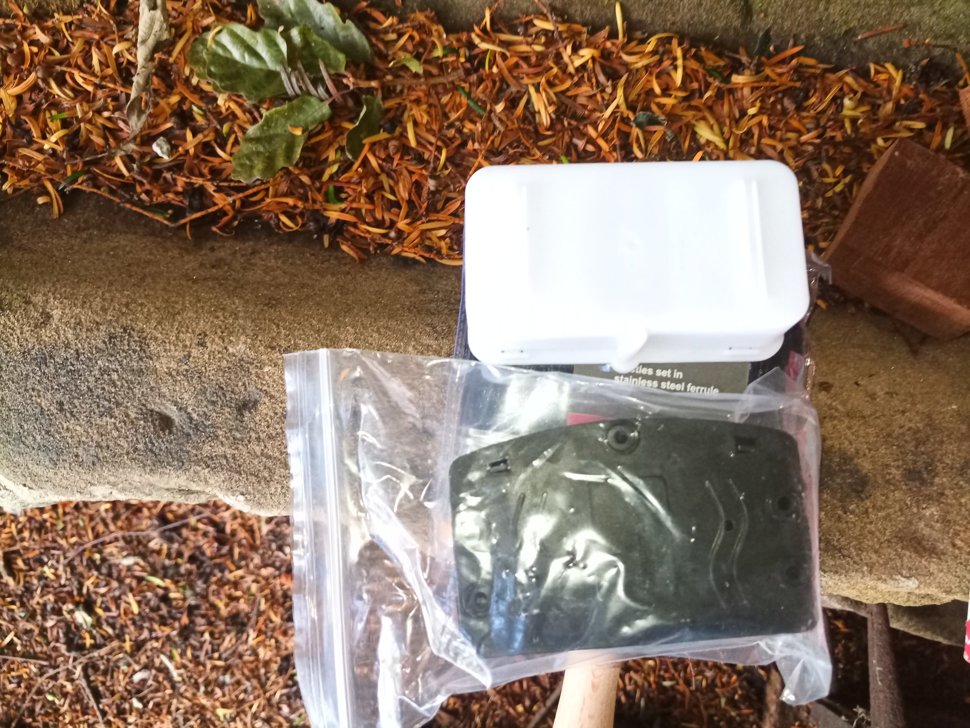

Noticed all the newer light fittings/units, none of them have space for the lighting ring/switch connections, only L, N & E.
I dont like it, but on two lights I replaced with LED units, made the ceiling hole a bit bigger, made the ring connections with choc block and poked it up into the hole. How is this supposed to be done?
Just been & picked up some choc boxes to enclose the choc block above the ceiling.
