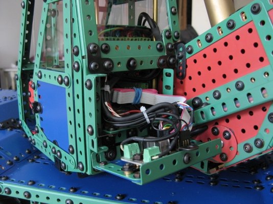

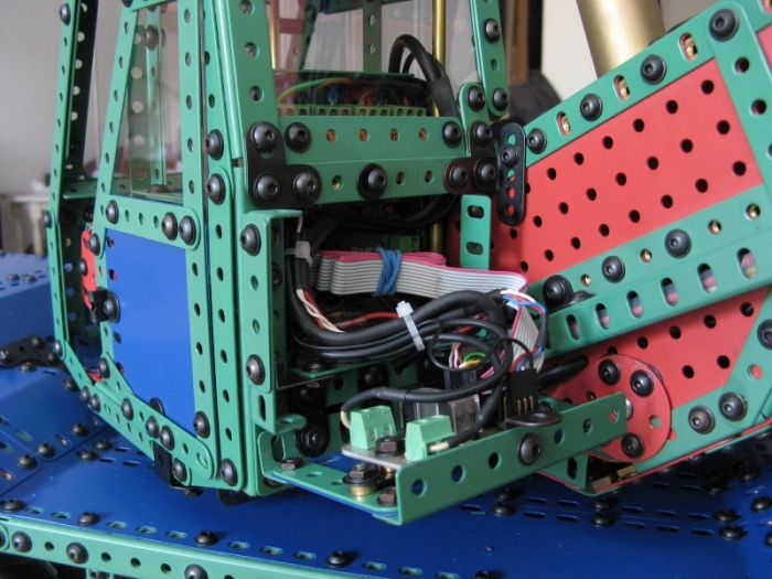

Seeing the amount of motors fitted, is it driven via an umbilical from a control box?

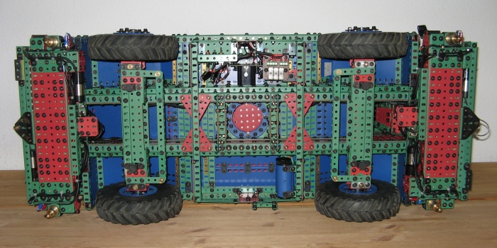

The slewing bearing is a standard industry part and it sits on the chassis with an adapter ring. The large rings are thicker steel compared to normal rings so the construction is rigid. The slewing gear pinion is driven by a gearbox motor.
@ smoggyrich, for sure there will be thrust bearings on either side to cope with the forces. I don't suppose they make do with a roller bearing!? That gear is huge! Thanks for the info and your kind comments.

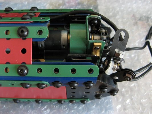

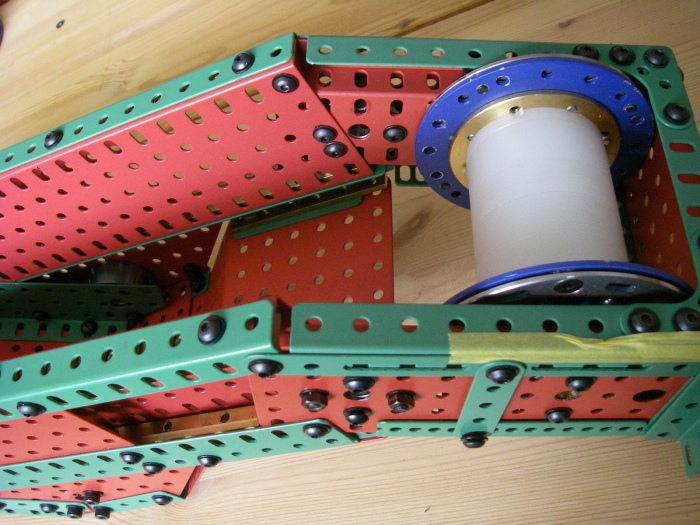

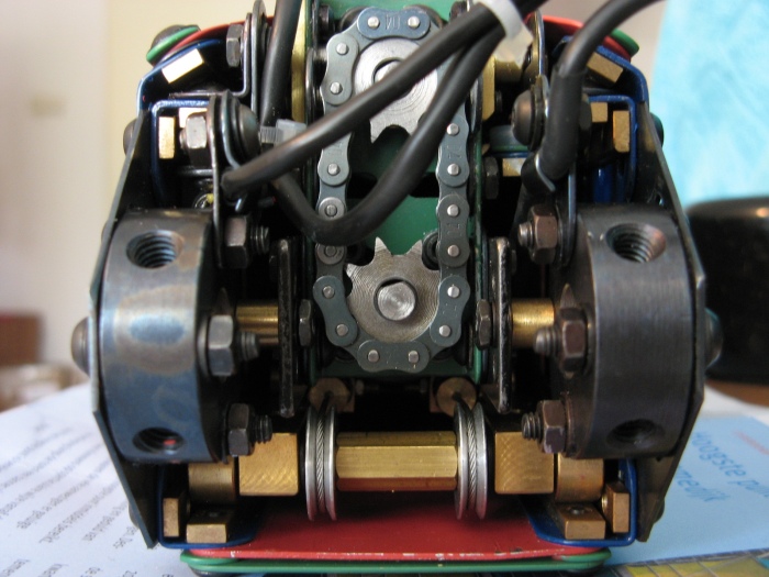

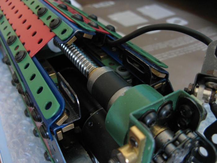

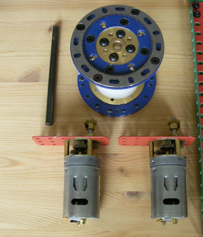

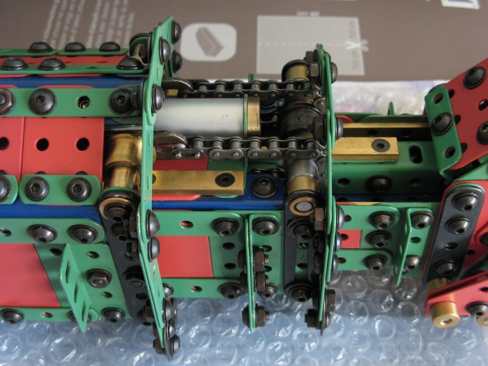

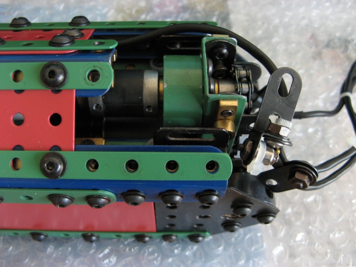

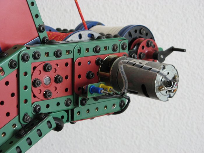

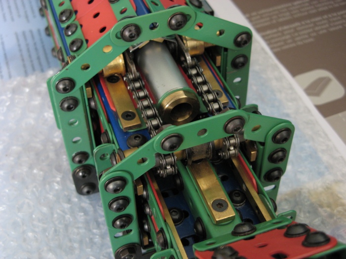

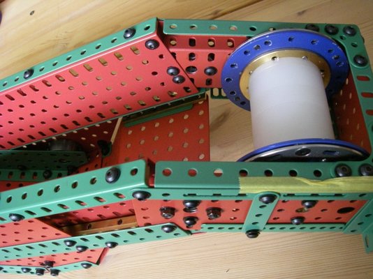

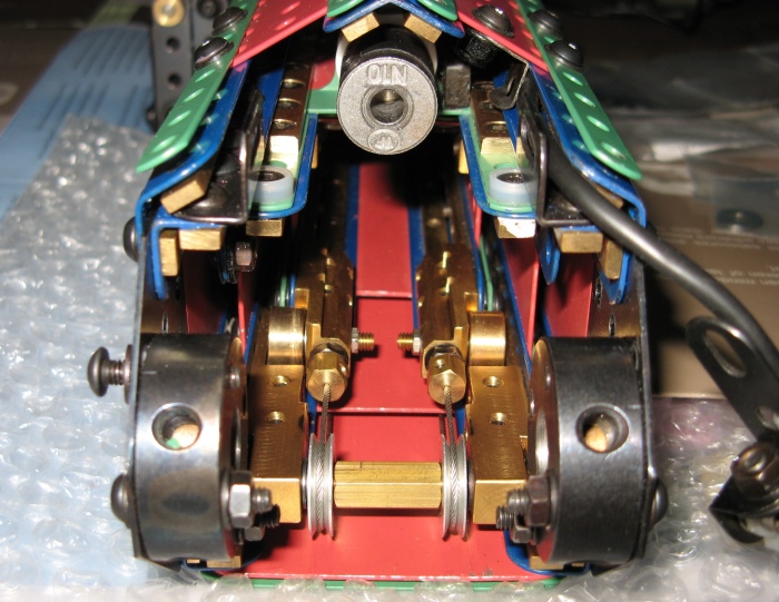

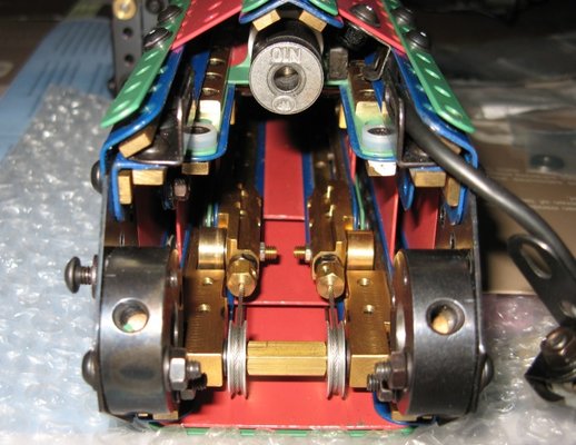

Hello everybody, figuring out just where to install the motors that drive the winch was food for thought. I could build them inside the winch drum, perhaps? They take up a vast amount of space if I'd place them nearby this drum. Well, the motors aren't in there which is shown in the next series of pictures.
