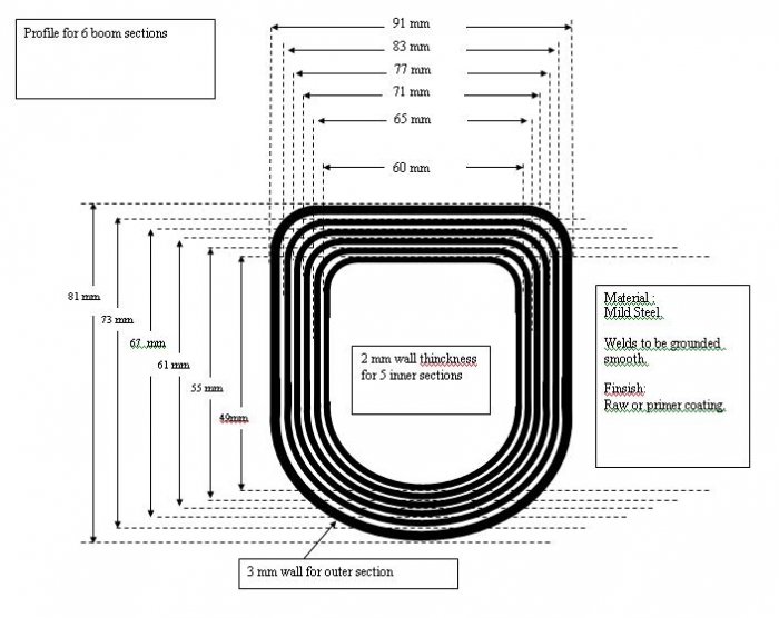

thats whay I envisioned hitch,,,, spot on even if I say so myself
note section in hitches pic looks more square than rebeccas illustration?
Rebecca... now you have a real idea of what you want, decide what you want to use re materials etc & someone will do it... but while you are "fishing for ideas" most will avoid because it can just end up taking a lot of non productive time for them
we know what we want, the shapes and how to form the multiple curved sections to nest properly ... so should be a little more straightforward now.

. The more info you can give him the better. As said above radius's, distances between,length, material type and section, No. of pieces , primer type/color and tolerances you will accept, is a pressed radius ok or does it need to be rolled and any other info you think may be relevant. You may be better splitting the above detail into individual components.
.) 90% of this job is setup time, not material or production time.
