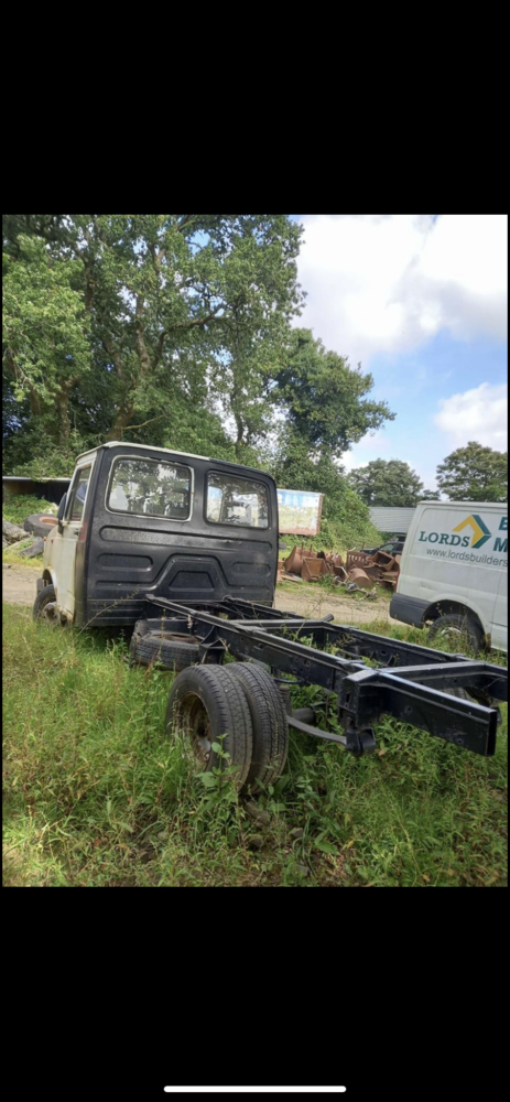

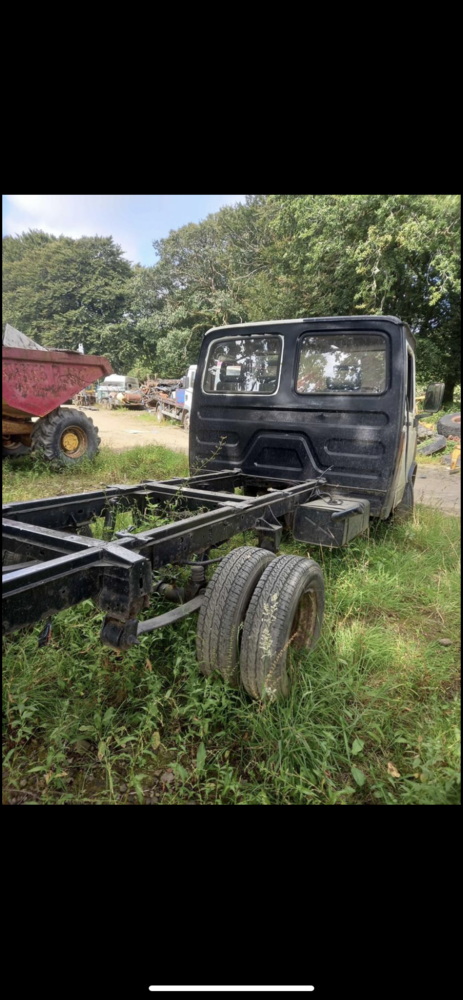

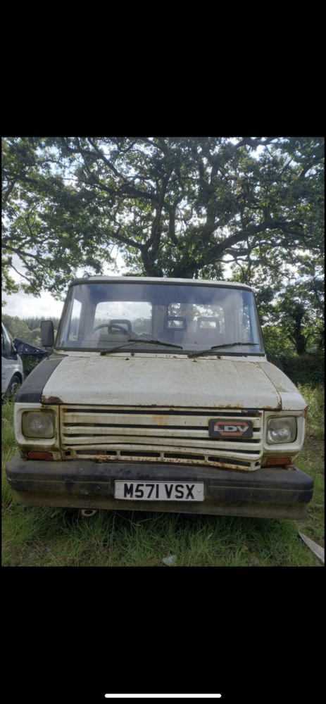

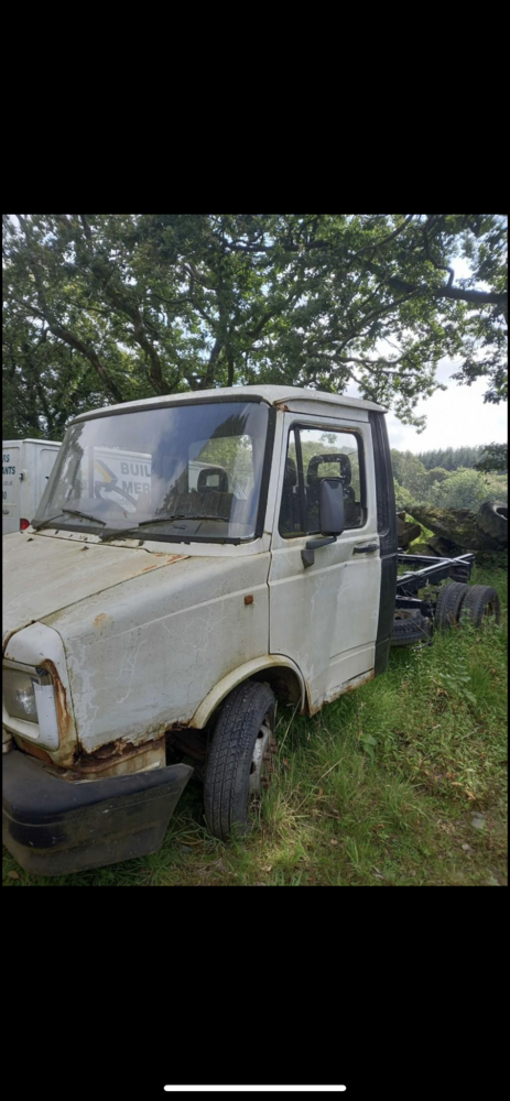

What's the bodywork like ? Do MOTs in Blighty allow severe rust.
Any perforating rust here is a fail.
Chassis ain’t too bad, two “patches” previous owners put on that need sorting out properly. Wings and doors are both a bit gone at the bottom, step and floor plan showing surface rust but seem solid (by that I mean survived my test with the screw driver and structural tapping hammer). Apart from that needs rear end sorting out with lights etc, exhaust silencer, and some sort of body!What's the bodywork like ? Do MOTs in Blighty allow severe rust.

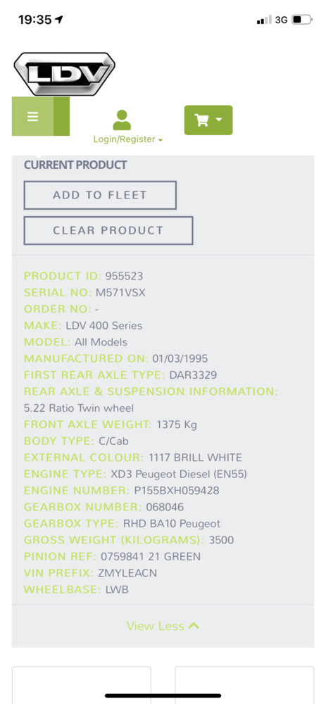

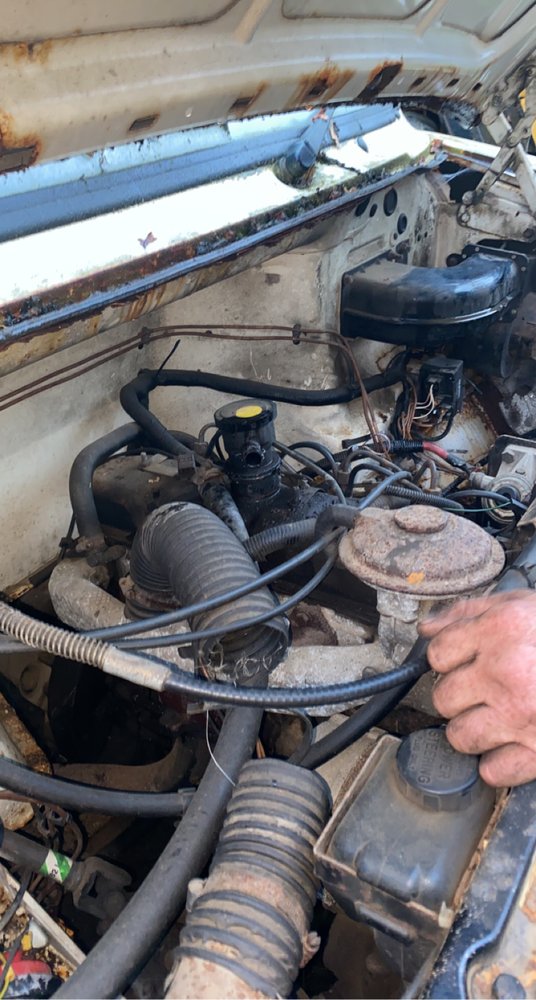

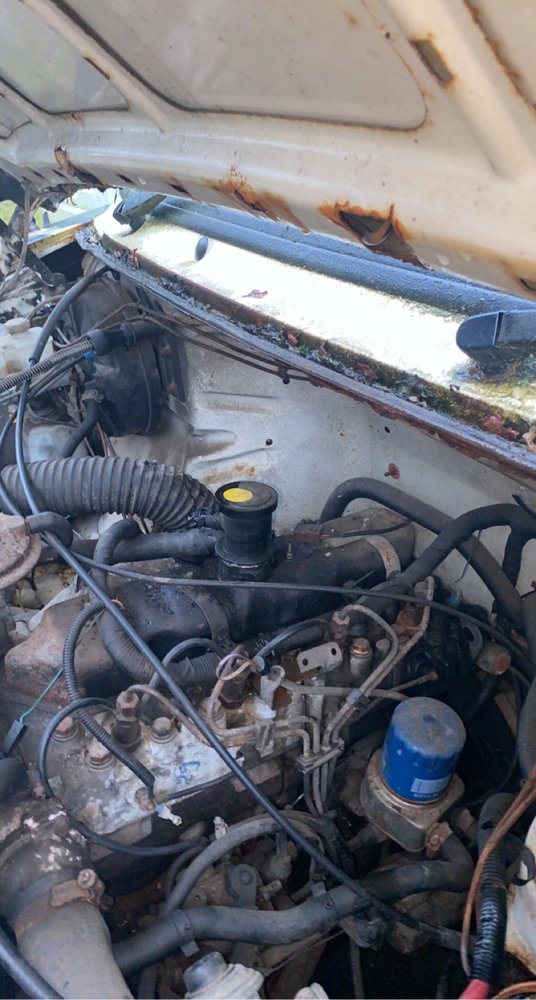

Well after a bit of digging and 3 pages on google. Found a ldv parts age which had a database of most vans registration etc. According to this it’s got a EN55 (non turbo’d version of the two) pug engine. Which fingers crossed is good news
Slower then a old massy with a 30k box? Even if it is slower, least I can park it outside work without the boss getting annoyed heheThat's gonna redefine your understanding of the word "slow"...
Probably the word "gutless" too...

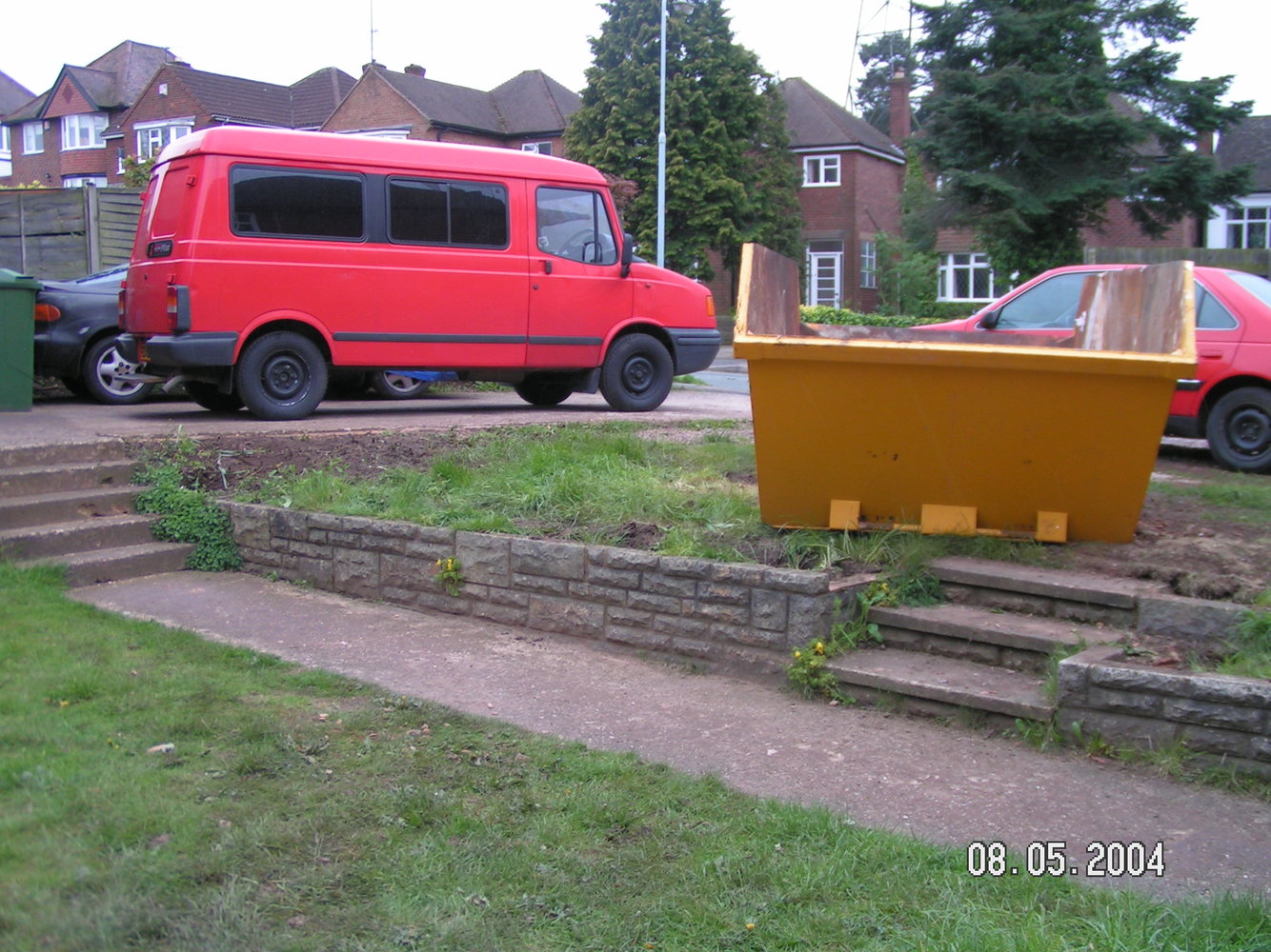

just a updated Leyland Sherpa change the grill fit round headlamps and there you have it for the front back doors and lights are differentJust found this pic of my old ex post office LDV i something could easily be done with the front wings bonnet and grill to make it look like a 1960's van as i think it was just an updated Morris or Leyland design.
The convertible yellow Skoda also looks quite solid in the foreground and i used to chuck all sorts in it
I think i was going on the look of the Morris J4 Commercial vansjust a updated Leyland Sherpa change the grill fit round headlamps and there you have it for the front back doors and lights are different
engine was a 1.8 petrol old MGB type motor B series or the diesel was land rover diesel (old 2.25one) i think not sure on the diesel
