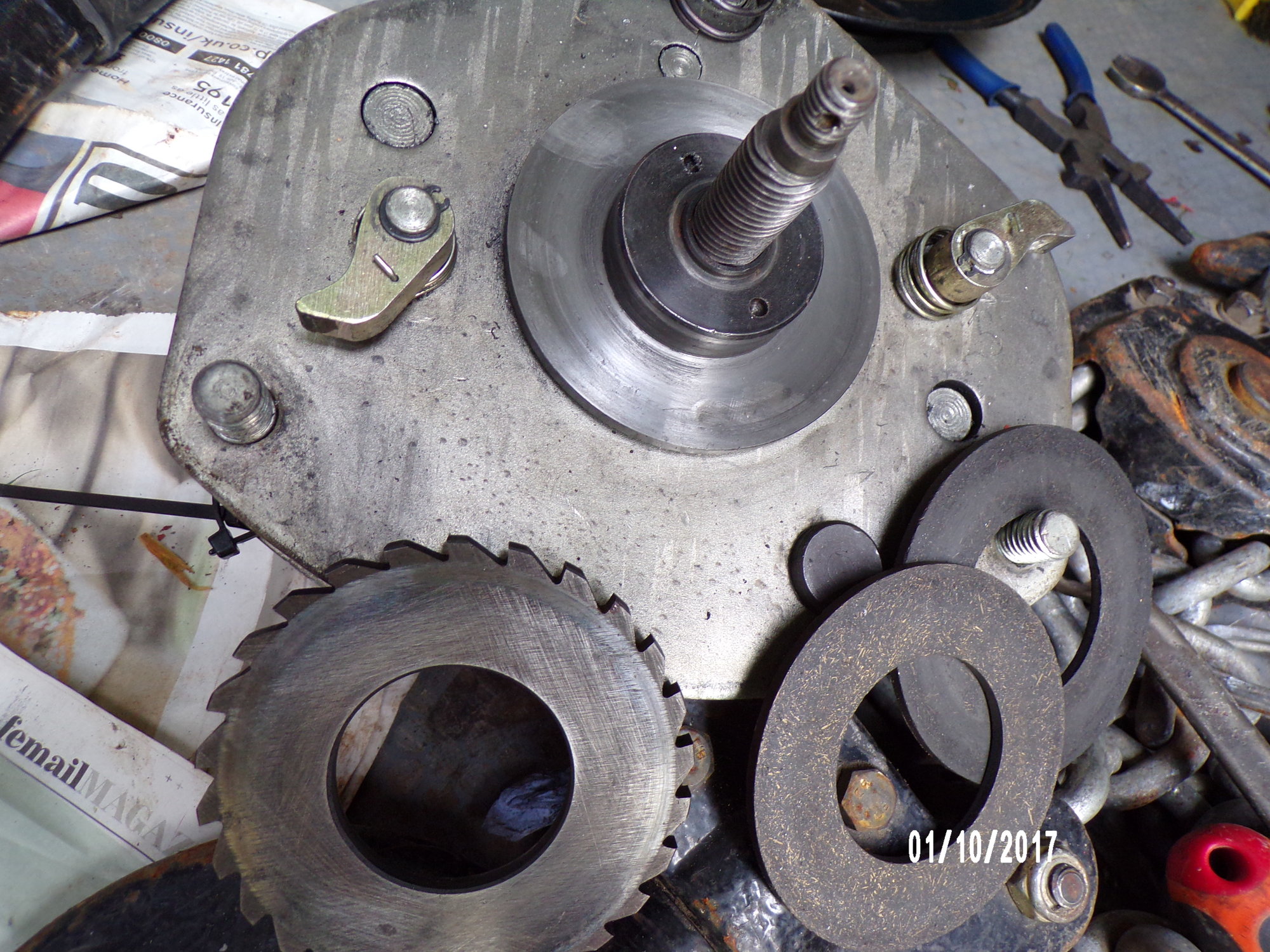

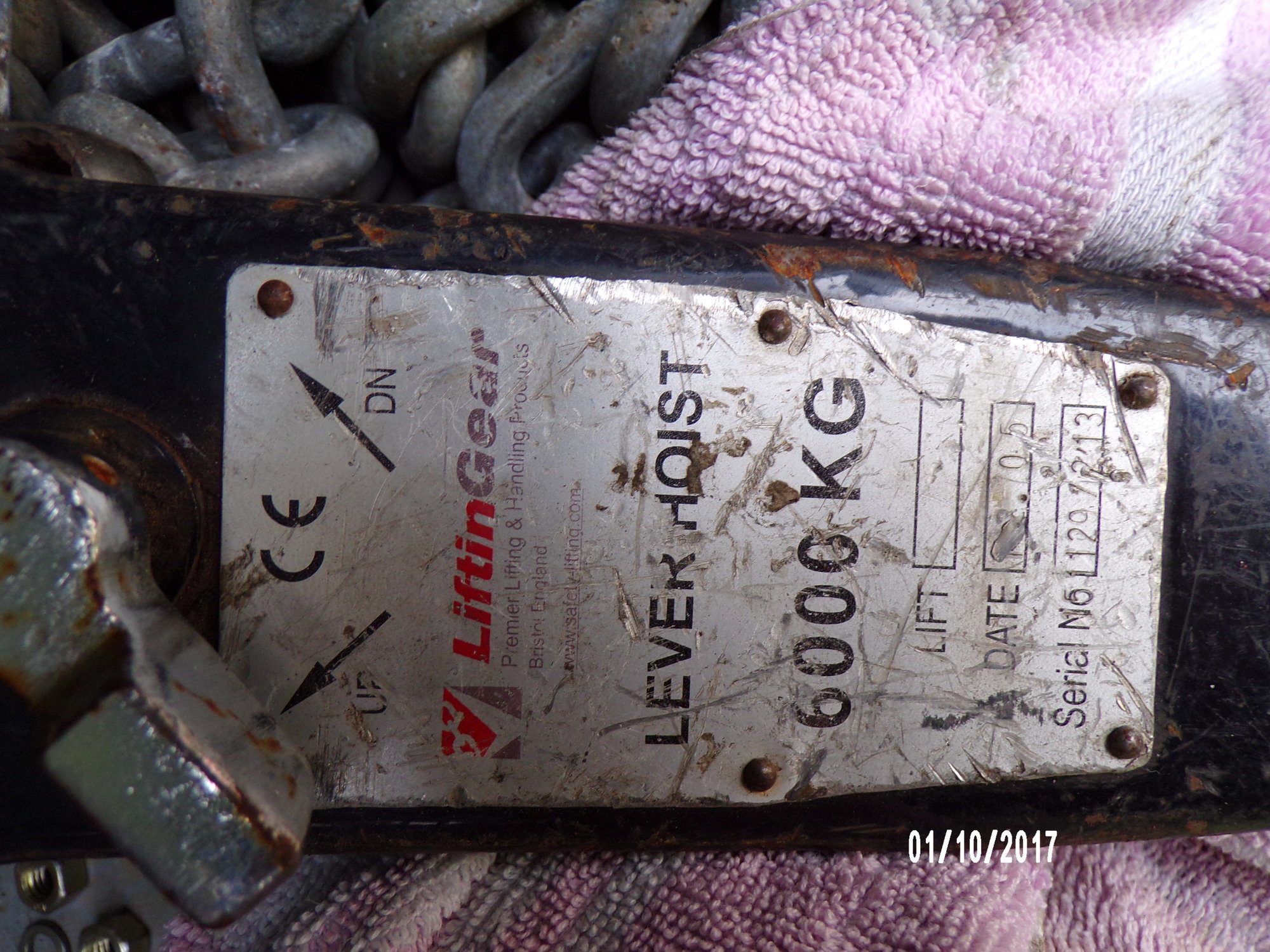

I have just got a 6 ton lever hoist. The plait on the handle has LiftinGear which i thought was the make but carnt fined anything about it.
when you wined the handle in the upwards setting the chain will lift but then on the back stroke goes back down again. Just the same as a cheep Chinese one i bought from ebay one time.

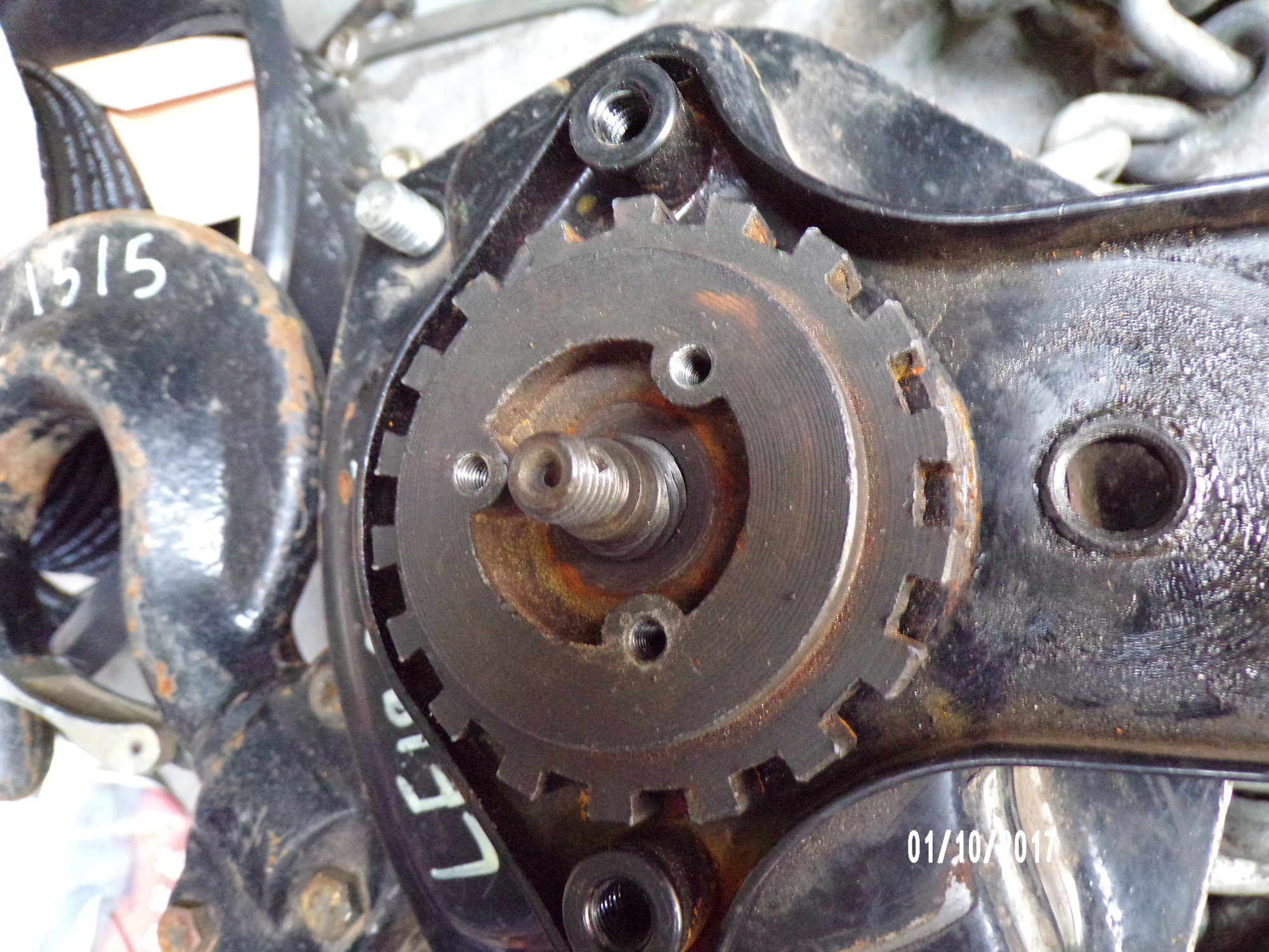

I have taken it apart. The pinion shaft is smooth spinning in the gear box. what looks to be happening is the ratchet part of the handle (possible called the change gear) tightens down on the pinion shaft putting pressure on the friction plates but then on the back stroke release instantly freeing up the friction plates again. I carnt see why this is happening.
Both friction plates are 3mm and the drive ratchet gear is 5mm.
Any advice on whats happening and wear to buy parts would be appreciated.
