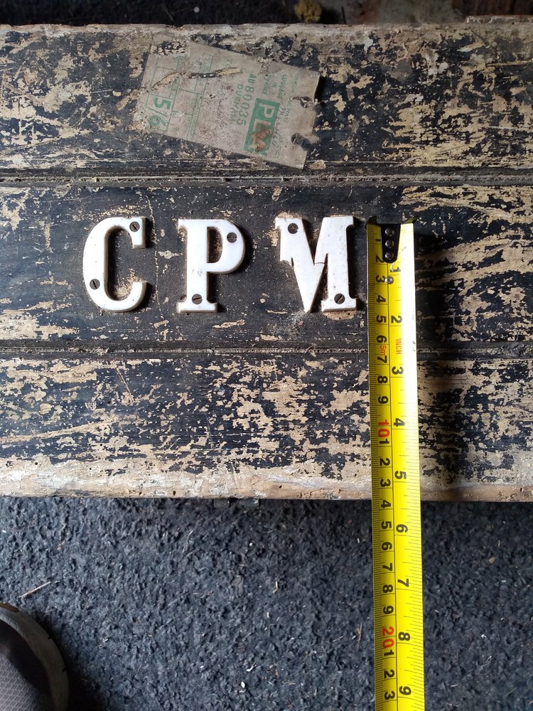

I need to print some 2" screw on letters. The kind you used to buy from your local hardware store. I've looked on thingiverse and cant find any. Could someone point me in the right direction. Thanks/

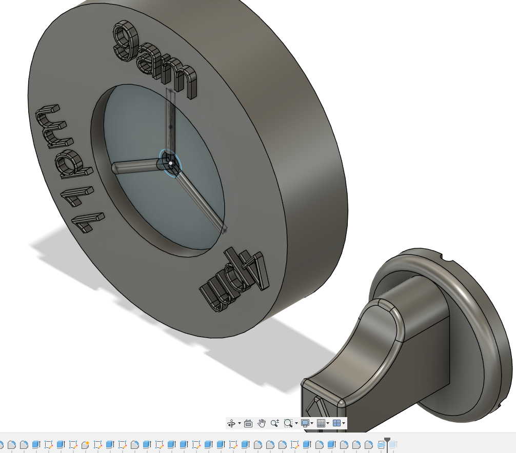

Very easy in fusion 360 or similar. How are you with CAD?I need to print some 2" screw on letters. The kind you used to buy from your local hardware store. I've looked on thingiverse and cant find any. Could someone point me in the right direction. Thanks/

Thanks for that. I'll give OpenSCAD a try.Maybe one of these would do the trick:

This OpenSCAD will make a letter of any height and thickness out of any font on your computer:
// In OpenSCAD, choose Help, Font List from the menu //
// to see what fonts are available to you. Substitute //
// the name of the font you require below //
font = "Wingdings";
// Type the letter you want below //
letter = "M";
// change the font size here//
size = 100;
// set letter thickness here //
thickness = 10;
// Please do not touch anything below this line //
linear_extrude(thickness){
text(letter, size, font, halign="center", valign="center");
// script ends //
