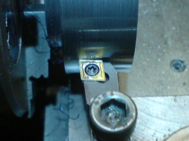

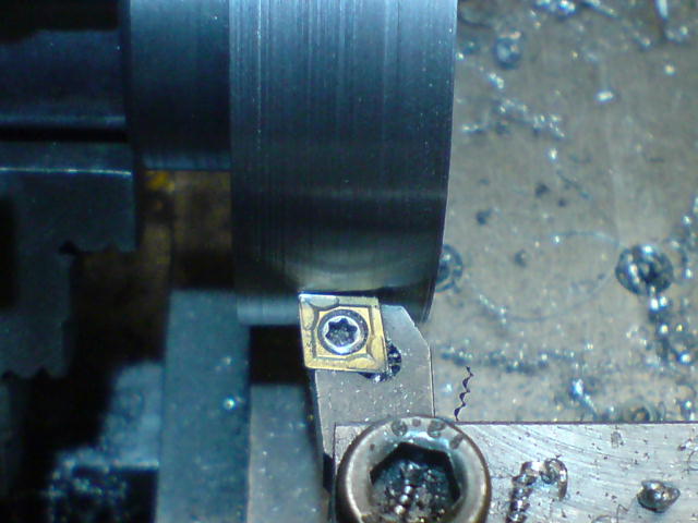

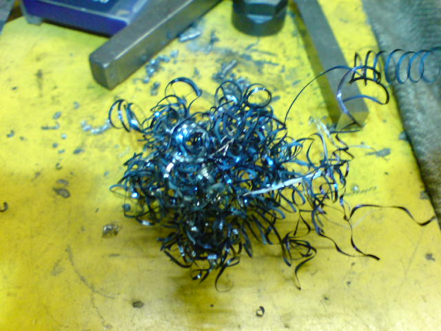

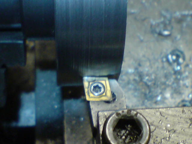

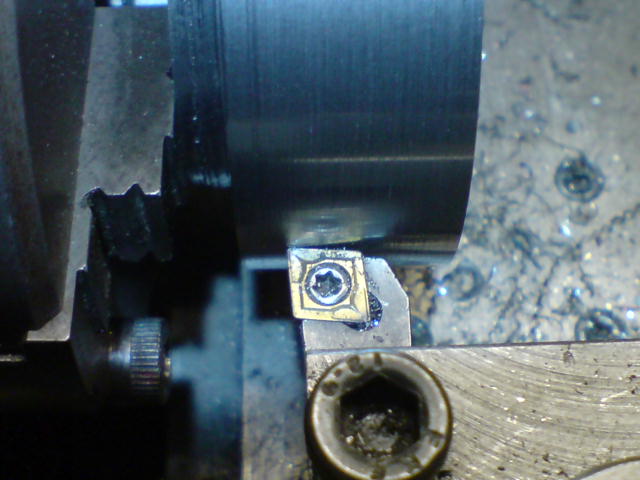

Used the CNMG 120408's today on some F51 and also 316 and they did fine. Didn't break the swarf on light skims on the 316 but that is normal really for most inserts, on heavier cuts they did. Can't really say how they will last as I didn't do a lot of cutting but they seem fine so far. I have used drills and taps from YG-1 and they have proved to be very good so hopefully the inserts will be on a par with them.in the interest of this thread I've just ordered half a dozen inserts CCMT060204 inserts....... I'll let you know how I get on with them
