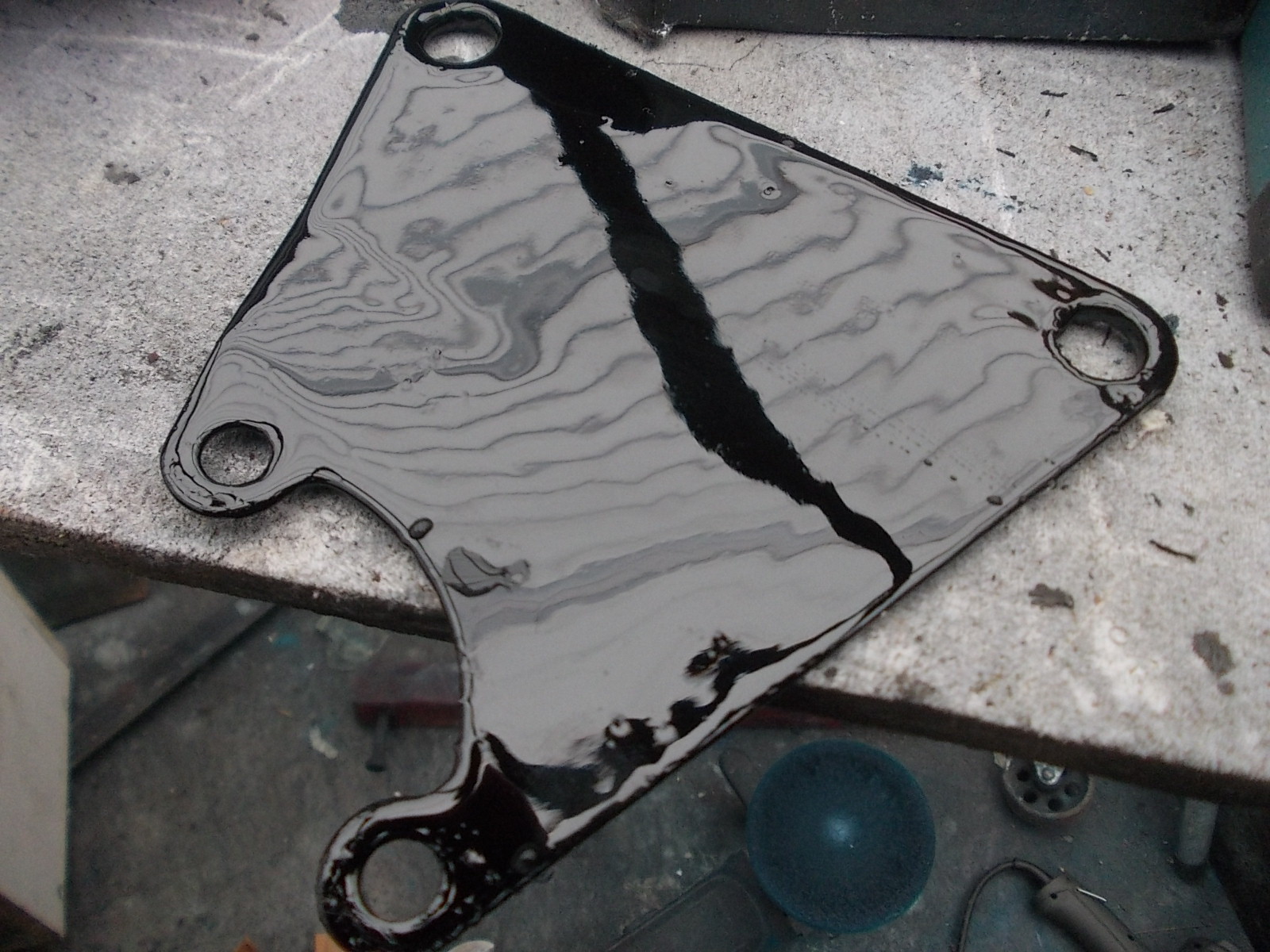

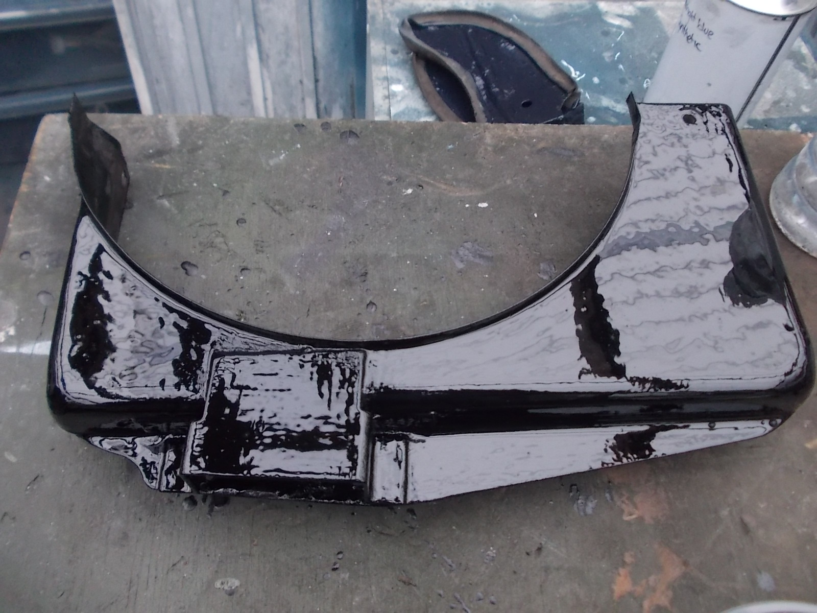

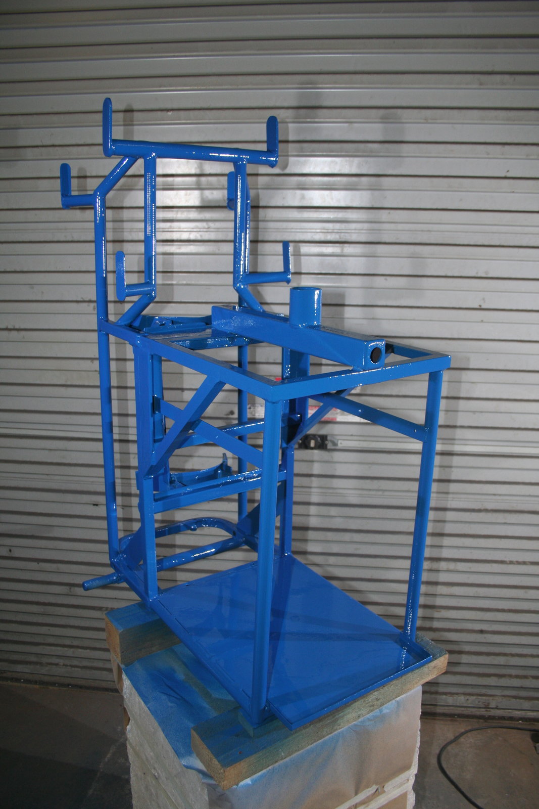

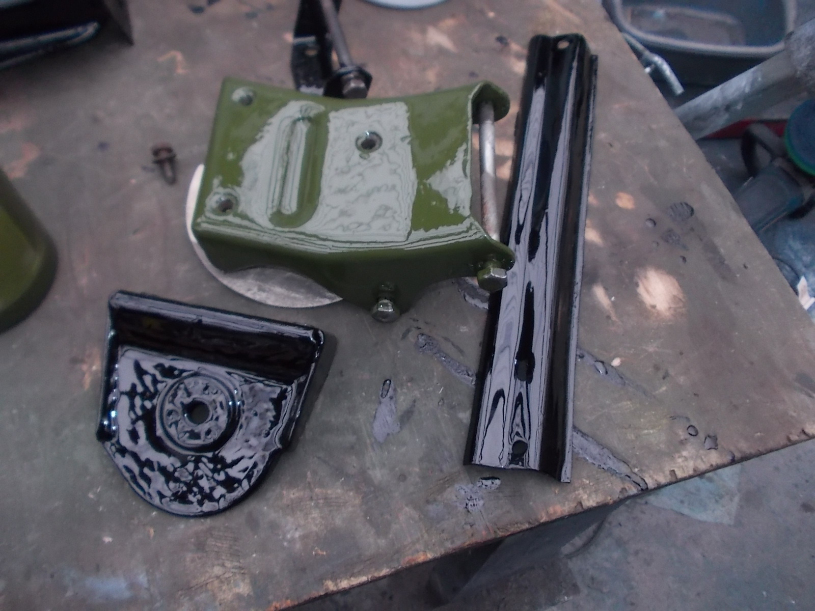

Looks good Dcal what did you use for topcoat ?
PPG Deltafleet in Ford Tractor Blue
Devilbiss SRi gun with a 1mm fluid tip

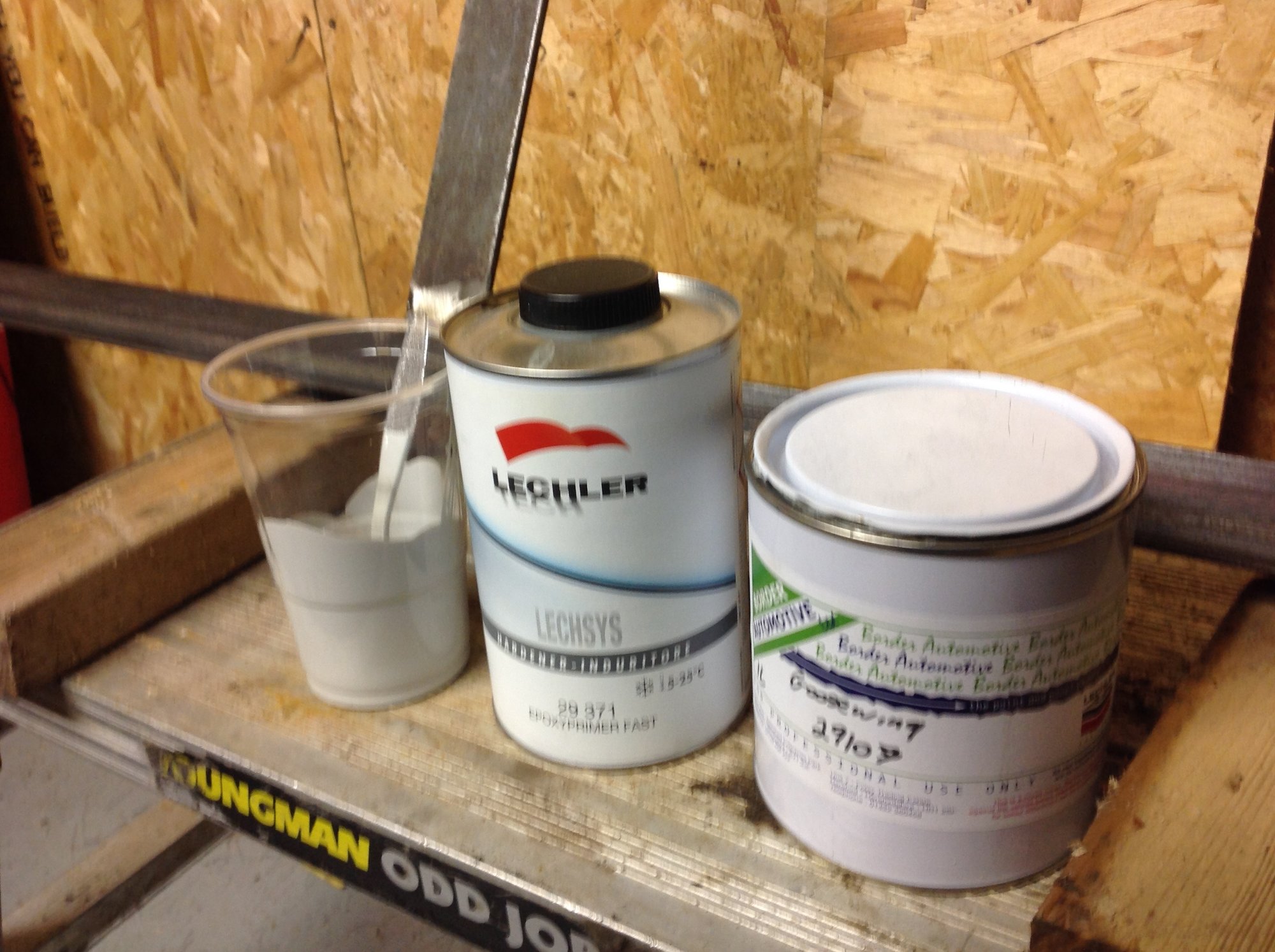

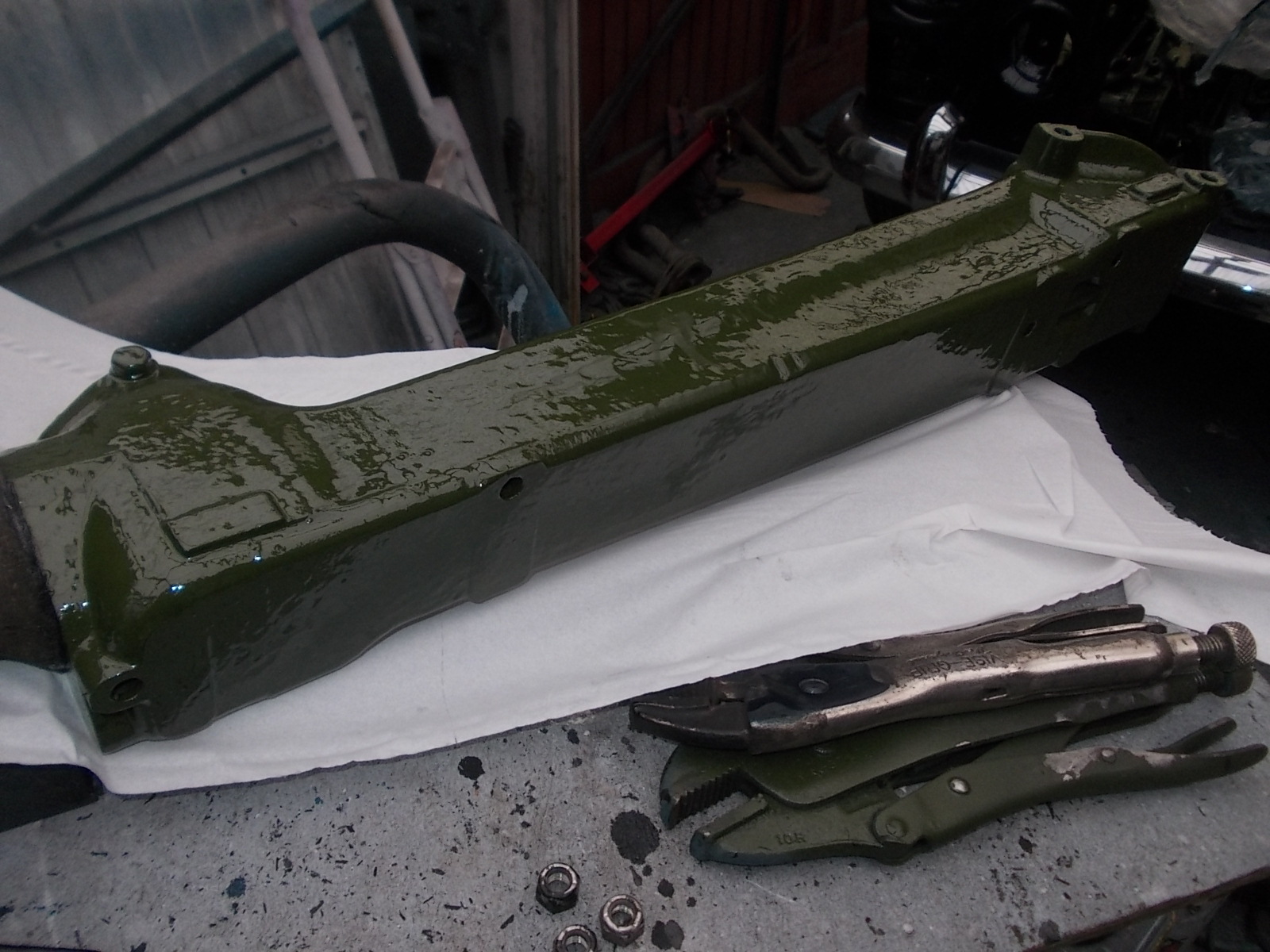

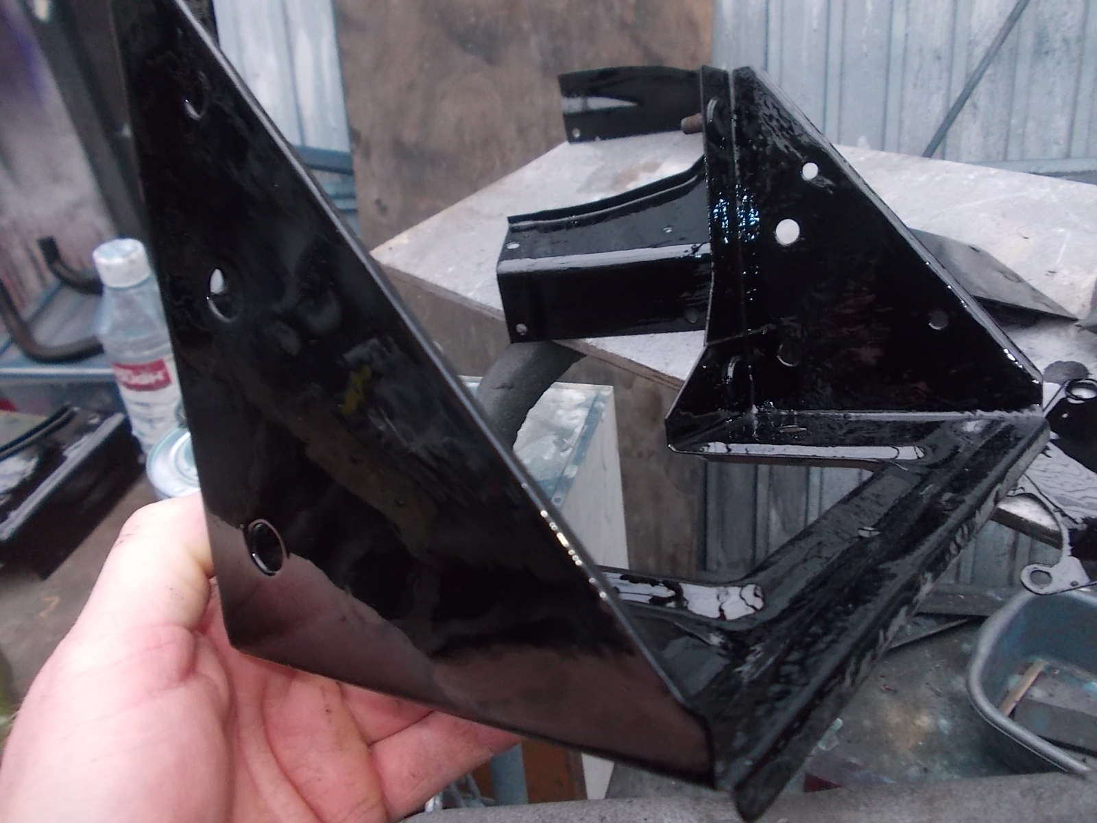

sorry for late reply. just a splash of thinners. i used to buy the special lechler thinner (00516 i think) but after reading on here that pro's were just using normal 2k thinner i've used that ever since and never had any problemsReally nice job.
Did you thin the paint after mixing with the hardener?

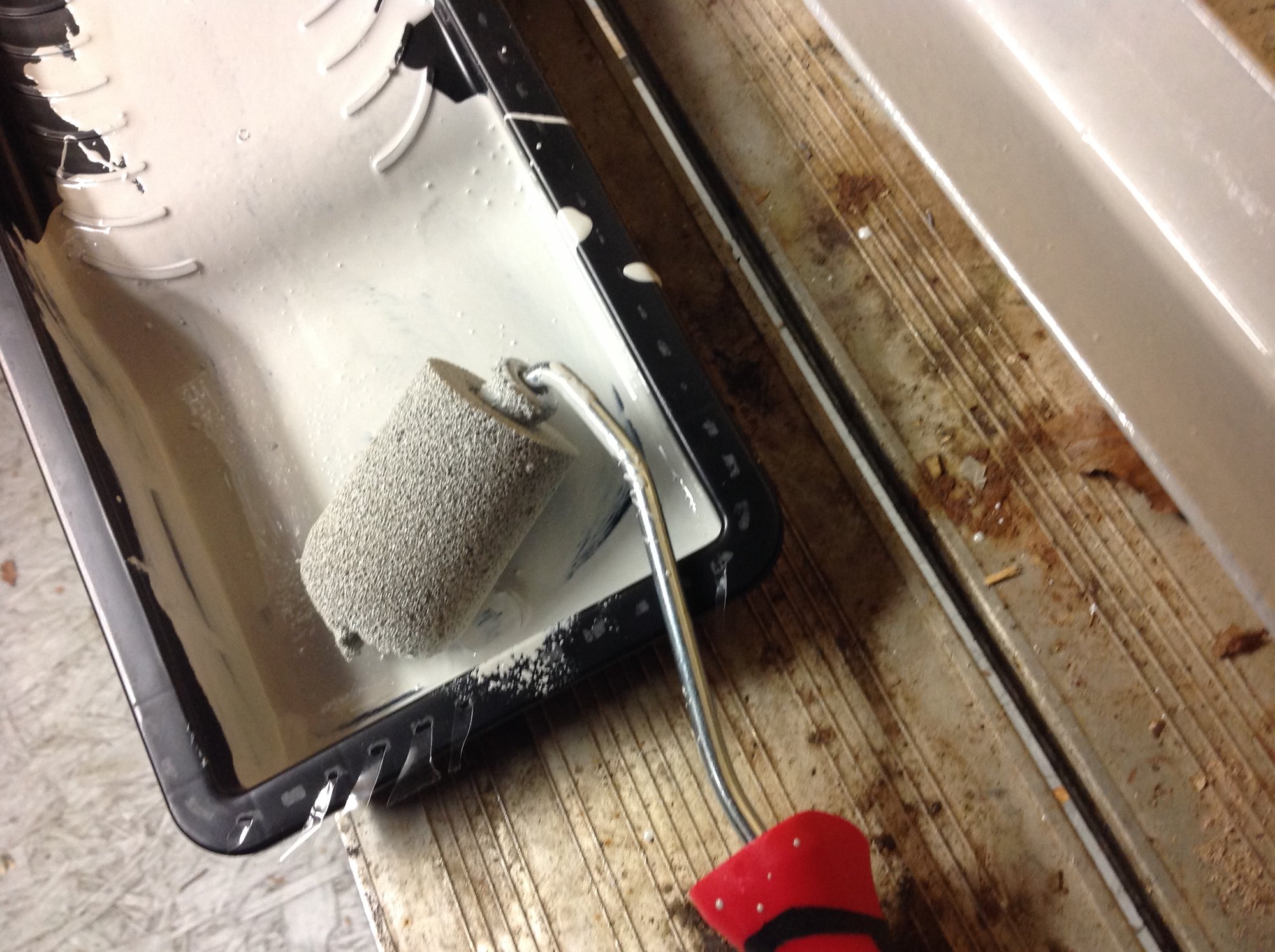

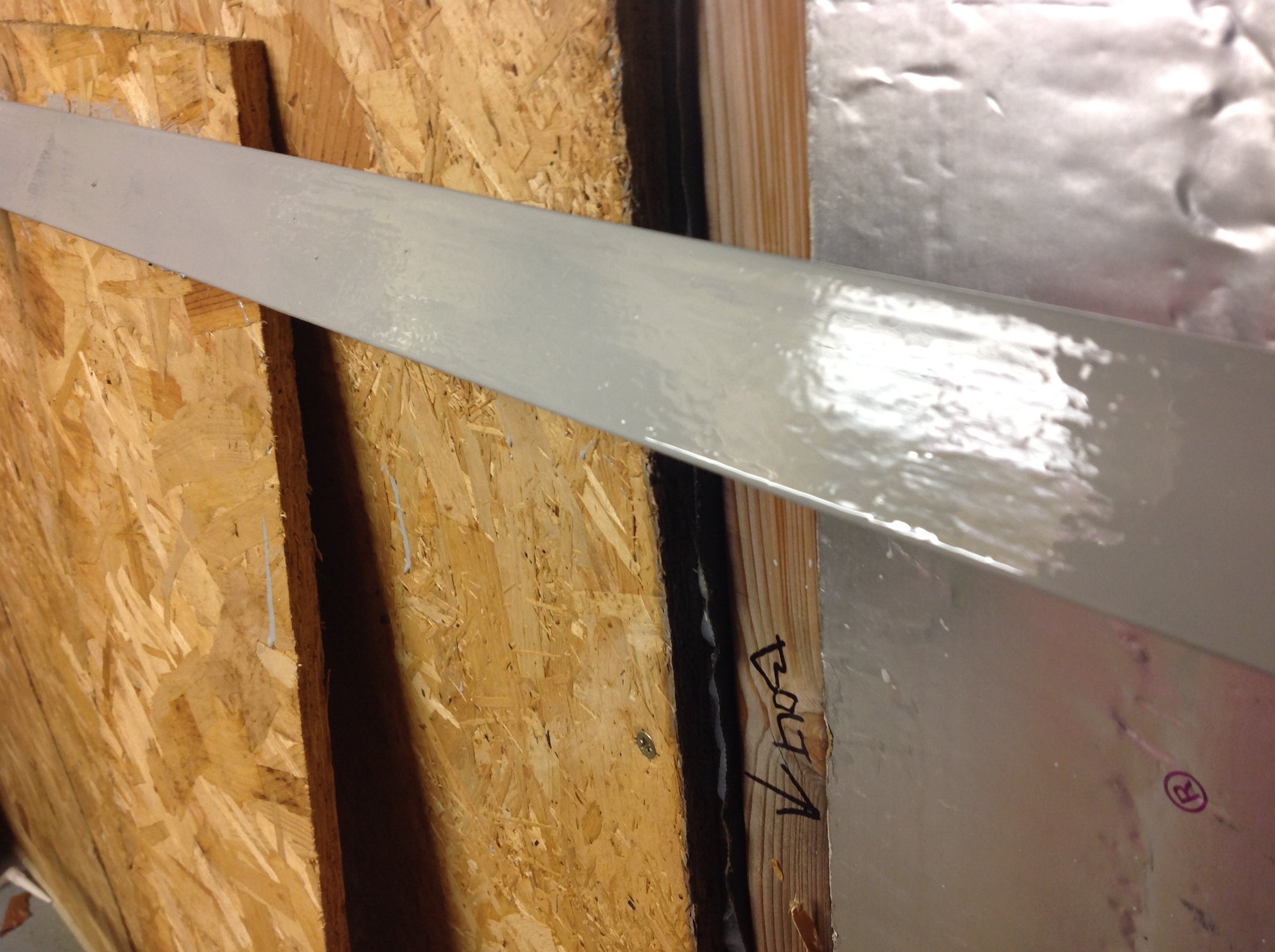

I've never tried brushing 2 K but with results like that it would be a well worth doing.
i use mipa 2k gloss black from ebay. nice and thick before thinning. i used clostermann before and that was like water in comparisonWhat topcoat did you use ,I didn't think u could brush 2k (apart from epoxy ) ??? I know very little about paint tho !

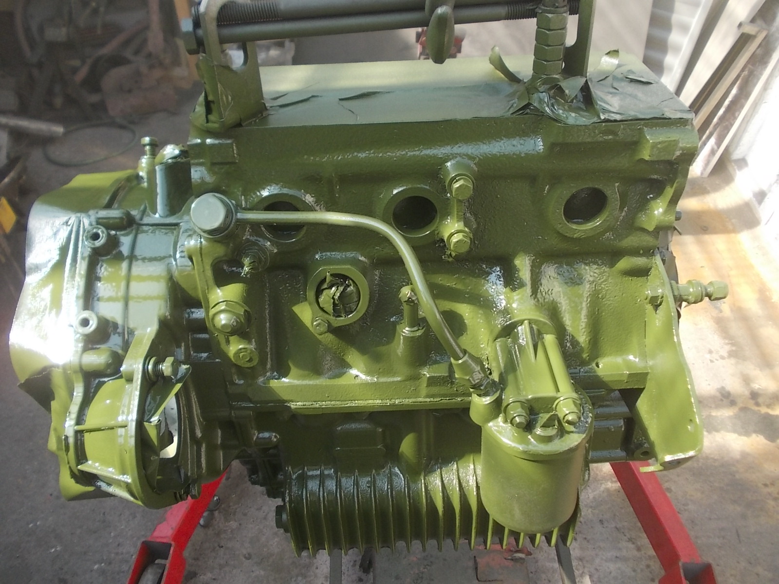

Ooo, mini bits!
They never looked like that from the factory, one coat should have done it?
close relative but not mini. 1972 vanden plas 1300 this engine came from a scrap 1968 mg 1300 i bought 12 years ago from ebay it has the sought after 11 stud 70hp engine similar to the original cooper s
