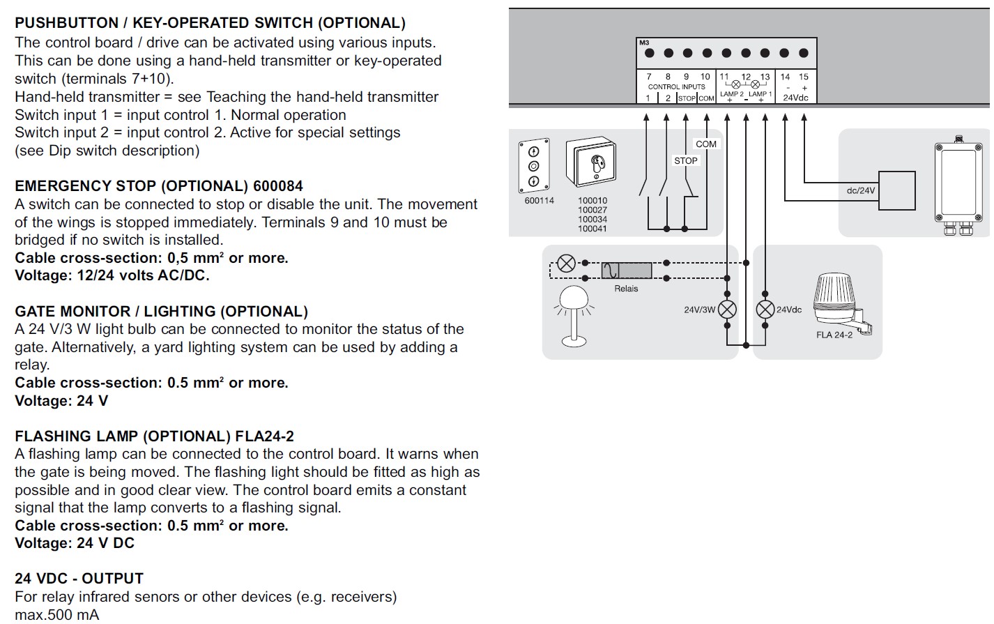

FINALLY got my leccy gates working. Well the gate side on permanent power. Need to sort the low down brick lights and inside the gate, downlights, both that'll be on for just a short period whilst we park.
Italian kit, the manual throws some curve balls imo.

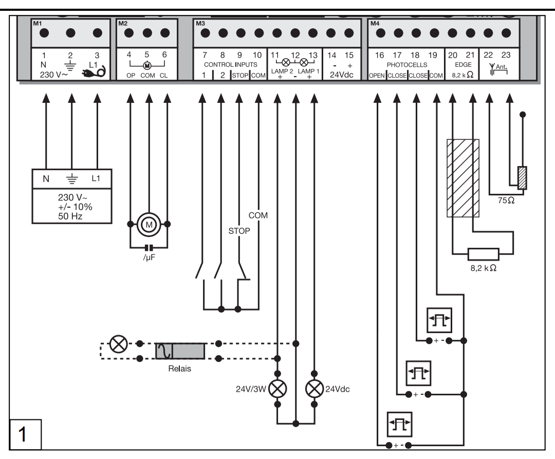

When the gate opens/ closes and only then, you get 24VAC on 11/12 and 24VDC on 12/13. As in 12 is common. I find that very odd, mixing AC and DC like that.
Or so the manual says...it's more like 18V on both. Hey ho. I've an amber flashing beacon on 12/13. Works fine.
So the gate trundles open, the beacon flashing, then stops and waits (for an adjustable time), before closing . Whilst stopped there's no voltage on 11/12 or 12/13.
Gate then closes and I get 24VAC output on 11/12 and 24VDC on 12/13. Gate shuts, outputs cease. Zero volts on 11/12 & 12/13.
What I want is as it opens, for a timer to come on and wait a predetermined time before switching off. As in the timer will keep a relay on for say 5 mins whilst you unload the car.

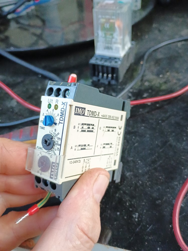

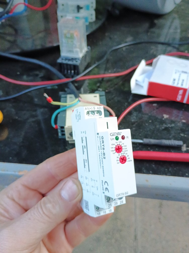

I've an old, salvaged IMO timer and a newer GEYA one.
I assume, with the GEYA I can supply it with a permanent 24VDC via 14/15 which is on all the time. I'm further assuming I can "signal" the relay via "S" with 24VDC from 13?
So trying to figure how it'll work. Gate opens, signals S, timer starts. Gate waits, timer still on according to how I set it up. Gate closes, timer still on. I wonder if every "S" trigger starts the timer again?
