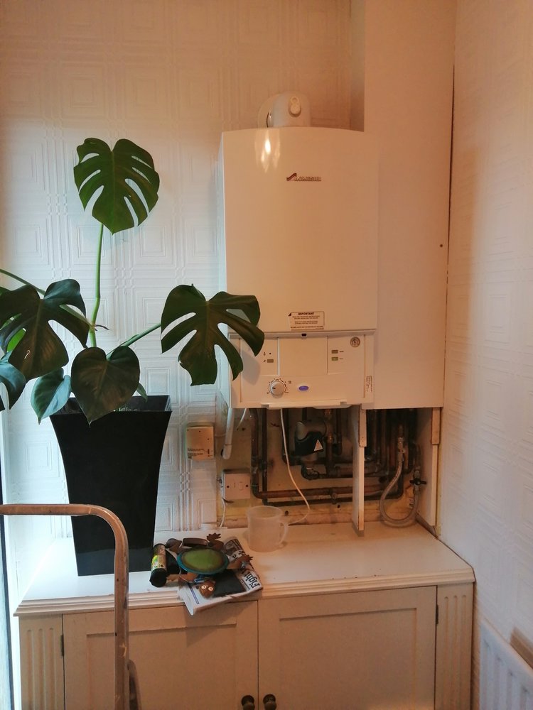

You need to size the pressure vessel to the size of your system, it might be easier just to replace the one thats in there if you can, i did it on one of my previous boilers , no need to touch the gas part. if not an external tank , just tee it in close to the boiler. it must be pressurised disconnected from the system, and set just under the pressure you want to run at, so as the pressure increases it absorbs the increase , if the tank is to small the pressure can still rise. also worth checking the fill valves, they can leak causing pressure over time.
a bank loan if its a plumberWere you thinking of DIY or getting a plumber out?
on that it would be either above the flue and tee in on the pipesWhat would I be looking roughly at for a new vessel, easy access on this?
Can't do it myself as the vessel is goosed, so apparently the boiler has to come off so it's a gas safe guy /gal.Were you thinking of DIY or getting a plumber out?
Bryan - everyone has said to leave the knackered one in place and fit a new one elsewhere on the system. Taking the boiler off risks breaking other parts and is a longer job anyway.Can't do it myself as the vessel is goosed, so apparently the boiler has to come off so it's a gas safe guy /gal.
My DIY / plumber question was related to your post #44 which I presume was asking about the rough cost of an external vessel?Were you thinking of DIY or getting a plumber out?
No sorry I meant fitting a new external vessel on this? Leaving the old one in.Honestly, given the risk of damaging the many plastic parts inside that boiler, i'd be looking £600 plus a disclaimer that it will be more if one of the hydroblocks fails during removal or refitting

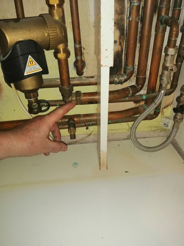

I just turned the boiler on and waited to see which on got hot on the way back, it was the one I'm pointing to so I assumed it was the return.hello would say the one next to it with the bleed point and the flexi pipe tp pressurise the system was the return and what your pointing should be the flow however the vaillant dirt collector is normally fitted on the return pipe so i guess return pipe sjould be cooler
