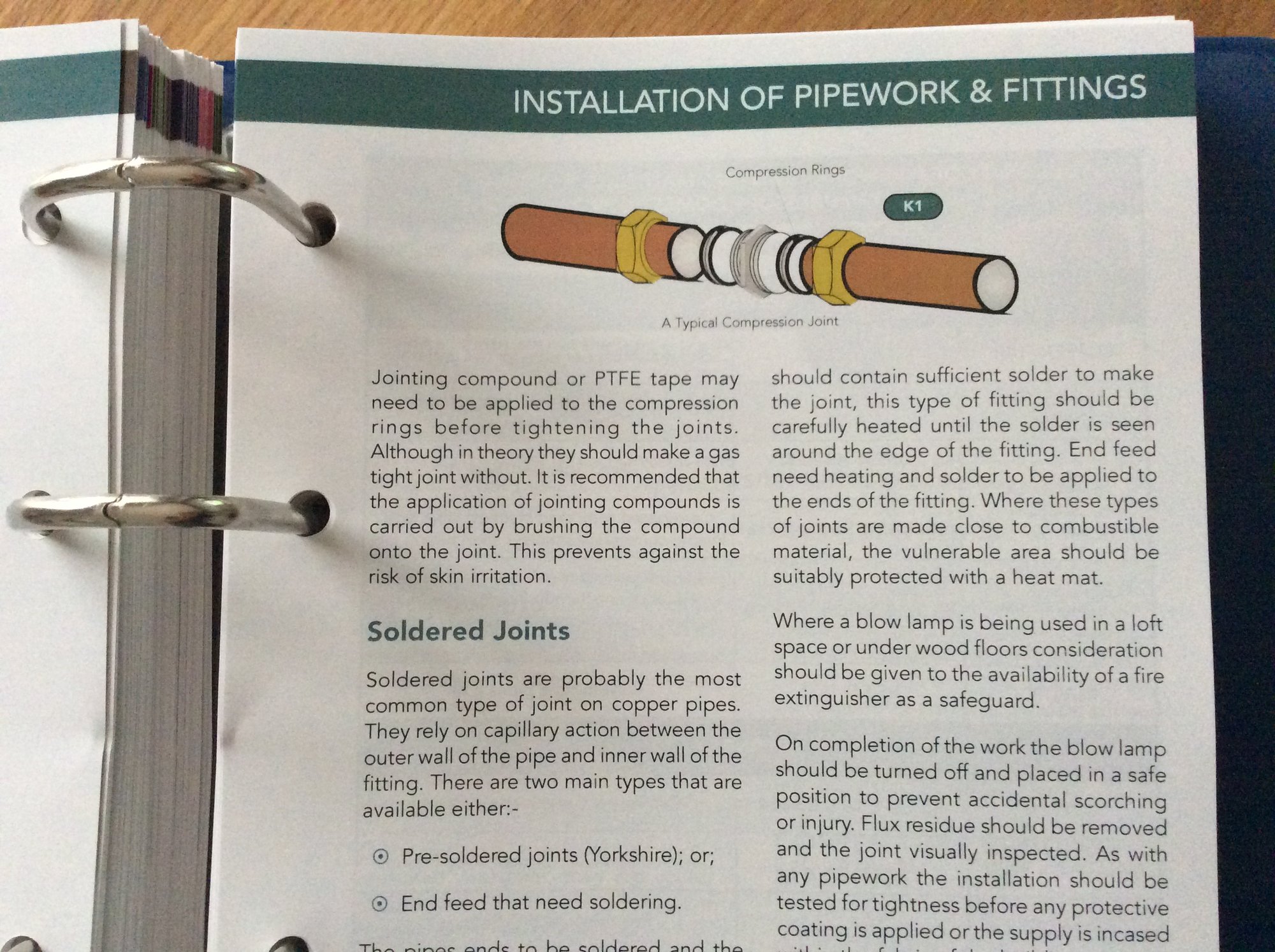

I'd recommend the o/p uses Yorkshire fittings (solder ring'))if They are a novice , much easier to get to grips with . Have solder ready too just as a 'top up ' when you see the solder appear from the fitting . Oh heat. The pipe not the fitting as well. I use a smear of jointing compound over the olives on compression fittings , just helps lubricate things and gets a goood seal in my mind .
