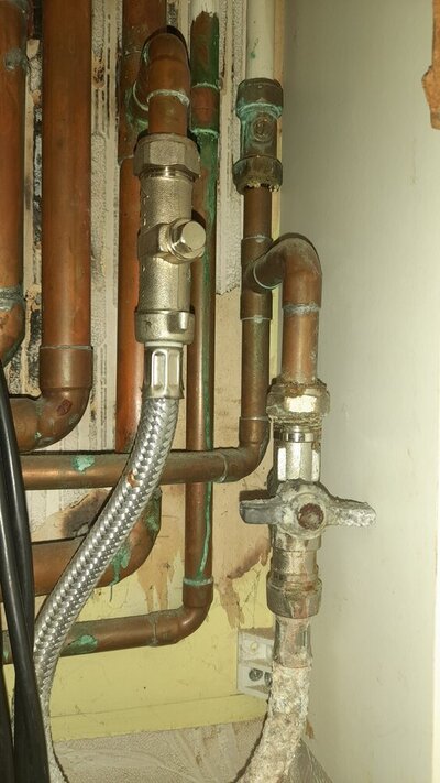

It's weeping from the plastic knob,there's some corrosion on the nut above but that's dry .
There's an isolation valve above the loop but non past the other end of the loop ,I'm not sure what the small nut head is on the body of the left side joint but I'm guessing it's not an isolation valve.
If I shut the isolation valve above the leaking righthand side and shut off the mains stopcock am I going to get wet if I try to remove the loop to replace it?
Cheers.
