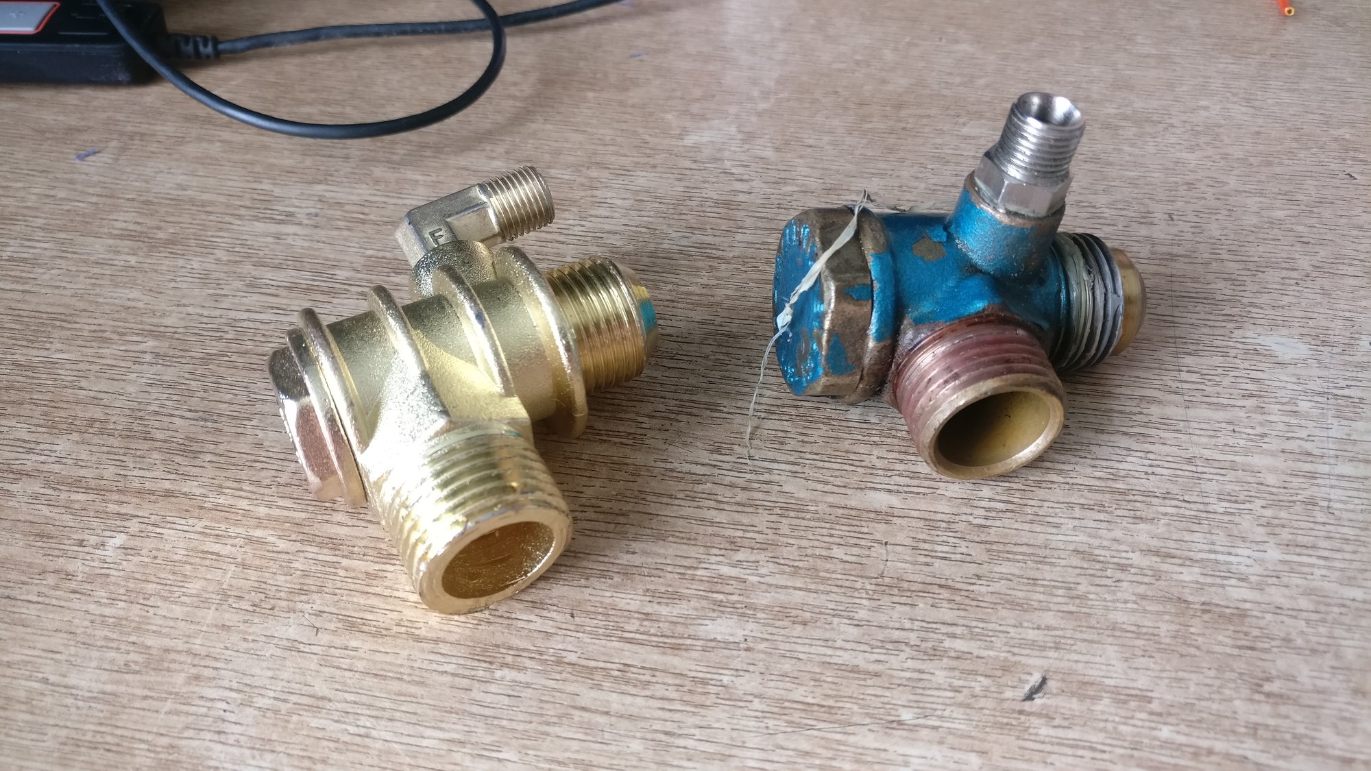

I think my check valve started leaking as air was continuisly coming out of the pressure release hose that goes from the check valve to the pressure switch. I've bought a new valve, but the new one also lets air pass when I blow into it in the backwards direction. Have I just bought a crummy replacement or is there something more going on?
