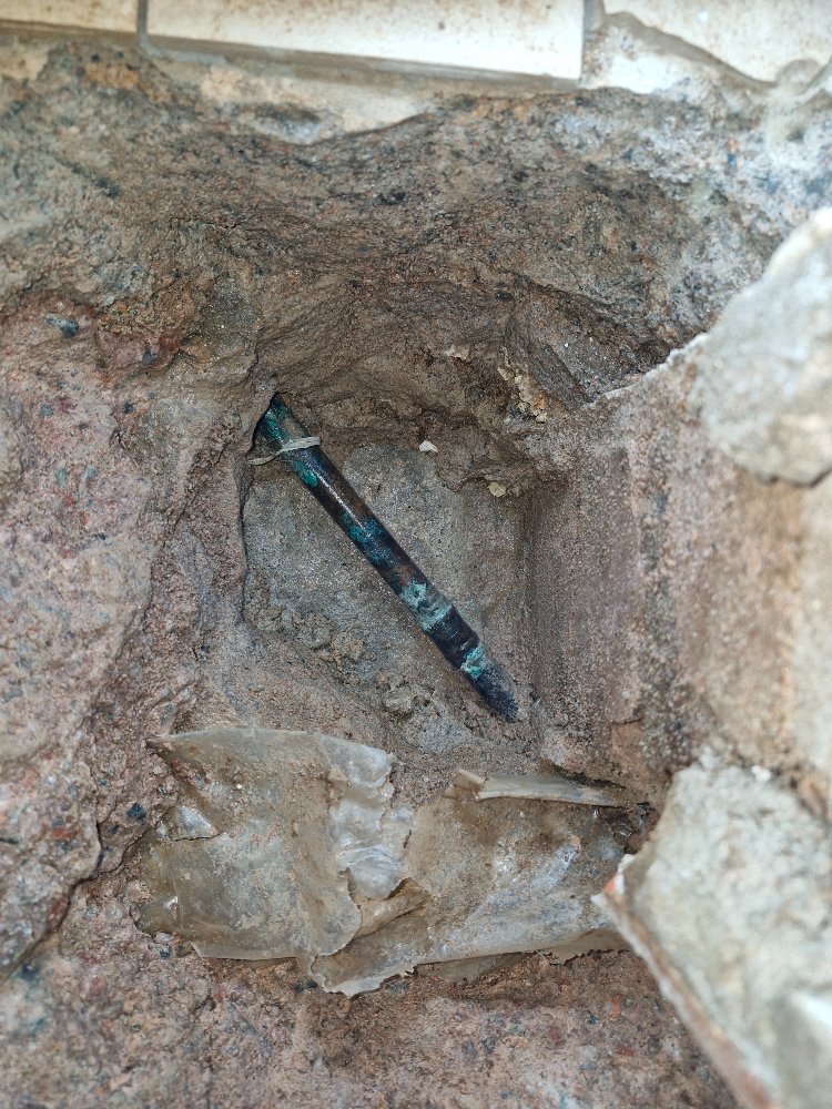

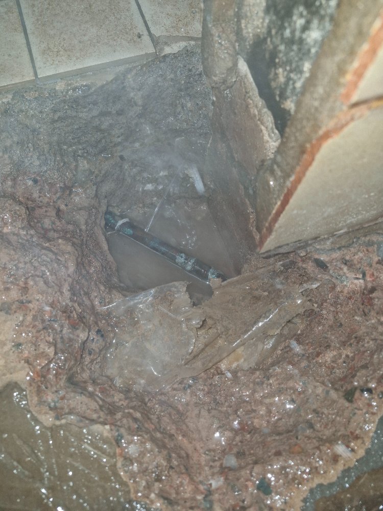

Was late home from work but broke out the kango and found the pipe then the leak:
The pipe is direct buried in concrete

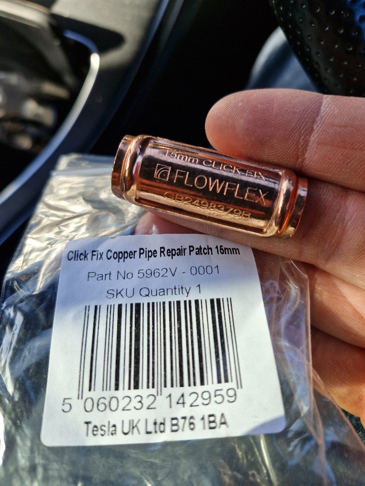

I am going to pick up a 15mm solder on cap repair tomorrow and have a go. Whats the worst can happen. I can suck the water out with wet vac and pre heat before soldering..
If it doesnt work then im down a whole £5 and I can start breaking out a much larger hole for enough access for compression fittings (x2) + a pipe section.
As this whole lot will end up tumbled within the next 5 - 10 years a patch will do.
