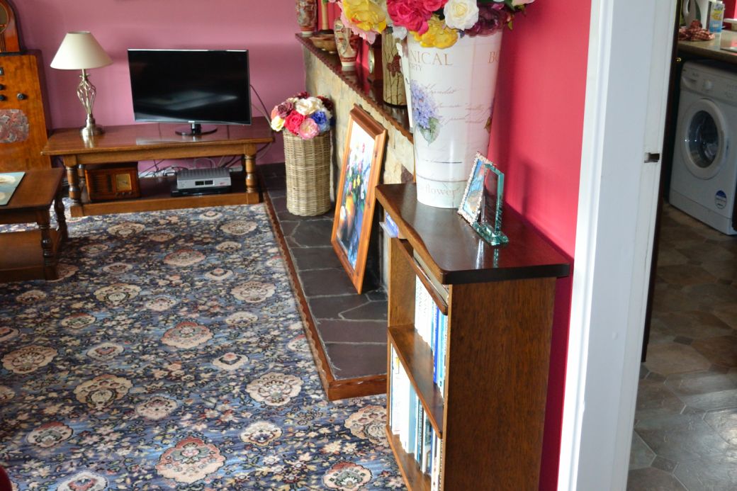

Our front room as it was; I made the bookcase and the three coffee tables two of the tables shown based on Titchmarsh & Goodwin designs.

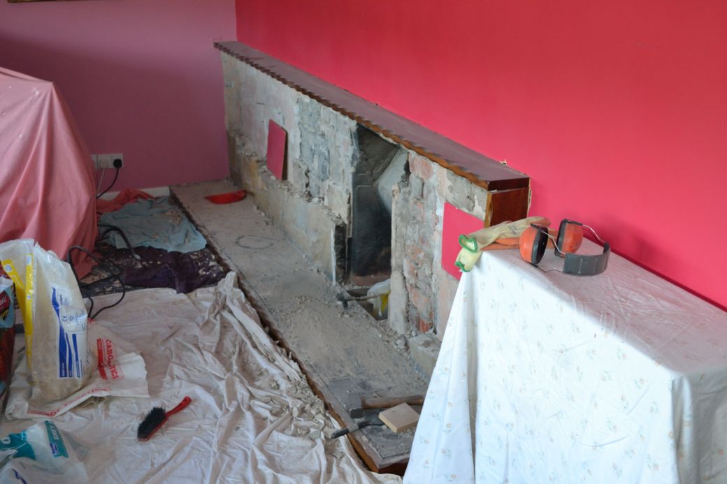

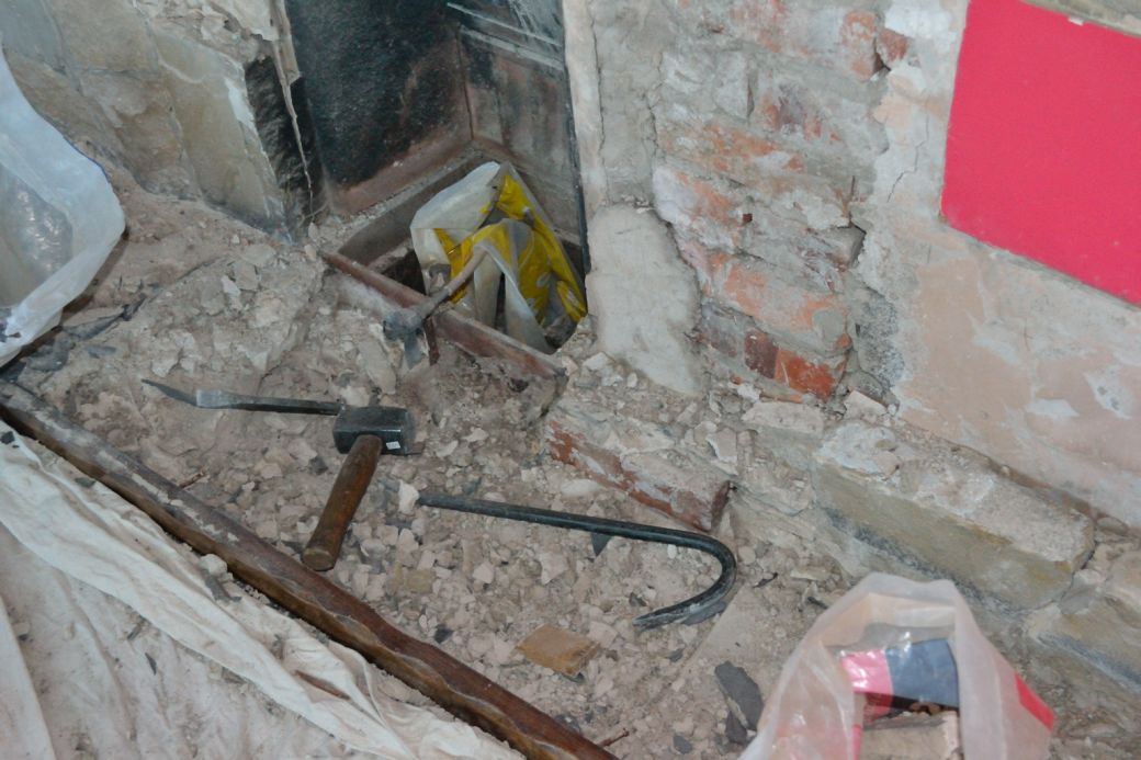

First the demolition; I retained the fireplace facing stones but ran 18 heavy bags of rubble to the local tip; this fireplace was 10' long and solidly built like a fortress.

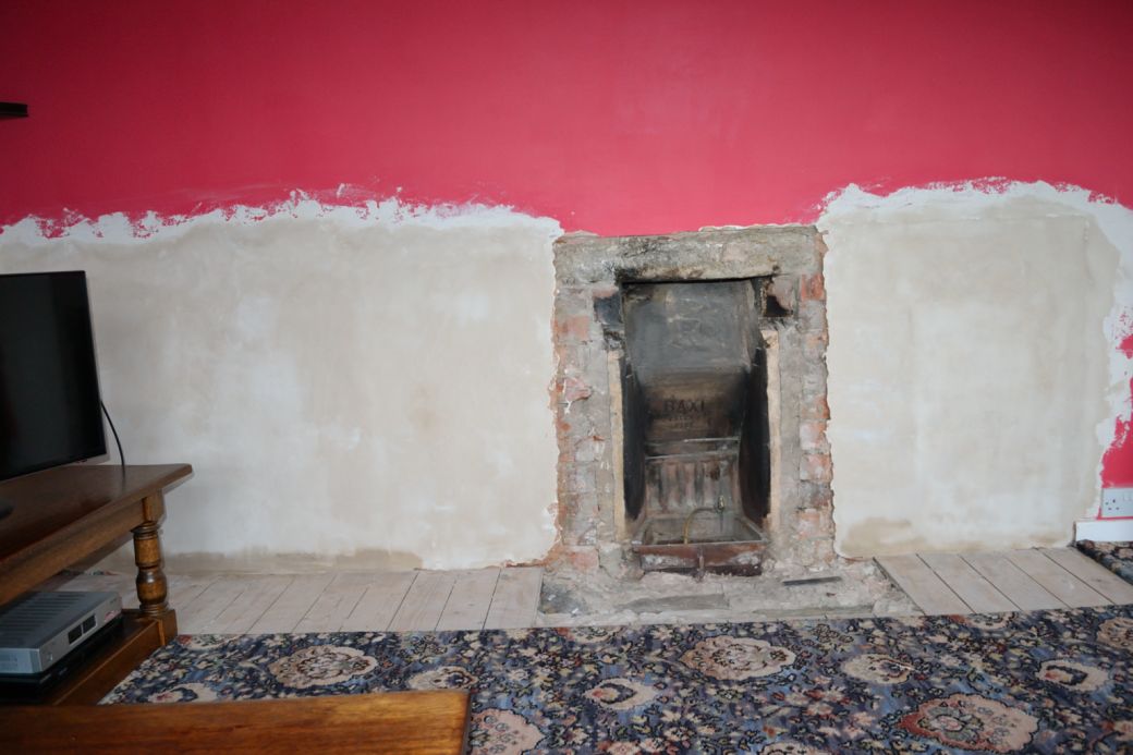

Why call plasters in when I can do the work myself; it took longer but it's a good way of learning new skills.

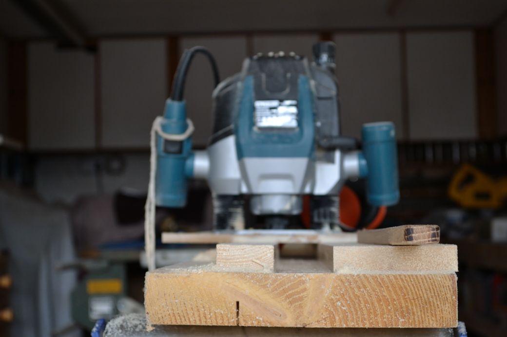

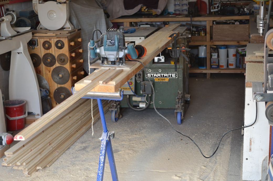

We wanted 300' of frame work for the walls with which to create frame panels and a dado rail.

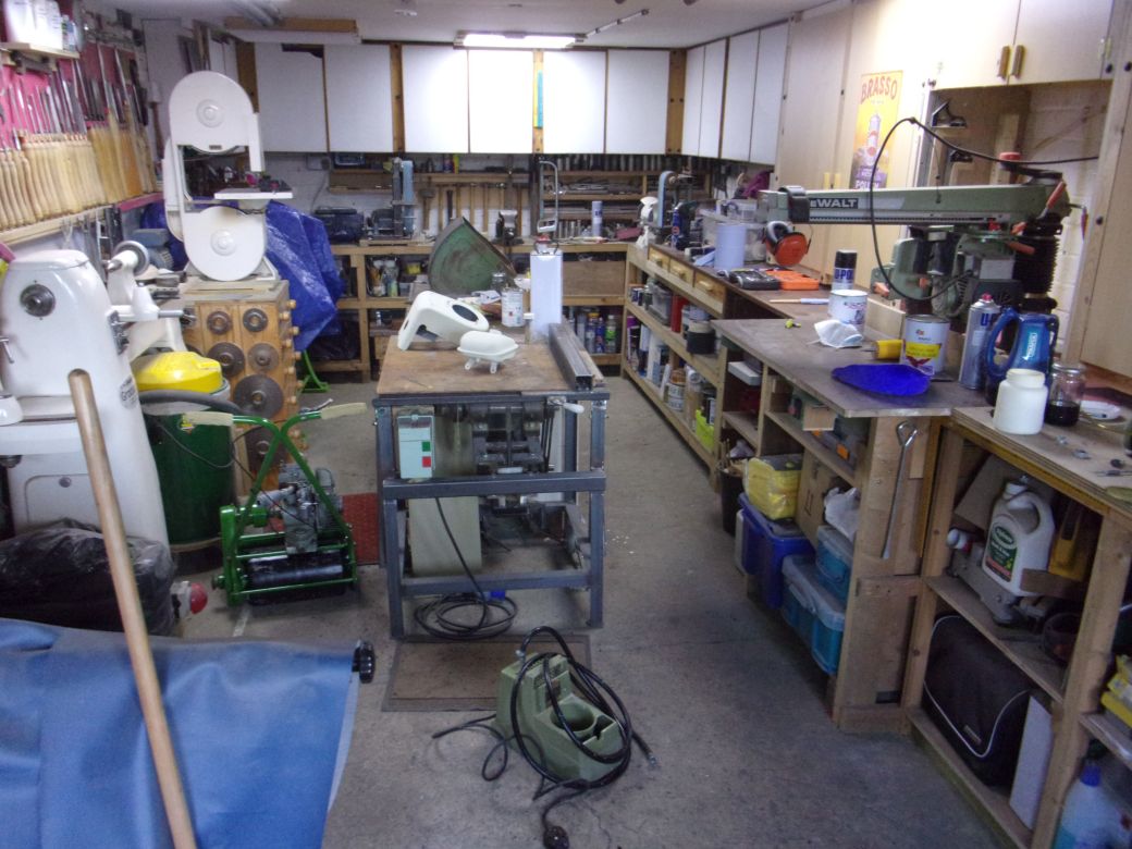

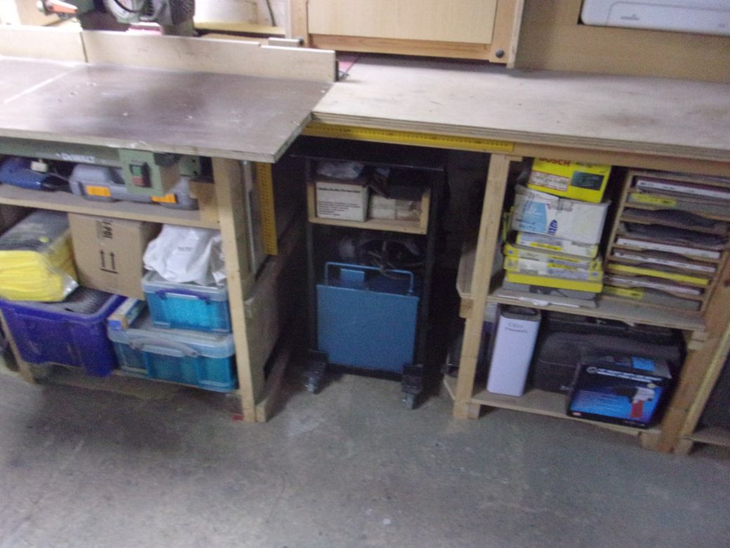

Buying 300' of such moulded timber would be hugely expensive so why not just buy planed softwood and run the mouldings ourselves; the softwood for the frames was 2" x 1" and for the dado rail 3" x 1" I rigged up a routing jig as shown forming a tunnel just to kiss the sides of the timber; the router switch was tied with string to be permanently switch on then I could control the router from a 13A wall socket; the cutter was 1/2" dia Roman Ogee; the timber was fed through in full lengths and as both edges were to be moulded this meant 600' in total of moulding; it worked like a dream as was surprising quick. The frame corner joints were mitred half laps secured with strong woodworking adhesive; each frame in turn being clamped until the glue set. This involved a lot of joints and frames.

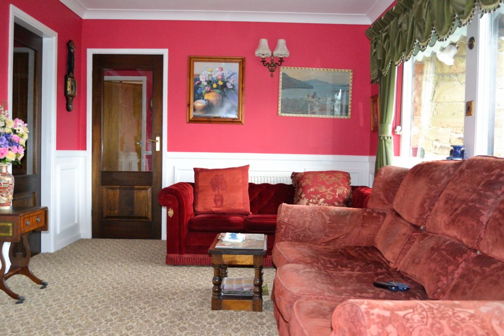

One image of the makeover; the two hardwood doors I made years ago and the third coffee table can now be seen; Bron chose the lovely carpet.

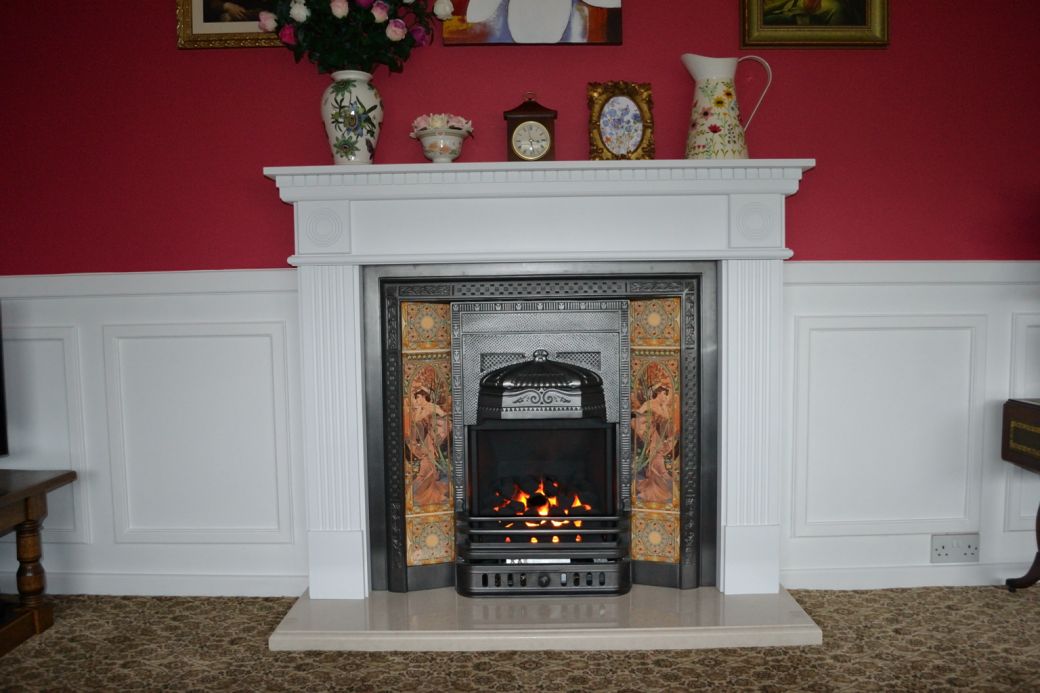

The new gas fire; tiled surround and hearth were professionally installed because of the rules and regulations regarding gas. The two guys spent a full day with us doing the installation and we can't praise Flames of Wakefield enough for their top job. The wooden mantle looks expensive but I used 18mm thick MDF left over from another job; all I needed was a bit more MDF to finish the mantle at £12. I sprayed the mantle in the workshop. I've never made a mantle previously but enjoyed making this one; I took great care to get everything perfect because I was doing this for my Bron who really does deserve the best. Bron has never ever complained about mess or disruption because she knows when I start a job I'll not quit until the job is completed. With the lights out at night and the TV switched on our front room is very cosy with the fire lit.

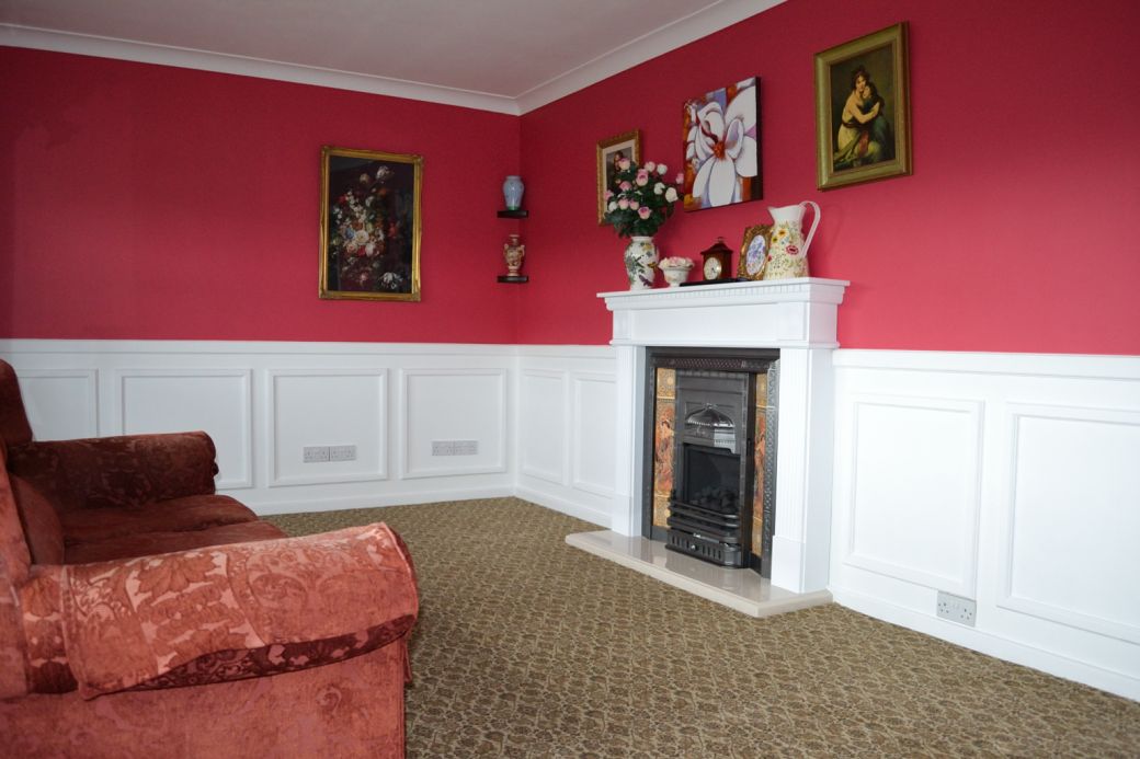

Almost finished here just after the carpet fitters departed; I had also done some rewiring adding additional 13A sockets. The upper colour is Dulux Raspberry Bellini; The transformation was dramatic indeed and it took us quite a time to get used to it but even now we love it; the major cost at £2,400 were the fireplace and carpet; additional cost was just just for softwood and paint etc. Yes it was worth the upset and dirt; it cost us very little indeed doing the bulk of the work ourselves.
