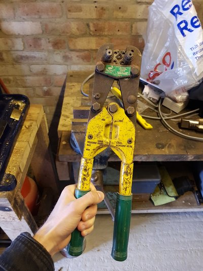

have a medium size pair and also a set that goes up to 100mmevery crimp i do i give them a good pull after having some come loose .they were a crap make the ones that did and i binned them allMy previous workplace made subsea control modules, the guys would do test crimps before starting wiring. These test crimps would be tested in a calibrated pull tester to ensure the crimps were achieving the correct "grip" on the cable. I'm not sure how much the crimpers cost.
