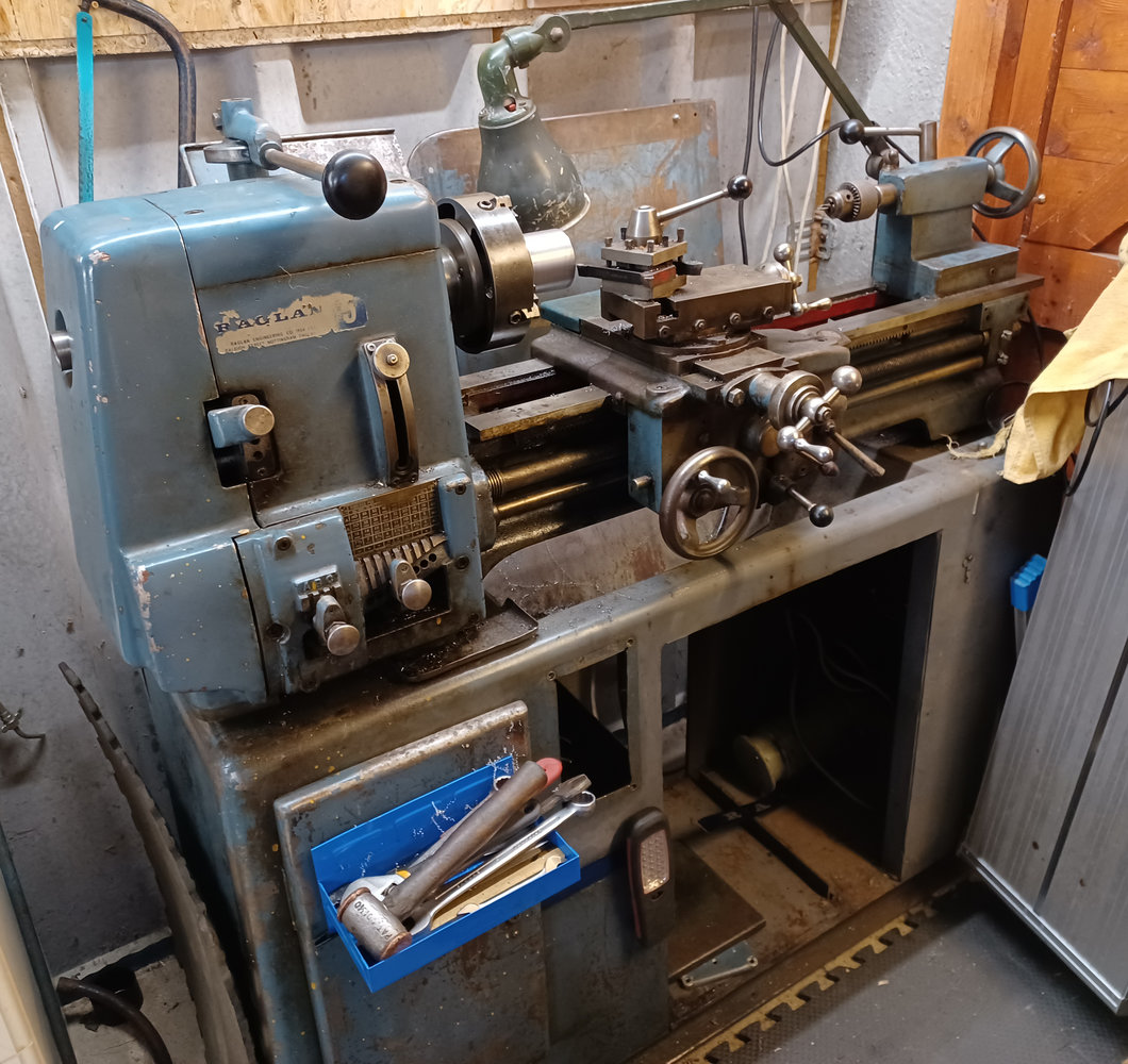

now i know most of you have big lathes, unfortunately i just dont have the room for a lathe like that.
would love one, remember using one in school when i did metalwork..
biggest one i could really get was a clarke 430L and make a drip tray for it so i could mount it on the end of a long bench.
as apposed to having the metal stand for it.
