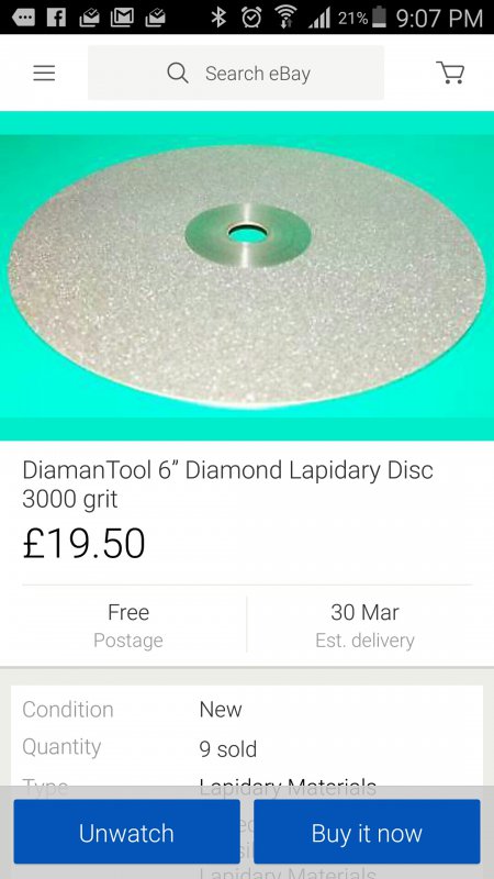

So more like what you would use to cut plasticYes I'll take a pic of it tomorrow. I bought the discs for sharpening carbide scrapers but they also do a great job on lathe tools.
