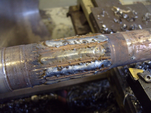

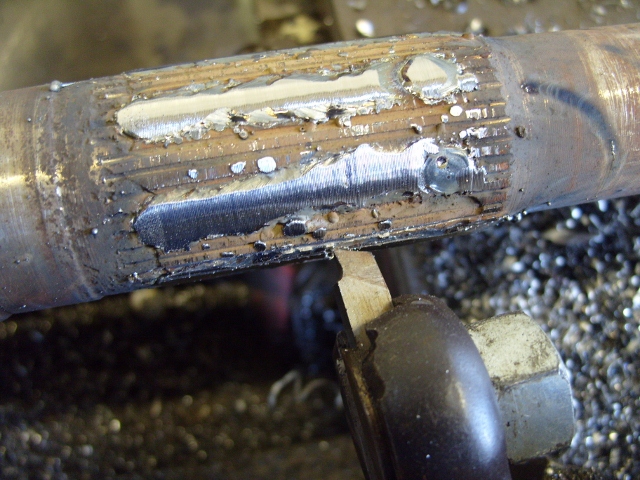

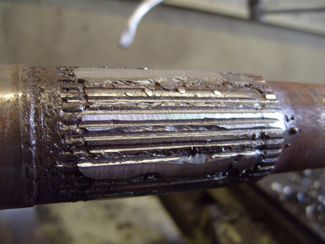

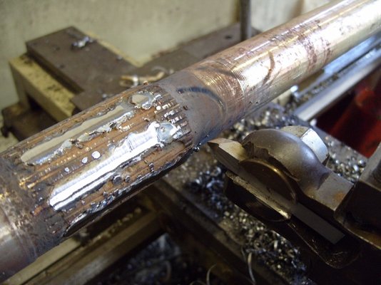

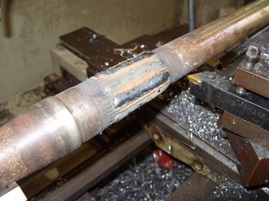

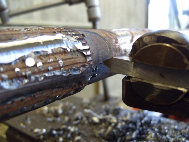

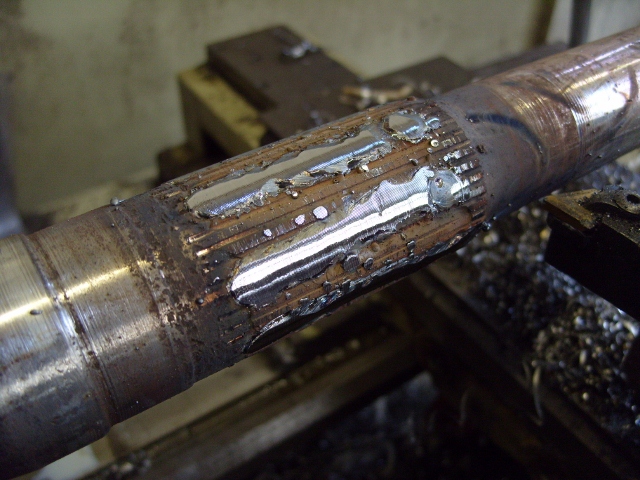

Did you just drY the tool over the face with the slide!
locked the chuck and drove the saddle by hand taking a coupla 00ths off each runNice fix
Did you have to cut the splines by manualy operating the carriage.
I've seen someone do something similar by using a live centre in the chuck and using the power feed.
eyeballGood saving. How did you index the spline?
