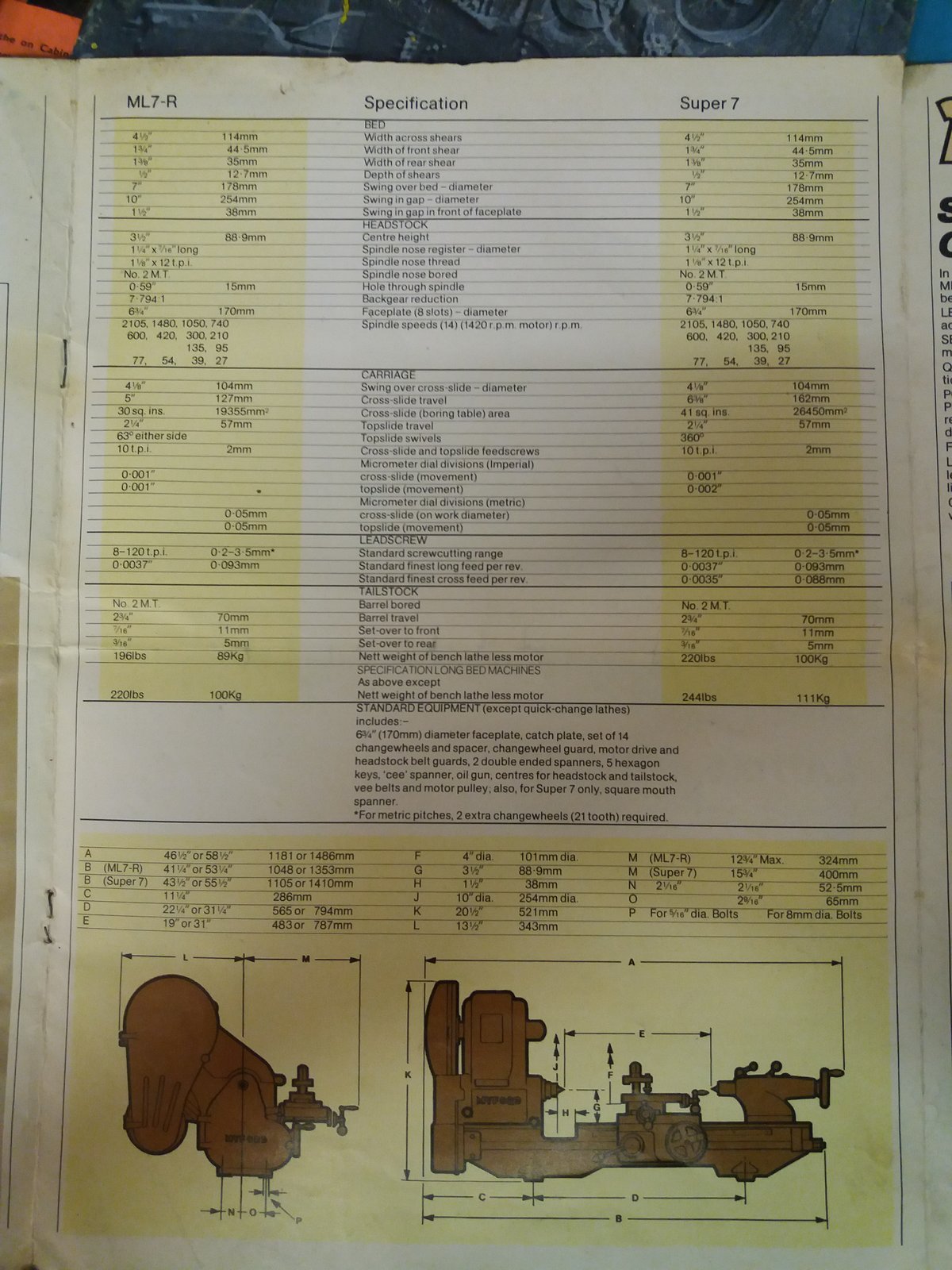

I am looking at getting a Myford lathe, I have seen ML7 and Super7 models listed in places, Is there a big difference in those models as they look the same to me, Thanks.

not all super 7 have power crossfeed the earlier ones haven't. its no big deal mindBoth ML7 and S7 were available with screw cutting gearbox. Main differences are the S7 has powered cross slide and the tail stock is a nicer design. The ML7 tail stock has the lead screw protruding from the centre of the hand wheel so gets in the way when fully retracted.
Most ML7's also don't have a clutch to disengage motor.

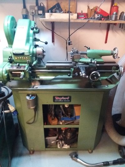

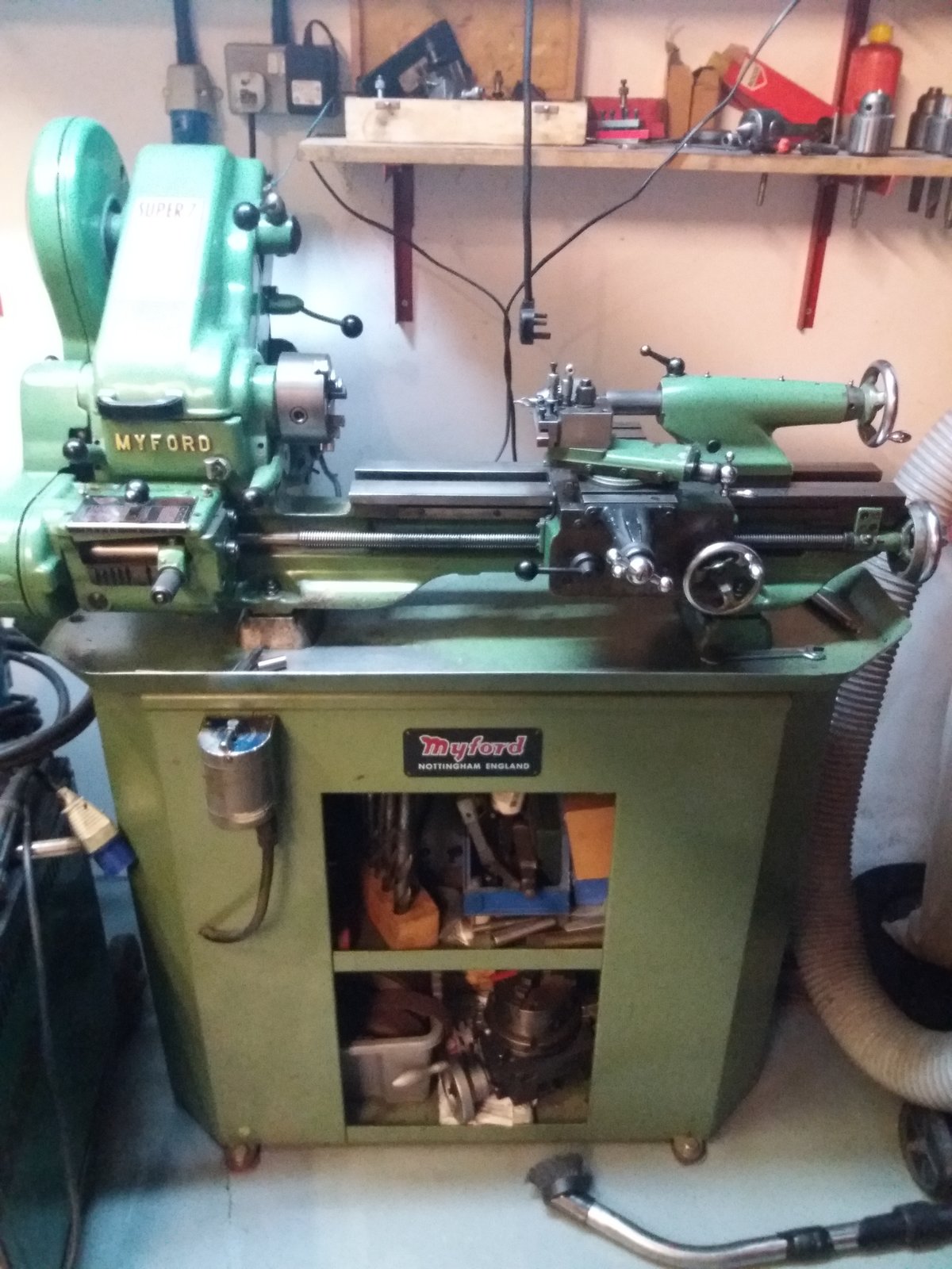

I have a ml7 from new and use it a lot .no clutch on it but bought another ml7 that has one on it for 100 quid so going to rob it off and put it on mineMy dad bought this new in 1980 for £1200
I'm getting a little if no use ex uni Colchester Bantom soon but can't bring myself to part with the old girl.
