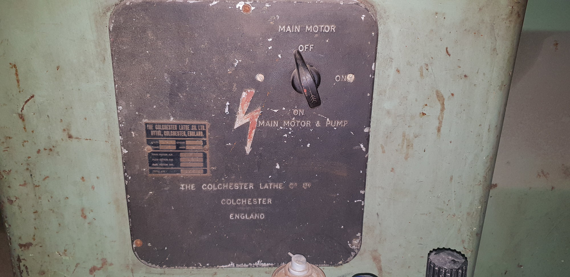

That's the switchgear for the on/off and reversing handle on the front of the lathe.

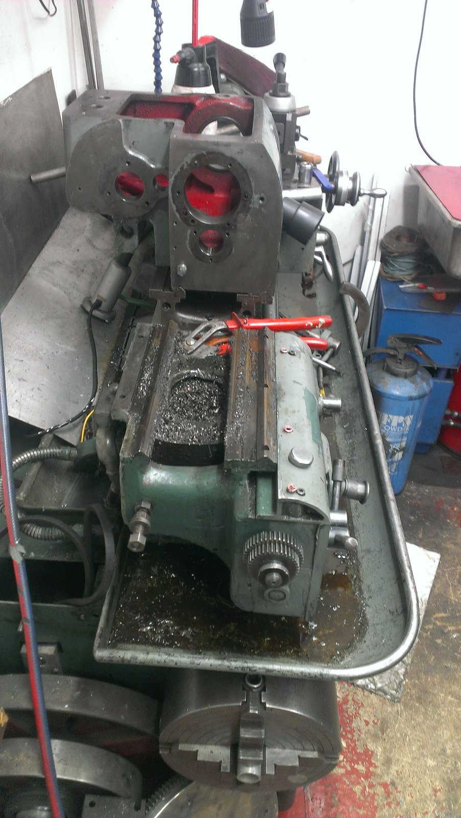

There should be a perimeter gasket on the top cover,that doesn't cover up the oil wells as they get lubricated by slash from the gears when its running.
The drain plug is behind the drop gears under the side headstock cover,i run iso 32 oil in mine which i was told is a good replacement for tellus oil.
