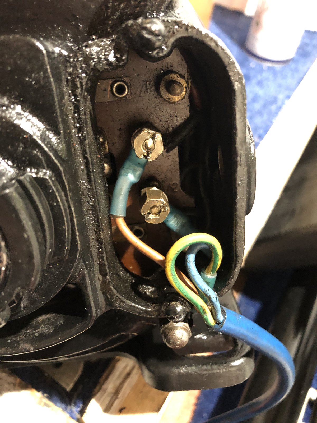

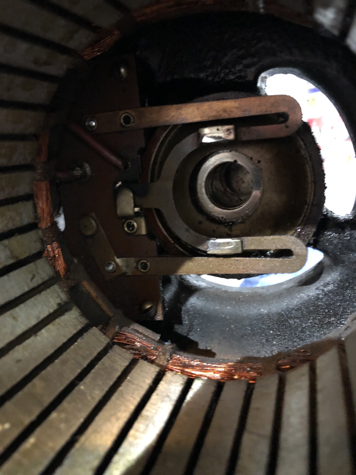

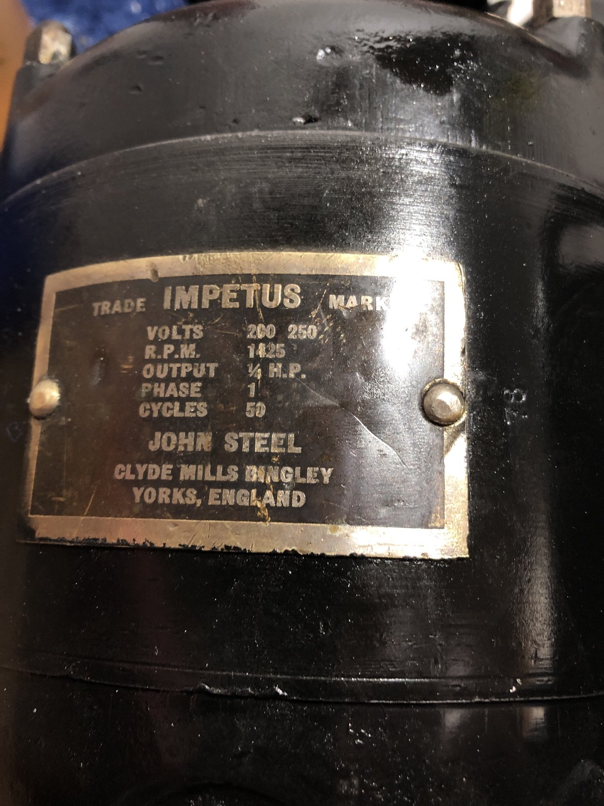

no you need to swap the starting windings in side if you can get to themI've moved my motor to the other side of my lathe to keep it out the way of the oil and swarf that was splattering it but now it's running the wrong way would I just be able to swap live and neutral to get it running the right way
How would I do thatno you need to swap the starting windings in side if you can get to them

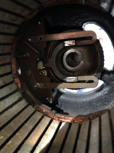

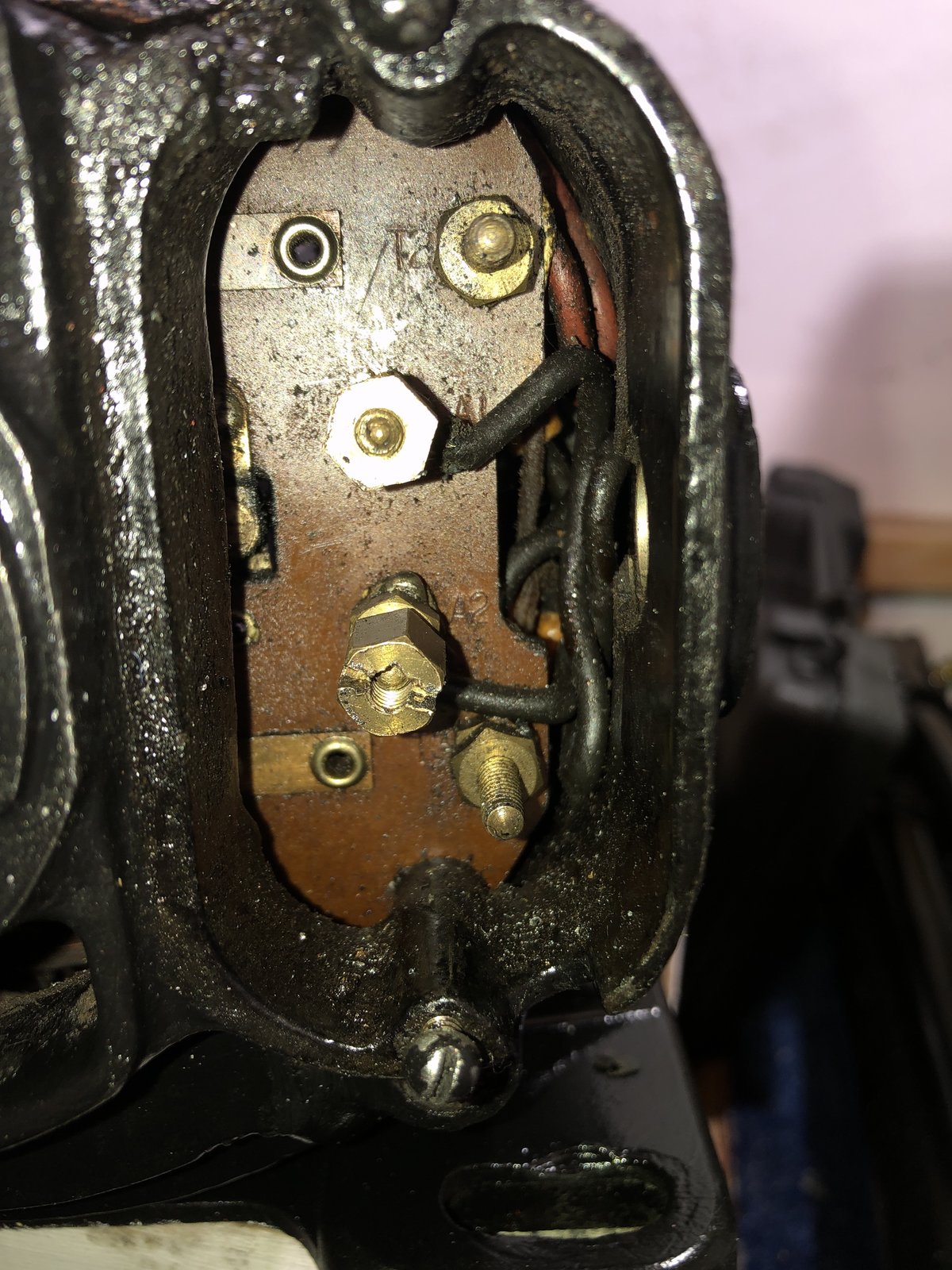

I’ll go take one nowNope, but you might be able to reverse it in the junction box. Put up a photo.

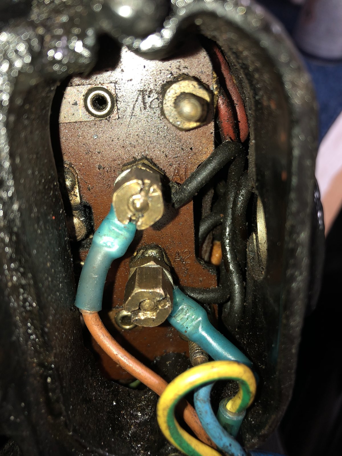

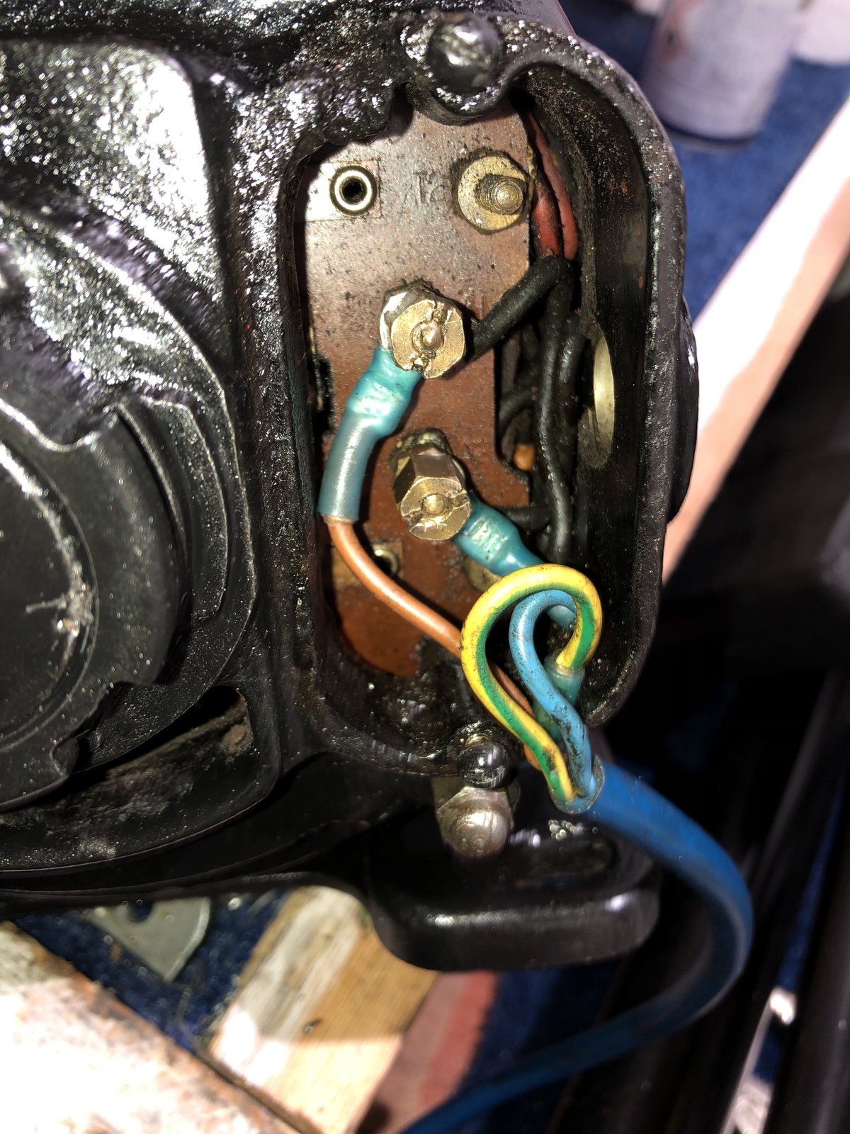

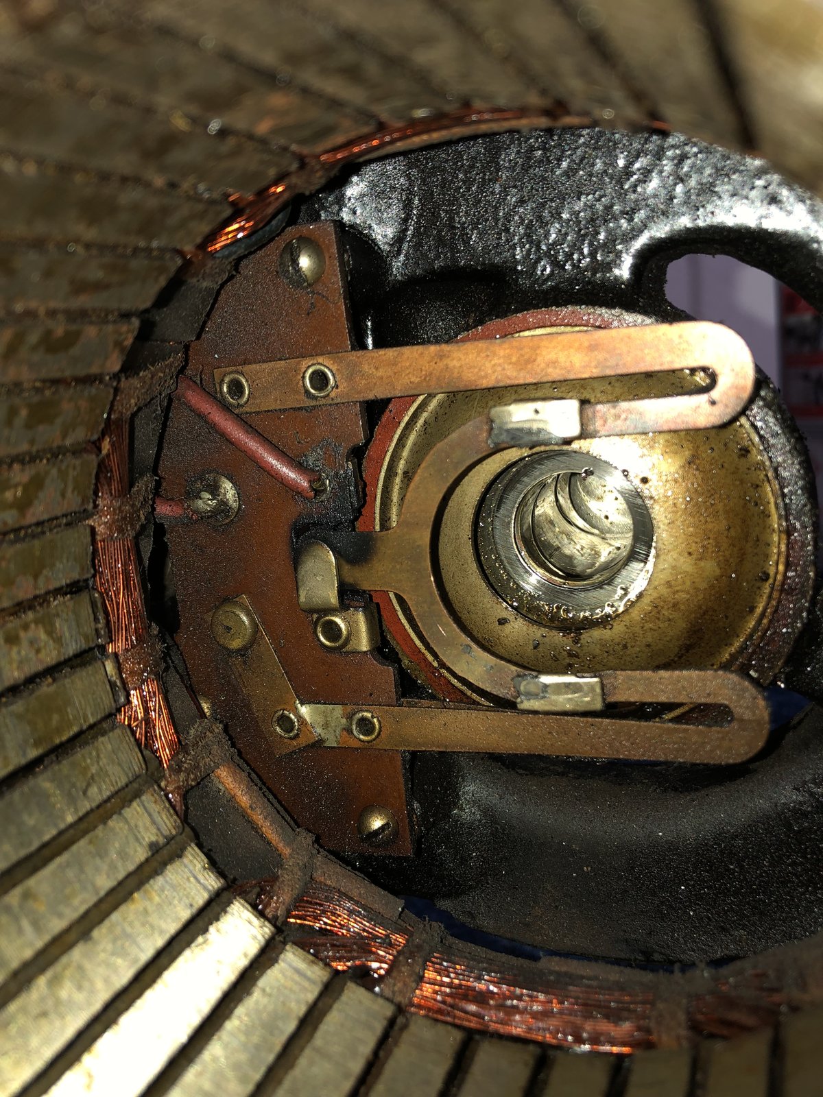

No, you should have four wires there. You'll have to remove the end bell off the motor and look inside to see what's been done, or just put it back and make a tin cover to keep all the crap out of it.

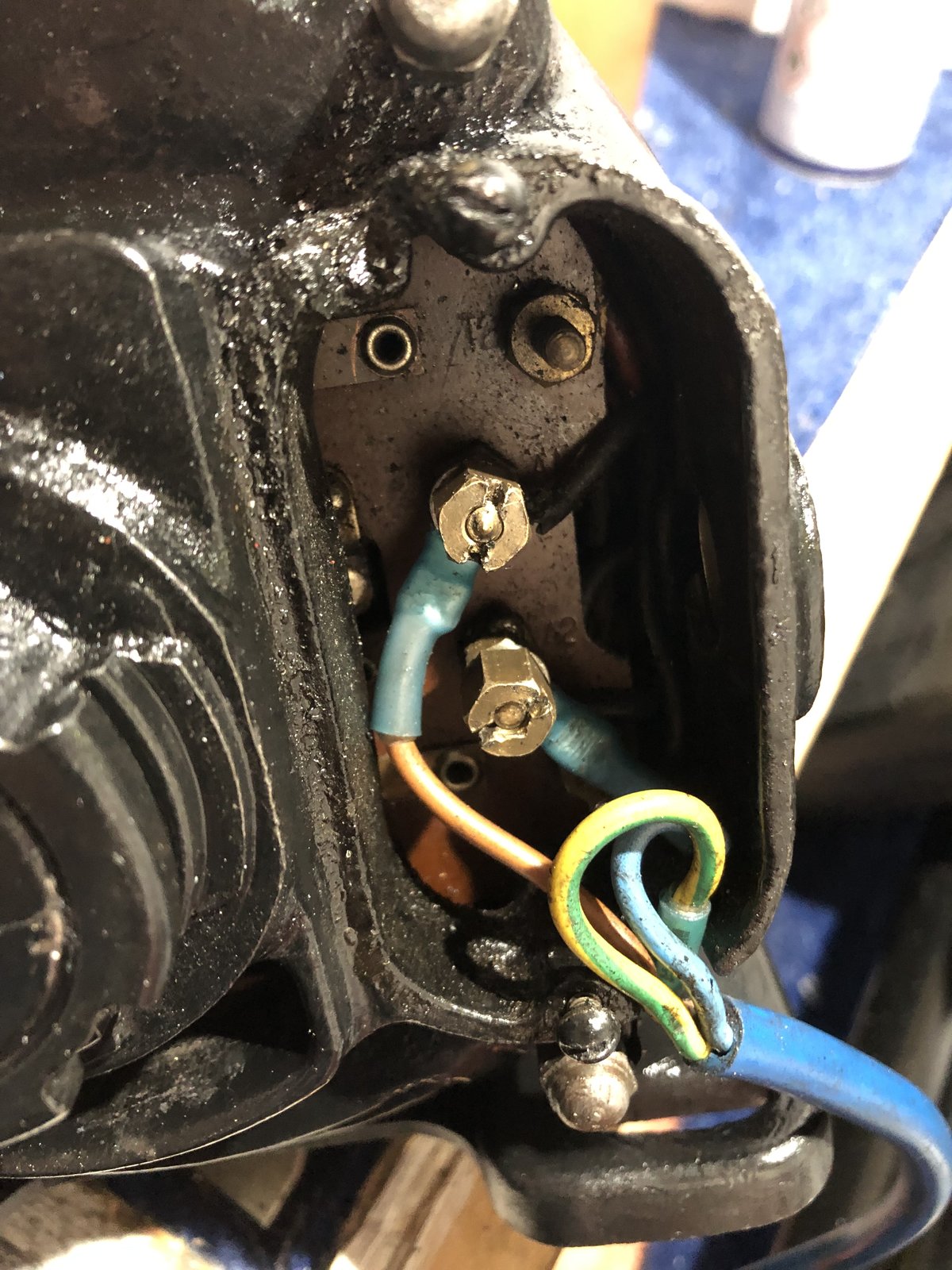

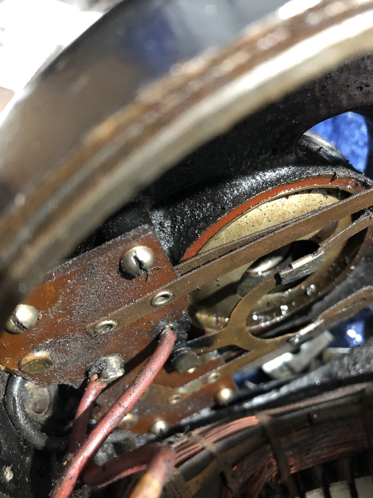

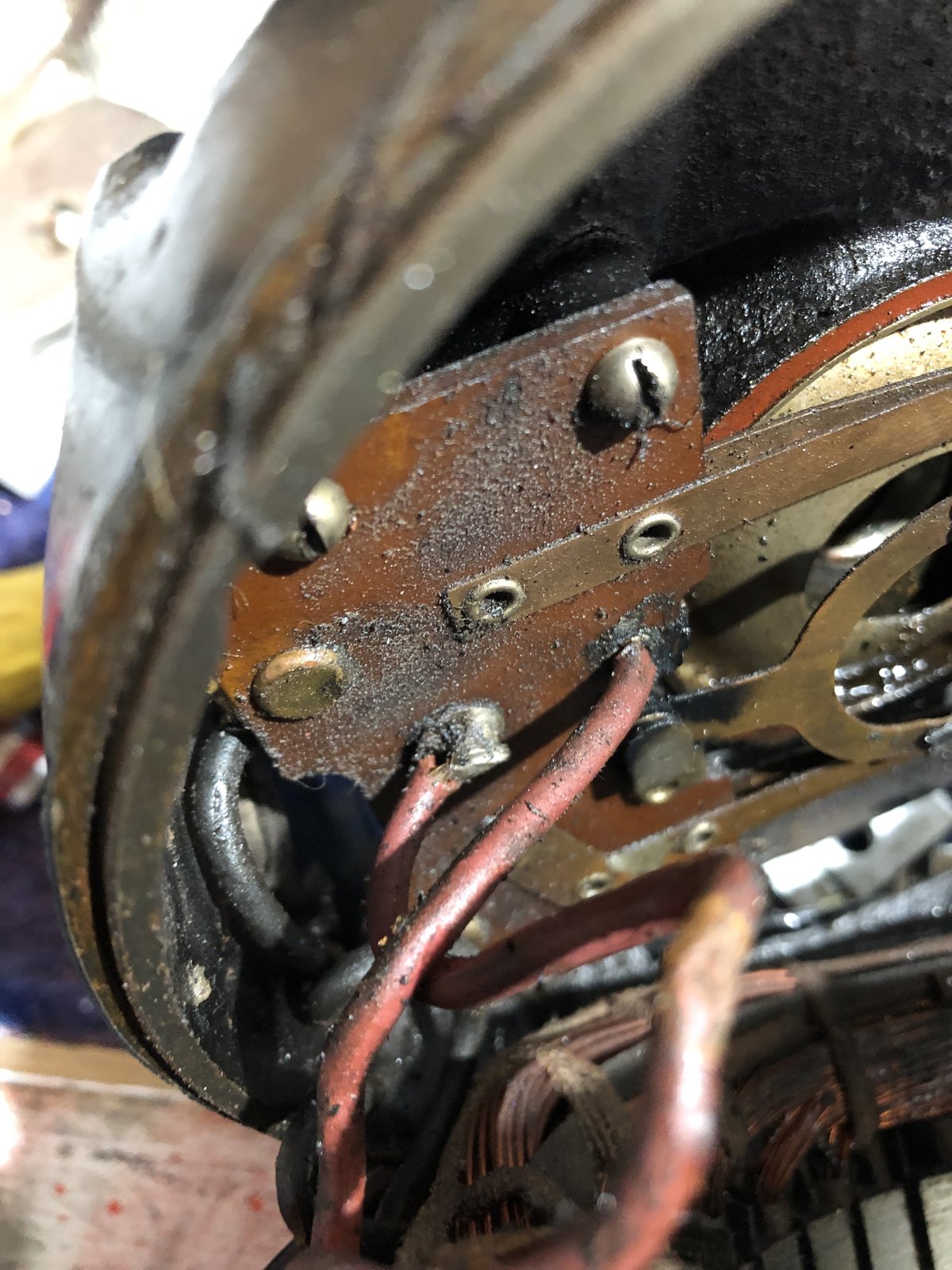

Here’s some more picturesYou have four terminal posts. Great, but there are only two wires connected that we can see. For a reversible motor there should be a wire on each post.
You need to take the end cover from the motor and identify where the connections have been made internally, then bring them out to the other two posts. As I said, it sounds difficult but in practice, isn't provided you have a clear understanding of what you're trying to acheive. If you don't have any experience or electrical nous, then maybe it's something you might not want to attempt.
