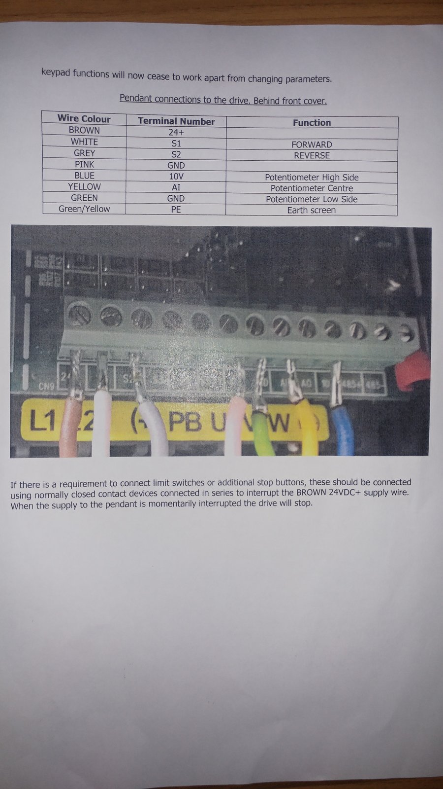

14rpm 1.5kw motor i had to set the ramp up and down from papperwork transwave sent and im sure its 10secWhich model VFD do you have? What's the motor rated at. Unless it's over 1.5 hp I doubt you'd need the braking resistor. There's usually a ramp up-ramp down setting that accelerates and slows the spindle quite rapidly.
