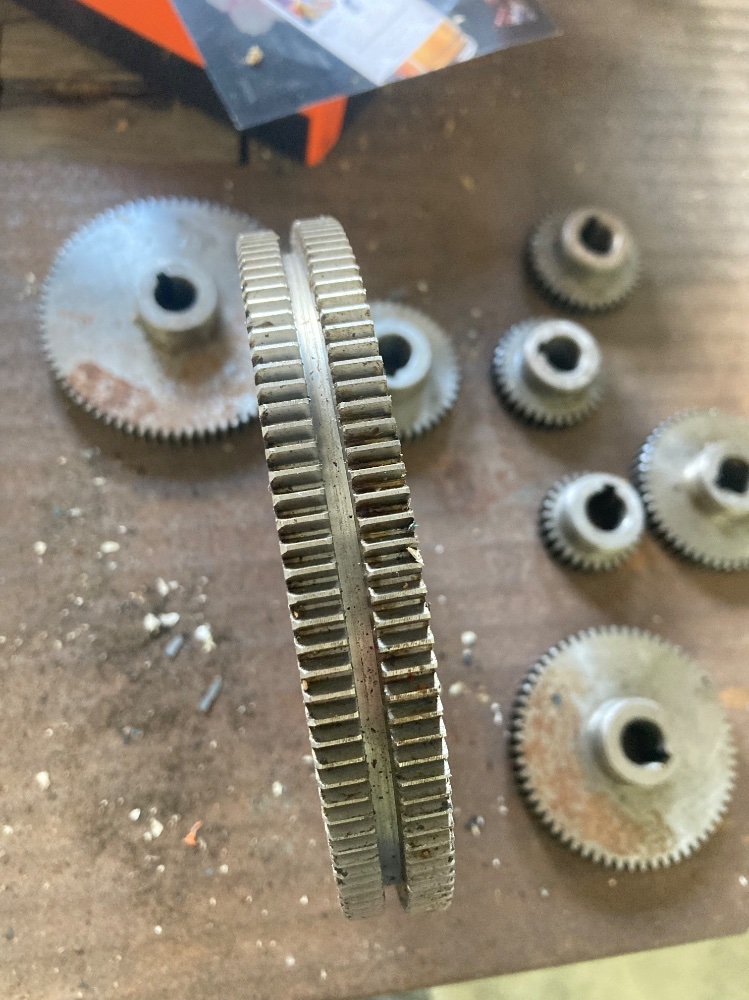

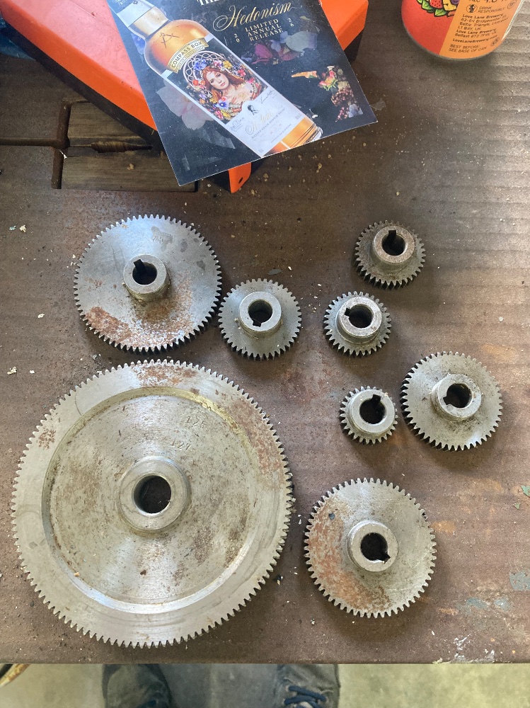

Curious if anyone knows what lathe these gears fit, I presume they’re imperial threading gears for a metric lathe, they appear to be 1 MOD.
125/127T combined gear with 17mm plain bore
75T with 12mm bore and 4mm keyway
60T “
43T “
42T “
36T “
33T “
27T “
I bought them in mind to use the 127T gear to produce a 32DP gear using it as a pattern for indexing.
