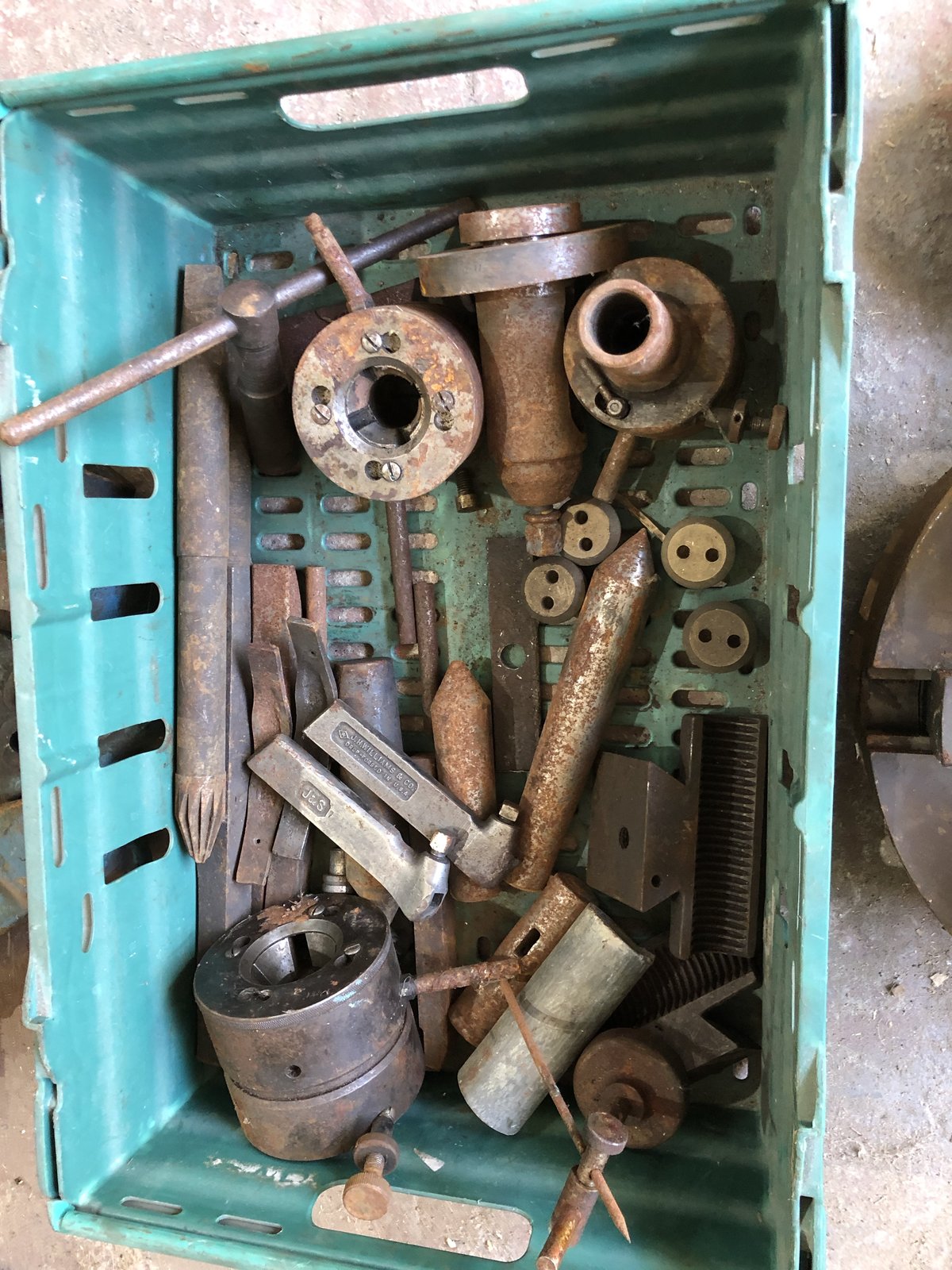

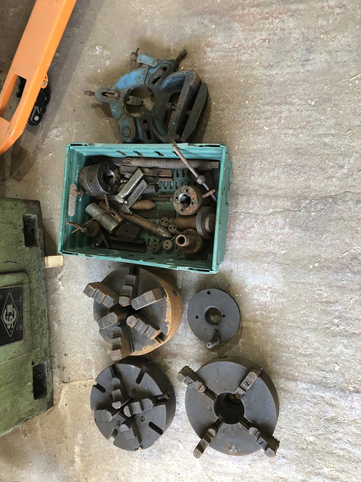

Won these items on Ebay last Friday for the grand total of £10.50.
Still bargains to be had if you look long enough.
Collected them today but I couldn't in right conscience not hand over a bit more cash.
Gave the chap an extra £40 notes.
Still a good haul for £50.

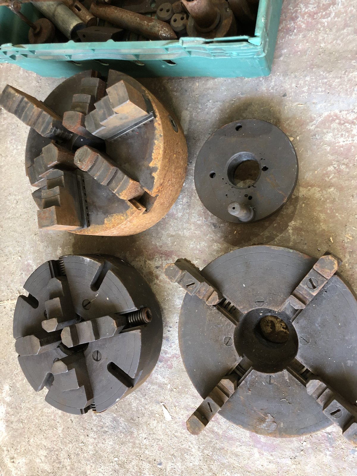

All the chucks have a large threaded mount, the 3 jaw is cast in so I will machine it off to fit a D1-8 mounting plate.
The 2 four jaws have a back plate so will be easy to swap over.
I have some Citric acid to pop all the bits for a clean up.

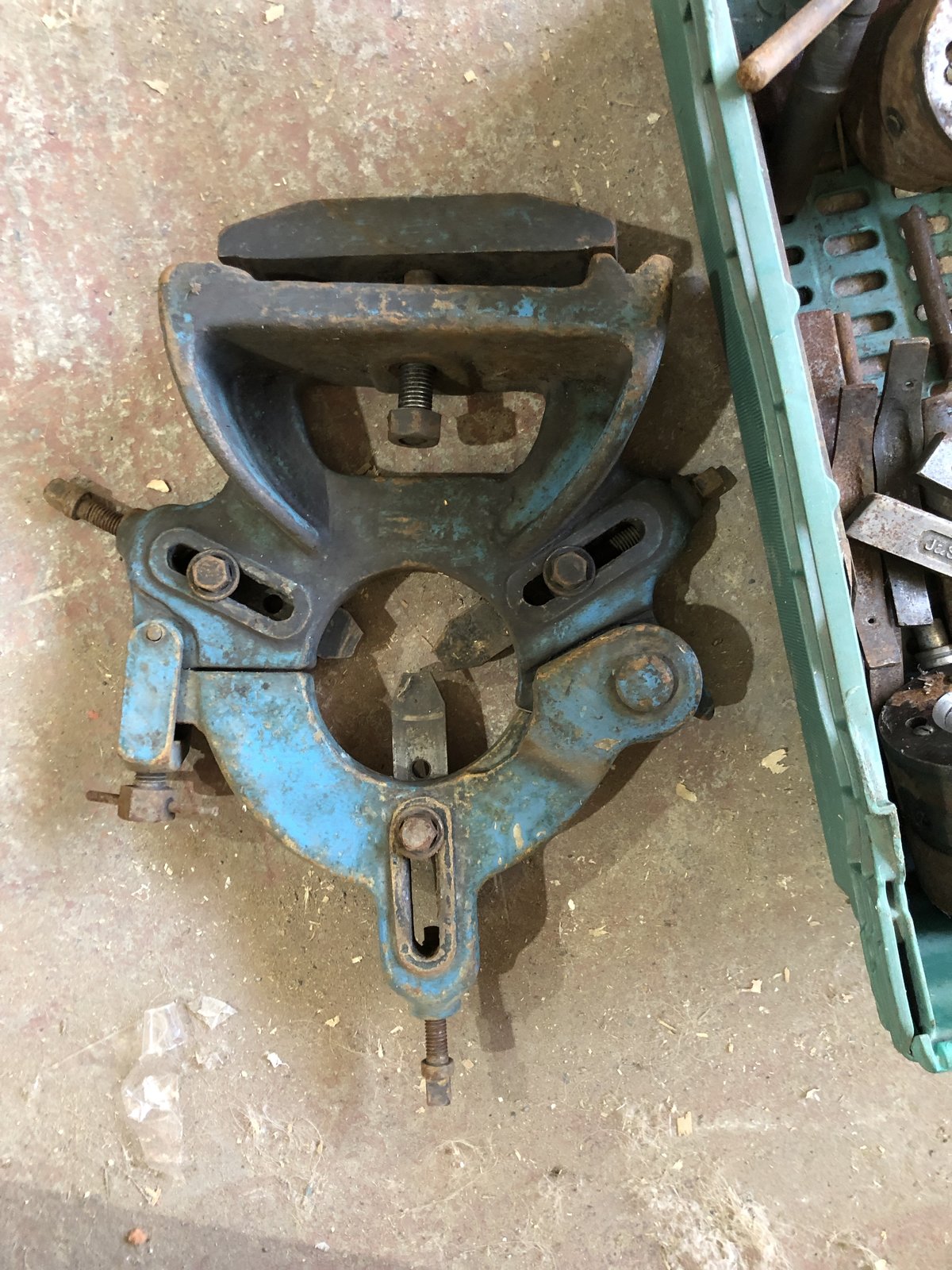

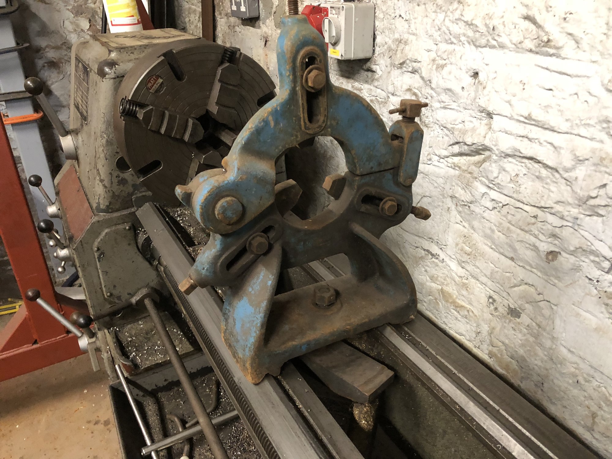

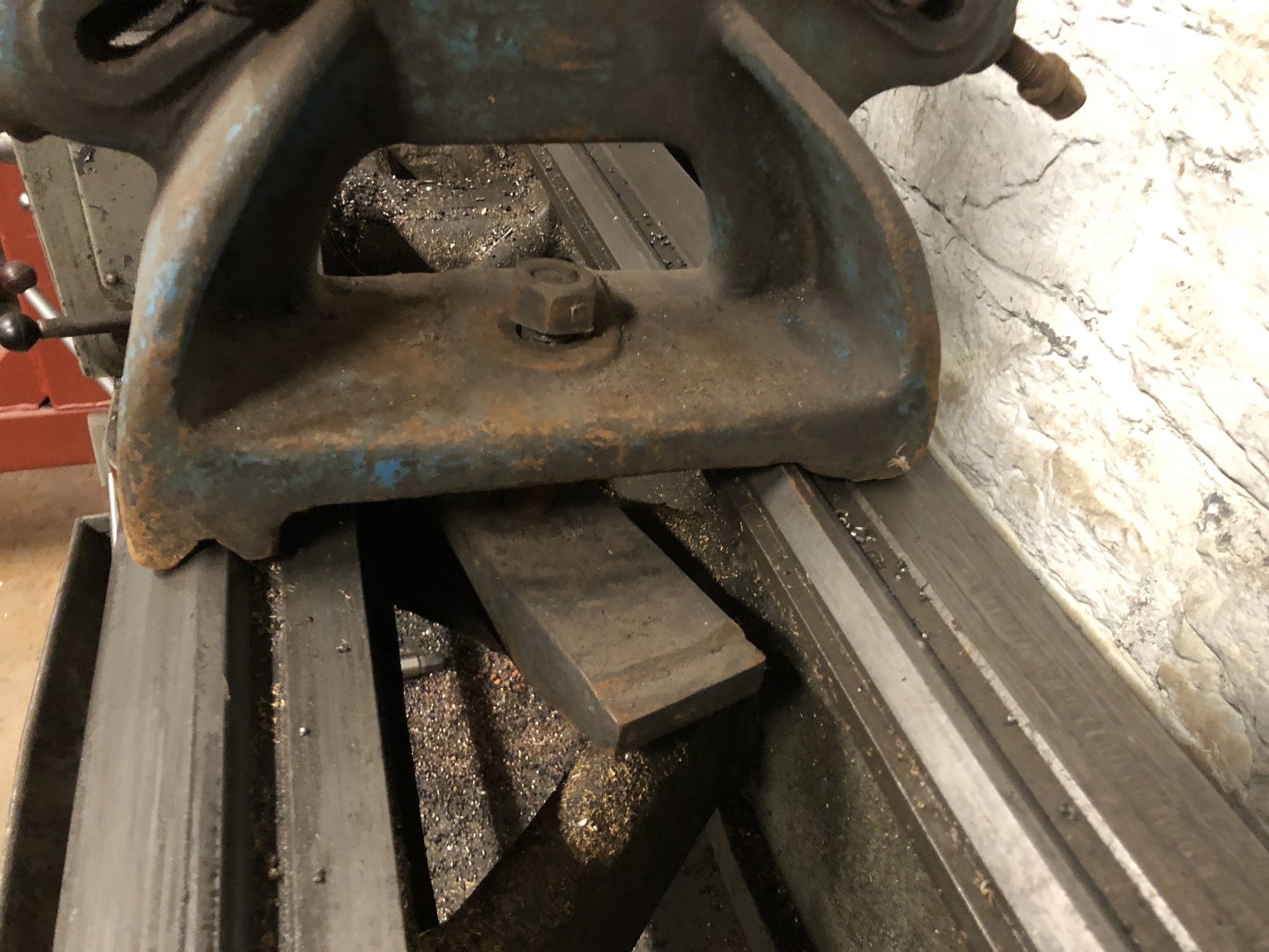

The steady is 7.5" centre height so matches my small lathe. Looks like it wont take much to adapt it to fit:
