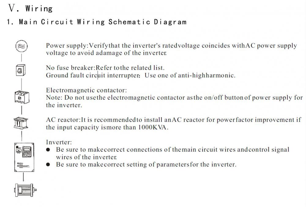

before i got side tracked rebuilding a farm house, i purchased a 3 phase lathe. Then a phase convertor from traswave. Well as i said i got side tracked. 2 years later,,,,, And today i had a play.
Wired up phase convertor, and plugged it all in, green light comes on, and the motor sounds like its trying to start, but doesnt. The boost light never goes out and phase 2 sits at 200 volts.
Head scratch time, any pointers greatfully recieved. Have a funny feeling that the control circuit is wired from L1 and L2, and as L2 is the manufactured phase its not closing a relay.
No wiring diagram doesnt help!
