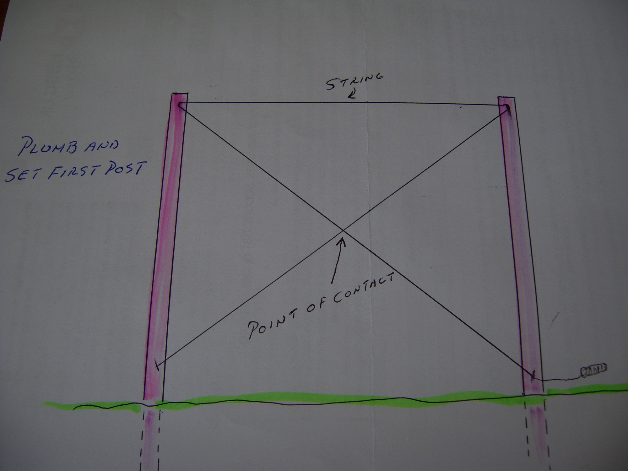

a string line is just as accurate as a laser line 1.8th of an inch out max on posts is immaterial dunno how the romans and Egyptians managed accuracy with just a line

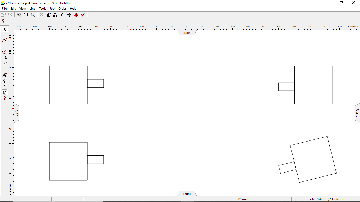

Fraserb see those 2 top posts you have drawn, keep them as square as they are but move your right one upwards.... That's what I meanIf i've picked you up correctly you're wanting to make sure the posts end up like the top two and not the bottom two?
Staggered not twisted
Yeah I've done this but then I walk off, walk back towards it and forgot the lines still up hahaYeah I get you, i just pull a string line round the posts and if it's touching along the flats on both posts it's square.
