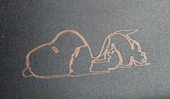

15W laser diode engraver.
Chickens done at 200mm/min, Snoopy done at 100mm/min.
The laser uses LaserGRBL, and I just selected it to vectorize and do a single outline.
In the flesh there's not much difference between the chickens and Snoopy, so I suspect it would need a less focused beam (you can adjust focus on the diode lasers), or to double up the lines.
