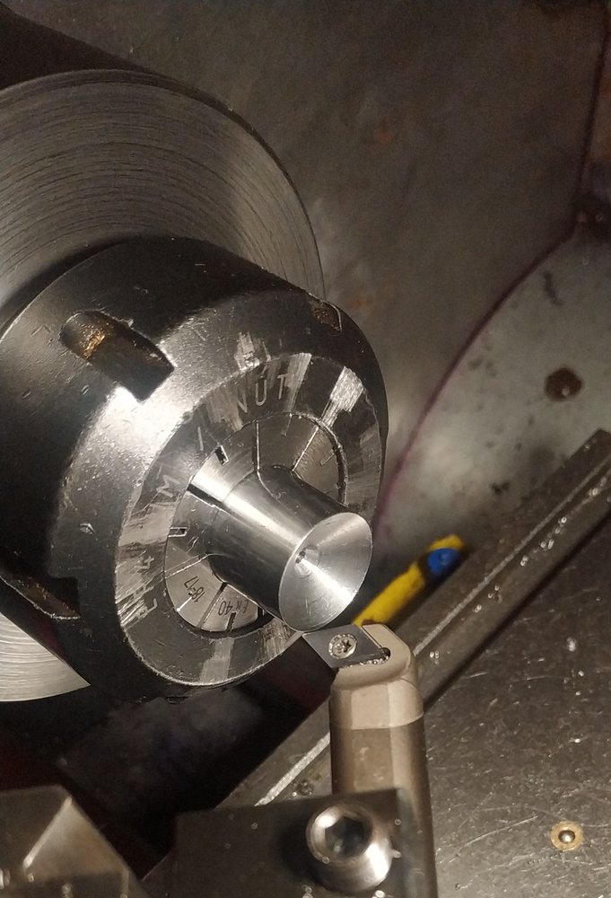

I'm playing with some ideas.Does anyone know of a YouTube video on how to make one or just showing a home made one might help.?
Have the 60 degree angle cut. To save lots of clearance grinding (which would be by hand and rubbish), and knowing that silver steel edge wont last, Im going to instead build up the cutting edge with a line of HSS tig filler and then cut that back, so there will be minimal grinding, before grinding the cutting edge.
Other option would be cut a big slot and fit a hss or carbide blade, which may be easier to grind and more adjustable.
I'll can chuck one in the post, end of week, if its any good.
The Marwa one looks way over complicated having a split collet type holder, I can see why its so expensive but seems unnessasary to me.
