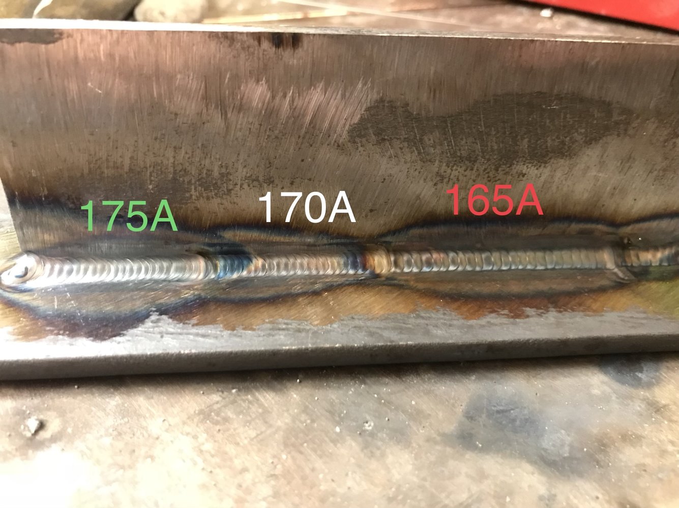

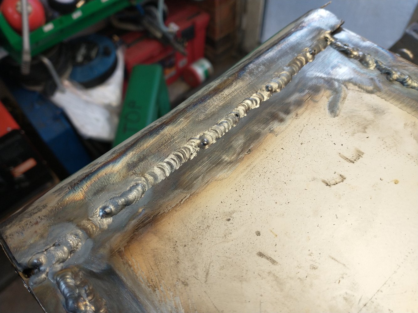

Probably a bit of bothStill too cold or too long an arc.
I tacked it up and then ran welds between tacks. I was swapping around so I didn't get heat build up in one place. That's why it looks a bit scrappy.Lookingat that, assuming you are happy enough with you settings, it shows signs of non comfortable movment and having to reposition your self along the weld.
I think-at your stage of development, youd get far more consistent results sat down at a table or flat surface, where you can support your arms, rather than standing flying free hand.
