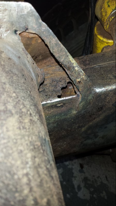

You can just about see the bend in the rear crossmember in this pic
Looks like its had some kind of previous repair, all thought not sure why as the other side is different
