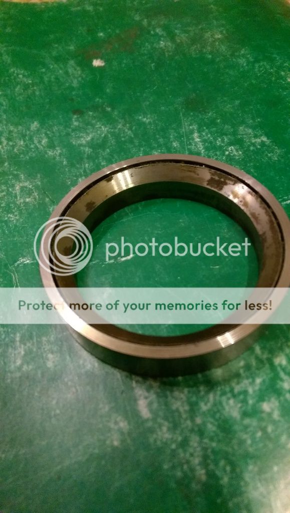

Yes, you're just talking about decent quality, high carbon steel that'll be workable, which you then harden and temper once you've done the machining work. Though you may find that the size would alter slightly, I think it's normal to do the final sizing after the heat treatment.
