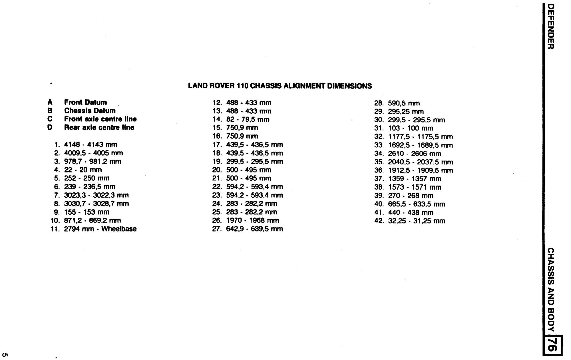

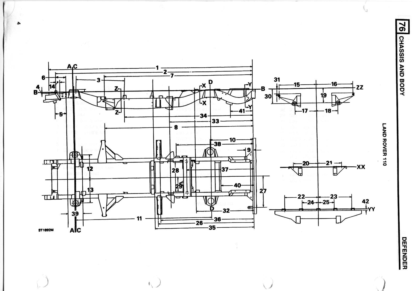

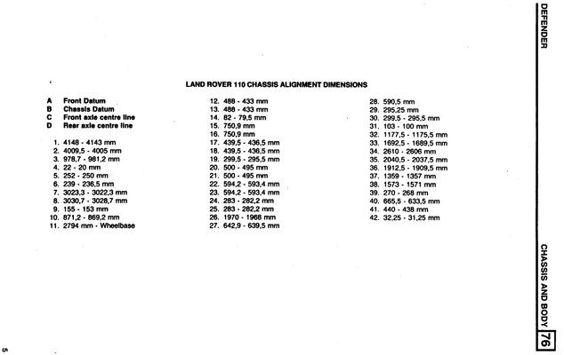

Couple of thoughts from my side:
1. As you can see, someone has already removed the rear cross panel, so we've got nothing to measure from to determine where the new panel should finish up. Can anyone give a dimension to a reference point from the back to somewhere on the chassis rail?
2. Any tips for removing the fuel tank? I believe that access is limited, but sometimes there's a 'way' with theses things.
