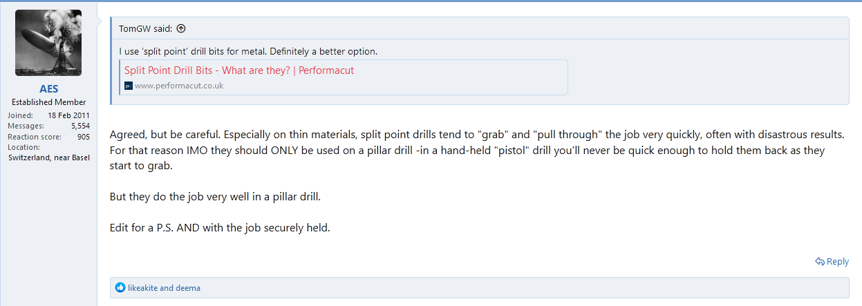

Discussion about a 12mm jobber drill being too long and vibrating, various suggestions of centre drills, spot drills, blacksmith ones etc. Someone suggested drilling up to size on steps.
After getting tips from Kurtis at CEE, I now drill a pilot the size of the main drill’s chisel bit/web, then go straight in to size. Saves faffing. Put up this video (8mins in relevant bit):
