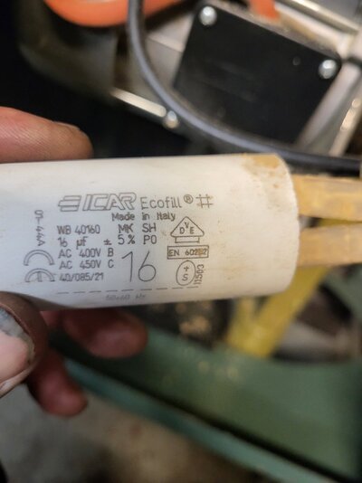

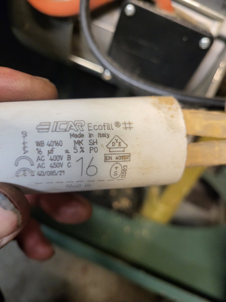

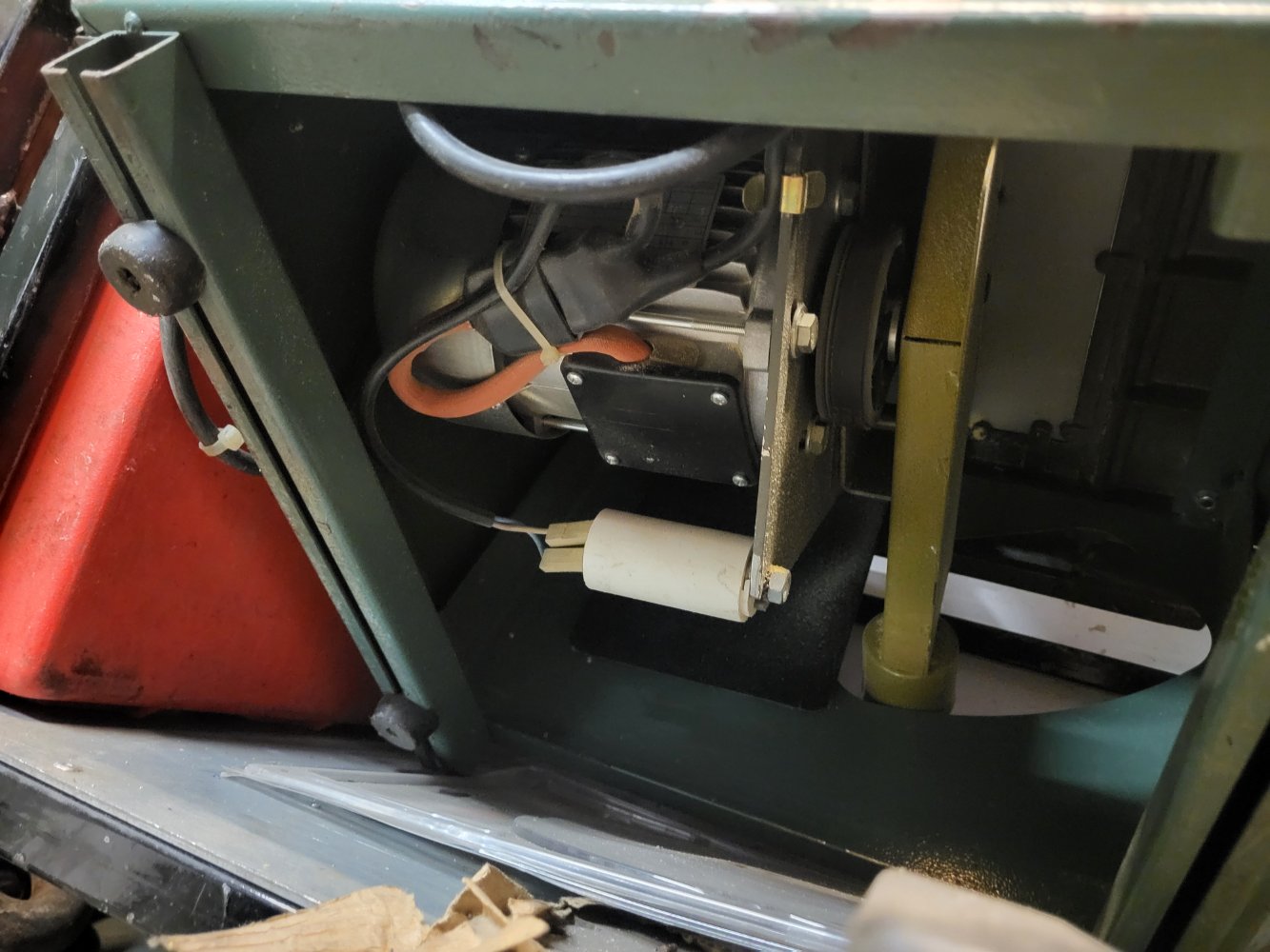

My reliable little Kity 419 table saw has stopped working (Well almost)
I was a little heavy with a cut and the motor stalled, since when it won't now operate unless it's given a bit of a 'bump start with a biit of wood' to spin it over when switched on.
I haven't started to disassemble yet the frame/covers yet to see it, but I'm led to believe it's an induction motor (240v single phase)
Is it likely to be a capacitor issue, or something else, slightly more terminal?
