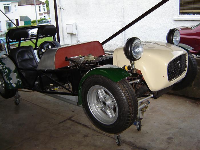

my "kitcar"... Its a nova developments (not a vauxhall nova!) grp shell with a to-be-modified lotus esprit S2 chassis, renault un1 transaxle (std apart from a transmission cooler for now, but want a derek bell mainshaft to deal with 500hp), mid mounted rover v8 (at the moment its got a spare 3.5, but when funds allow and it warrents the spending expect a 5L monster) and a 6-71 blower...
Chassis mods to cover side pods with lattice inside the deep sills, 3d cage with chassis bracing, and converting to later (>S3) double wishbone configuration at the rear, and I want remote rocker arm remote shocks instead of the coil-on-wishbone spax's its got now. I just dont have time to make the whole chassis from scratch, so the lotus chassis is effectively being a giant jig...
Ive already spent more than 250 quid on it, and its not a kit at all anymore
Luckily I bought a Zetec on ebay a while ago for £50, so that's going in (replacing the old crossflow).
