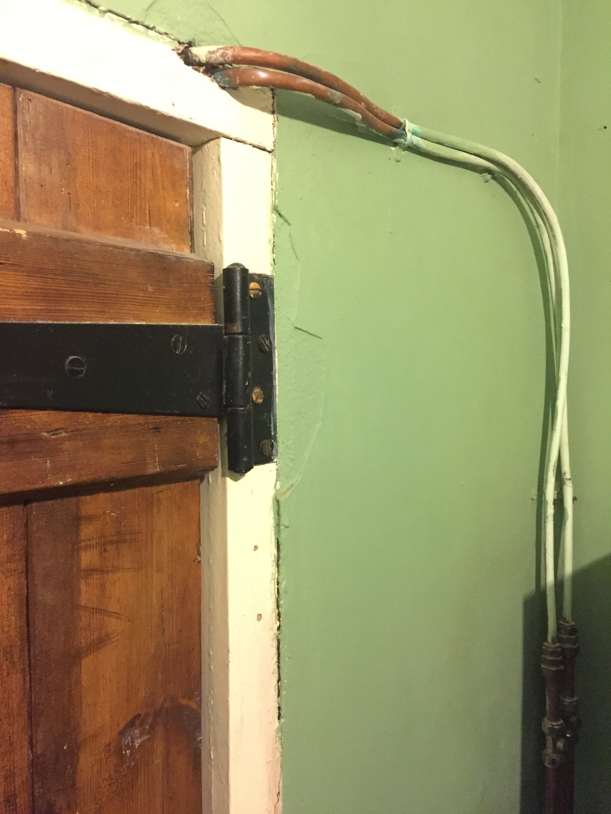

if you can pull a bit of slack straighten out the bend thats caused the kink, you dont need much - then using large pliers squeeze either side of the flat to push the pipe open
obviously dont go mad, microbore is pretty soft stuff and so hasnt work hardened too badly at this point so is unlikley to split. Obviously avoid bending it again at this point or it may well split.
If its totally flat and the pipe bent at about 90* then there is a risk itll crack so be prepared to drain the system and fix
