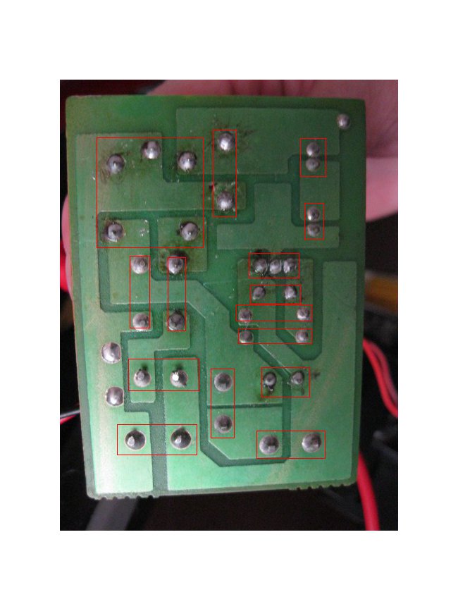

I wonder if any of you could help me diagnose what may be the problem with this toy. I have been lumbered with this since January, although it has resided in the 'to do pile' for a while since.

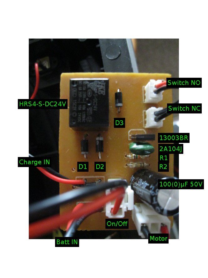

The toy is a 'Jambuster' electric scooter. The batteries are only showing 23'ish volts. I have linked the source direct to the motor which spins the wheel, so the only suspect seems to be the speed controller. I initially found a broken leg to one of the diodes, which once replaced solved nothing.
I tested what I could with limited fault finding knowledge: the relay threw when energized directly but does not throw in normal use, the switches all tested OK...
...thinking there are only a few components on the PCB it would be easier just to swap them all out to remedy a fix.
The two resistors are the only things that remain untouched. Also I boo boo'd with the cap rating which should be 1000µF.

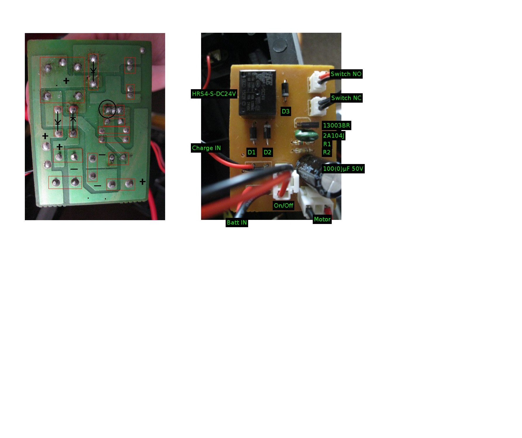

The diode(D3) is perplexing me: Out of circuit it reads fine; in circuit it shows strange values on both poles.
To add further context. I do not believe this toy had ever worked because the wheels show no sign of use. The toy arrived to me with the PCB mis-mounted inside its holder (suspect prior fiddling).
Is it possible the circuit has been constructed incorrectly ie. How can I ascertain, without a wiring diagram, if the board was printed incorrectly thus placing the diodes '**** about face' for instance?
The 'On/Off' and 'Motor connectors are interchangeable / as are the NO and NC switches. How would I know if they are in the wrong place, and would it matter?
You can possibly tell I am out of my comfort zone here!
If anyone could give me a pointer what to try next, or a few examples of how to fault find further, that would be most appreciated.
