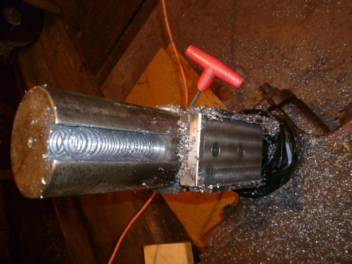

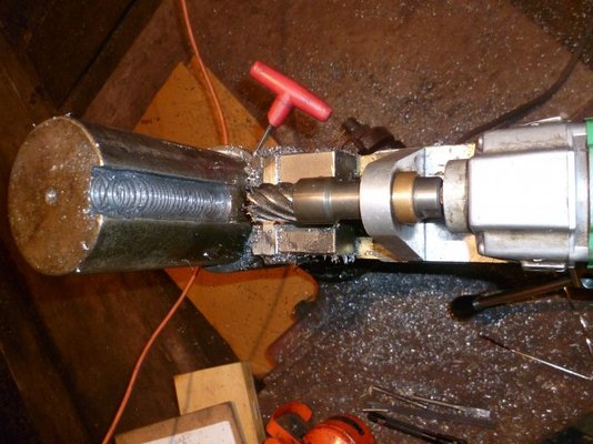

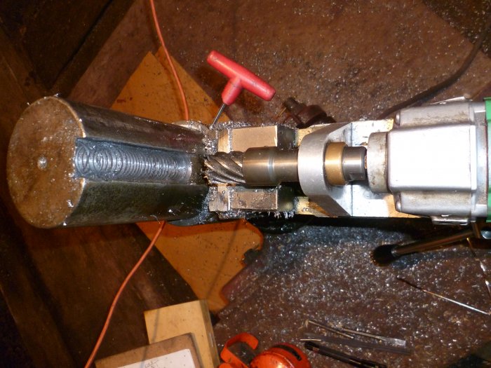

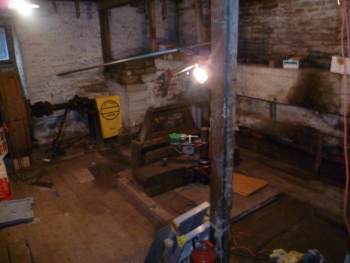

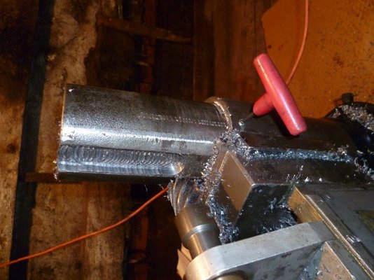

i'm near hay-on -wye,would like to see your m/c,sounds a good 'un.Hi, I have a machine that I made for cutting windows in steel gas pipelines, it has a hydraulic motor turning a tct blade, depth control, would cut a key a meter long if you wanted it to and will strap to a 4" shaft no problem.

excellent work, how long did it take you
