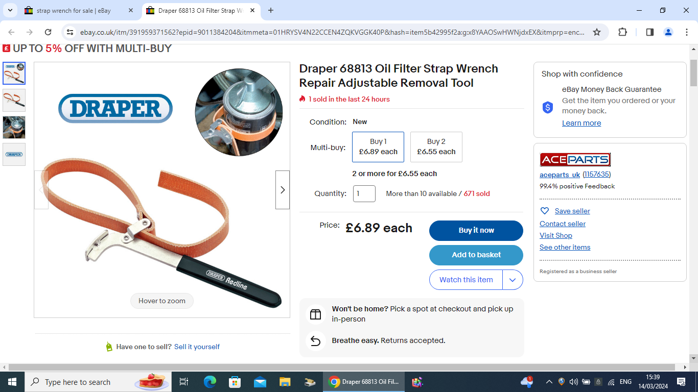

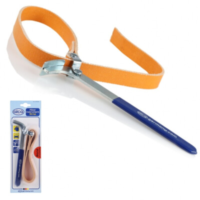

Cool idea, but I would make it out of a softer metal such as brass, so not to damage the knurling on the chuck.
Or something like this? There is another type with leather strap and a heel. Which I've just decided to buy.Cool idea, but I would make it out of a softer metal such as brass, so not to damage the knurling on the chuck.
