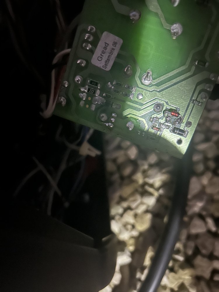

Got this in with one speed with very little change with the adjustment - thought scr but that checked out ok
So did some poking about with the meter and come across a tiny zener that was metering both ways - bingo gotcha .
So I swapped for something as near as I could size wise
Does anyone know what size to replace it with or as close too - it did have a tiny blue band which I assume is the direction band - it was that small they was no markings
Please see pic attached
Thankyou in advance
