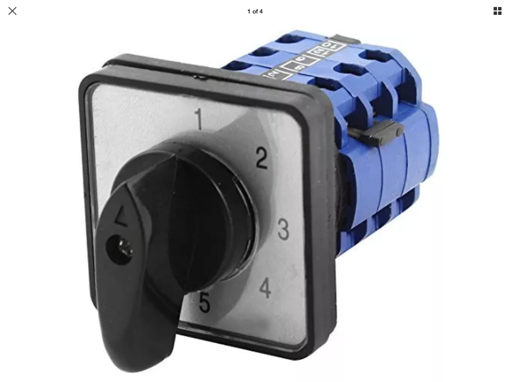

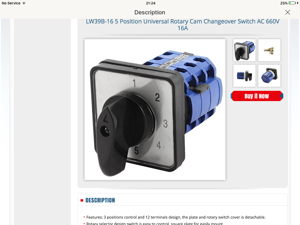

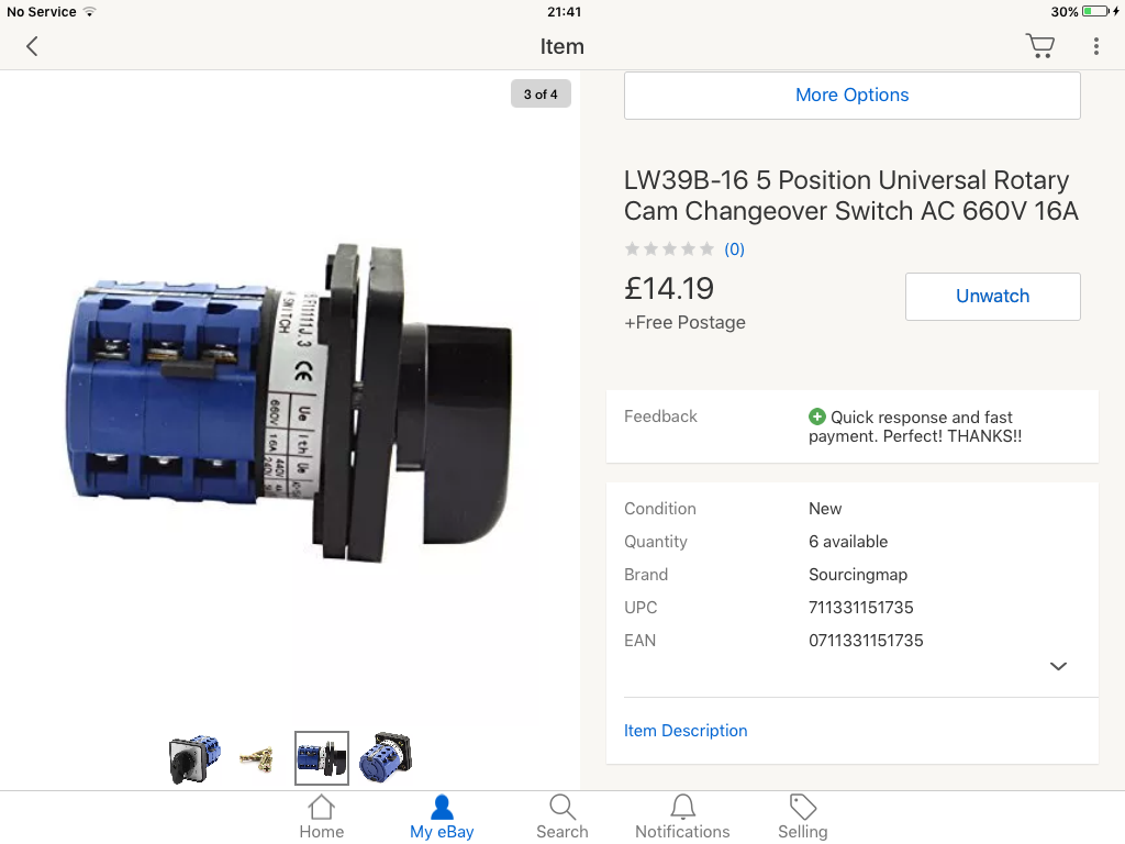

Louis macrides Member Messages 96 Location Weston Feb 25, 2017 #44 Pretty sure this is the correct one,as has 12 terminals and 5 poles (interlink bars) image.png 234 KB · Views: 150

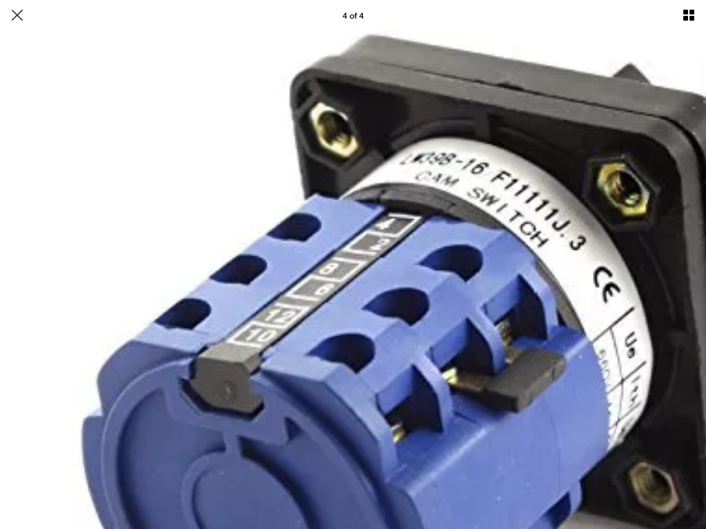

Louis macrides Member Messages 96 Location Weston Feb 28, 2017 #45 Eventually after great advice and watching YouTube videos I've realise you can change the cam inside the rotary switch ,I've actually got it working ,very please

Louis macrides Member Messages 96 Location Weston Feb 28, 2017 #47 I basically had to keep changing centre spindle on each cam till it worked ,

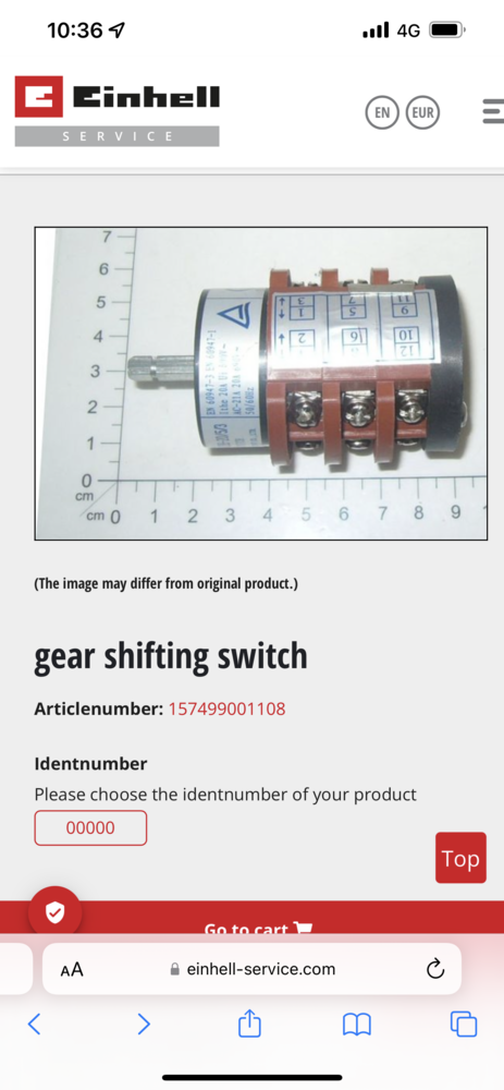

A Ajstars New Member Messages 4 Location United Kingdom London Apr 16, 2022 #48 You can order a new one from here; https://www.einhell-service.com/en_DE/157499001108.html Part number 157499001108
