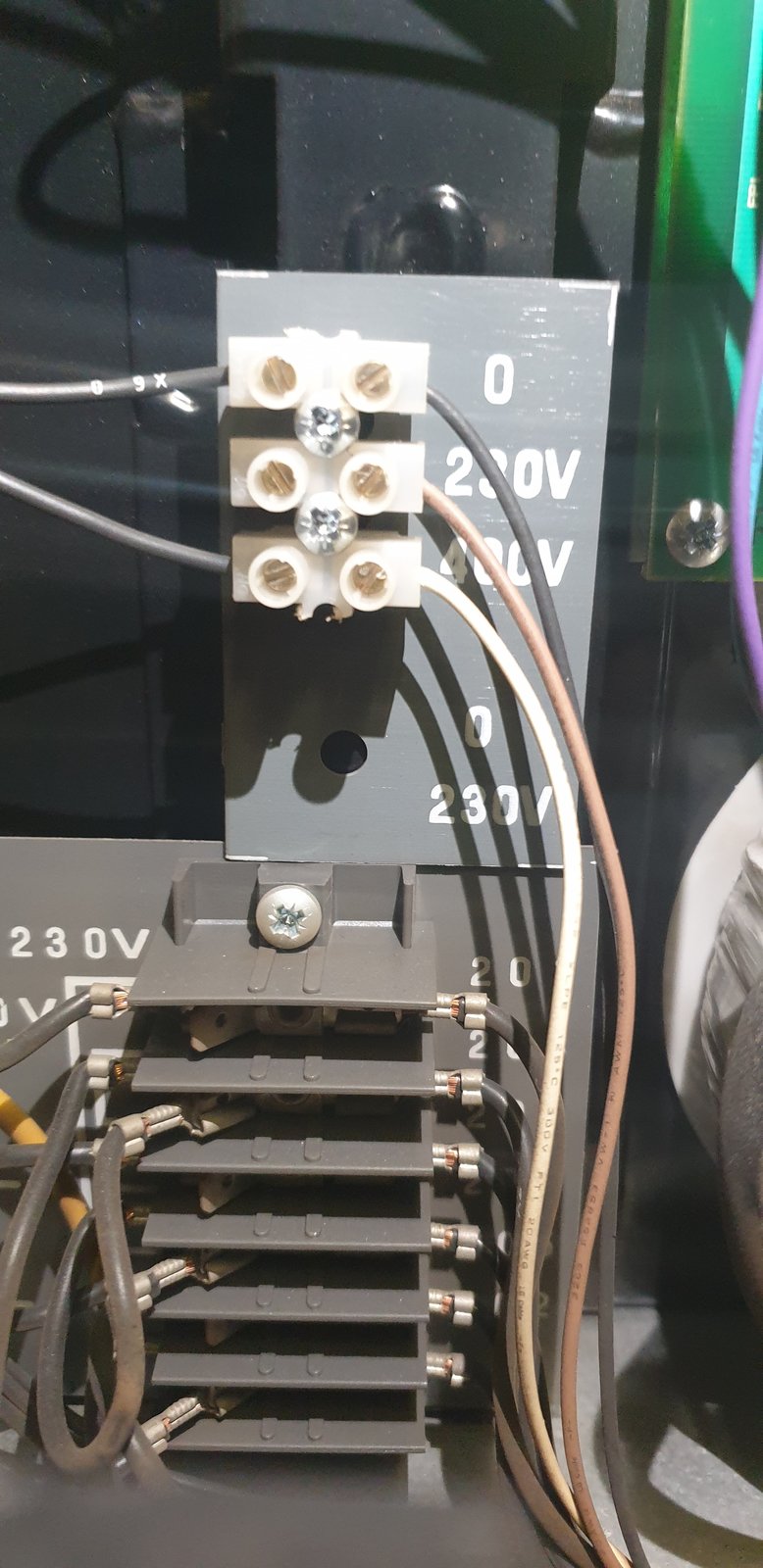

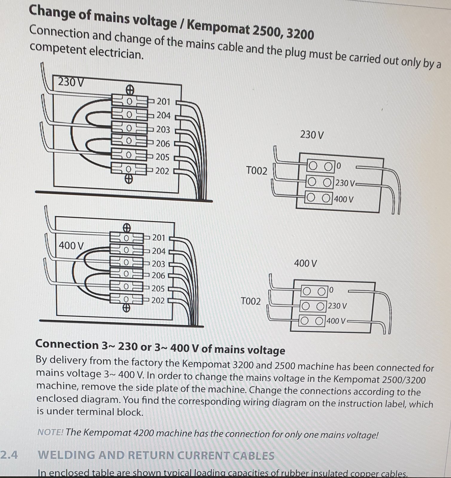

I've never heard of a single phase model of this line, I am not sure one exists.
As you can see it says 3~ before 230 and 400 v, this means 3 phase power for both voltages. And 3ph does come in both these voltages in europe depending on country. in Norway they have 230V and in Finland they have 400V for instance

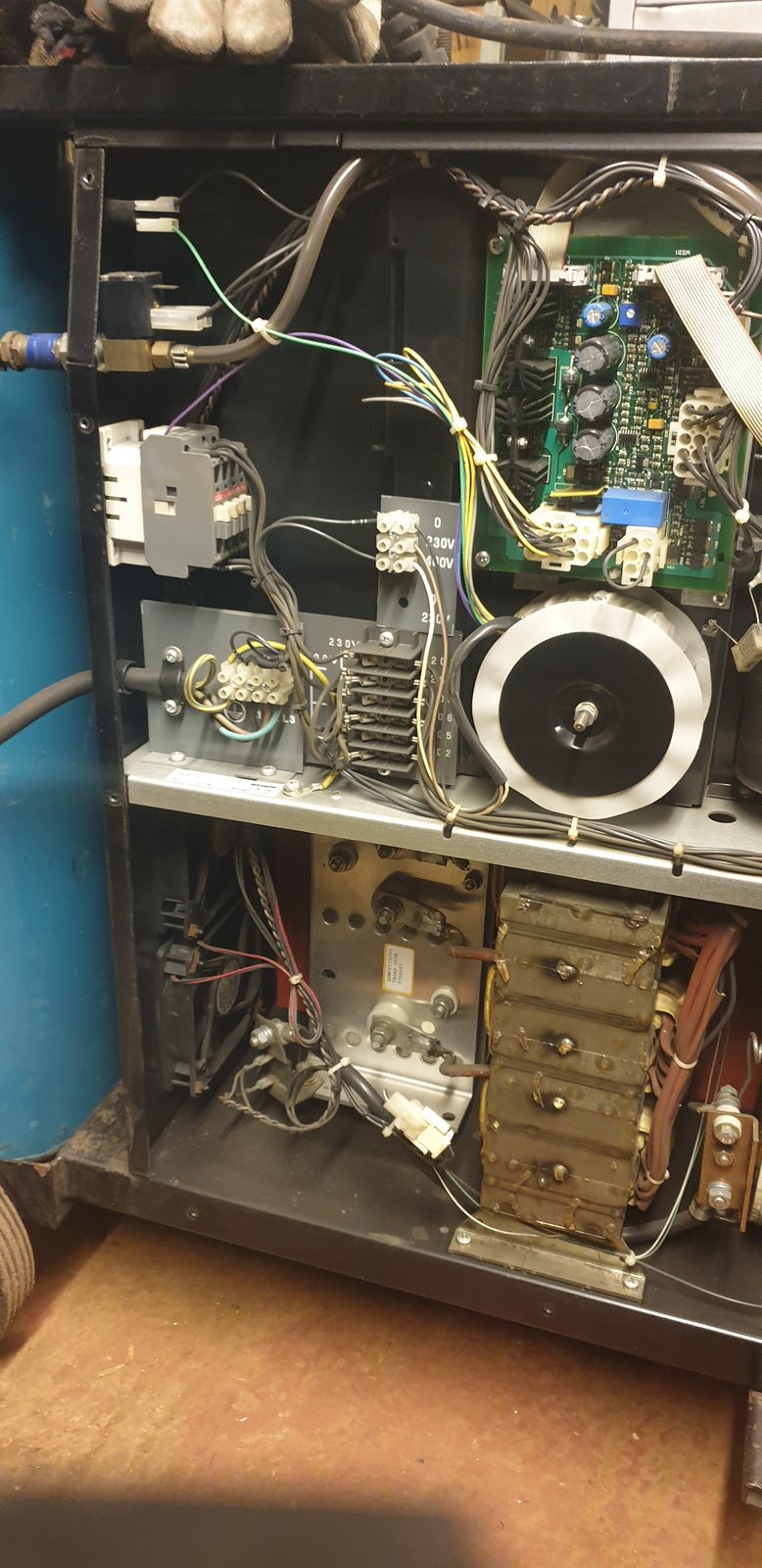

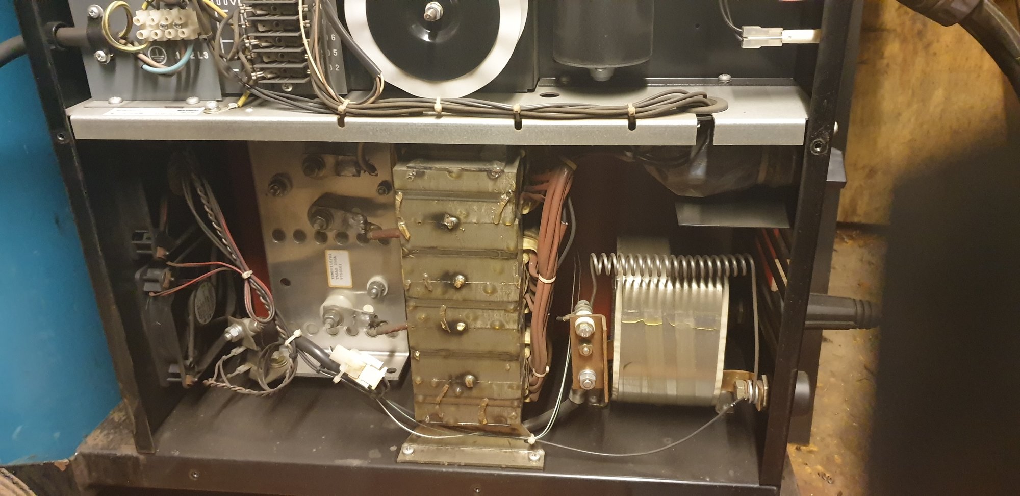

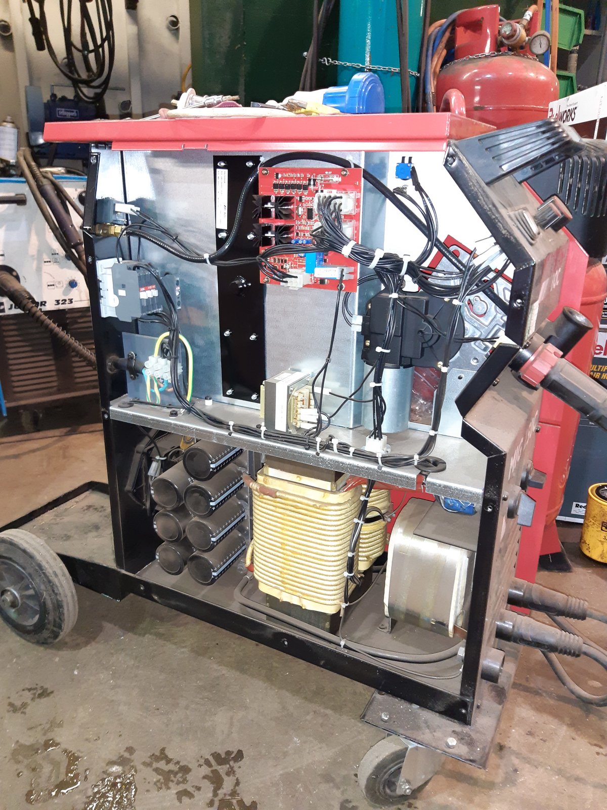

Another thing I like with these is the fan dont run all the time pulling in crap, I never though about it till I pulled the side of my Cebora it was full of it. crap that is.I've had the welder at least 10 years and this was the first time I've had the cover off. Just shows how good they are.
