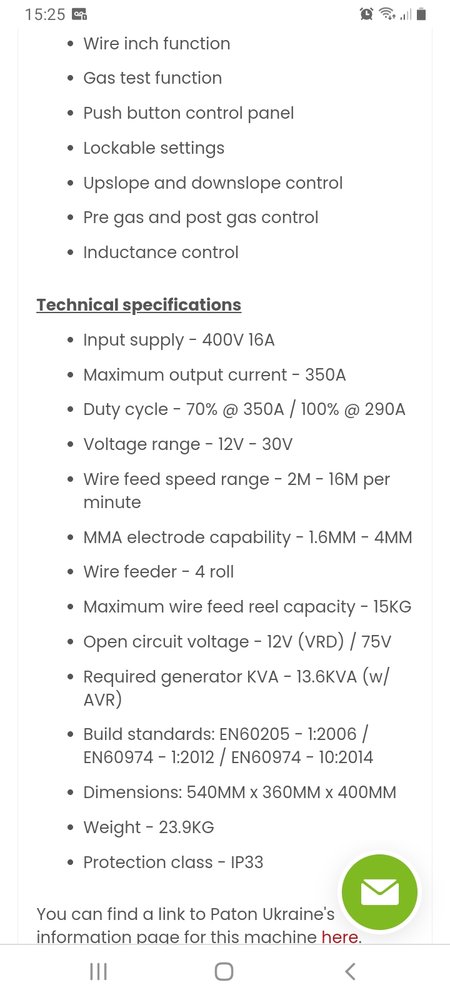

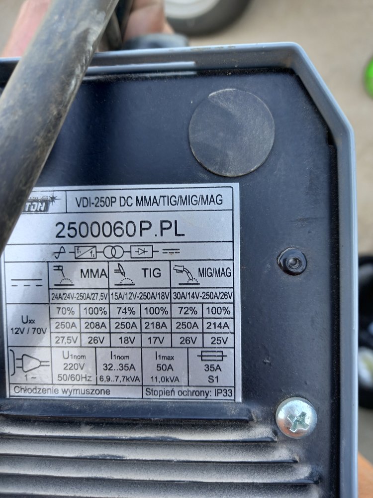

50a pull on 250a on the mig?? but nah im moving to 3 phase bud but thanks for that info.. i wonder what the 3 phase model on that paton requiresThis is the back of my 250 paton and I believe its far better to the rebel I've not use a newer kemppi so I can't compare it hope this helps
