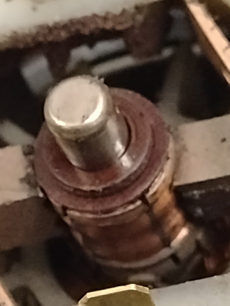

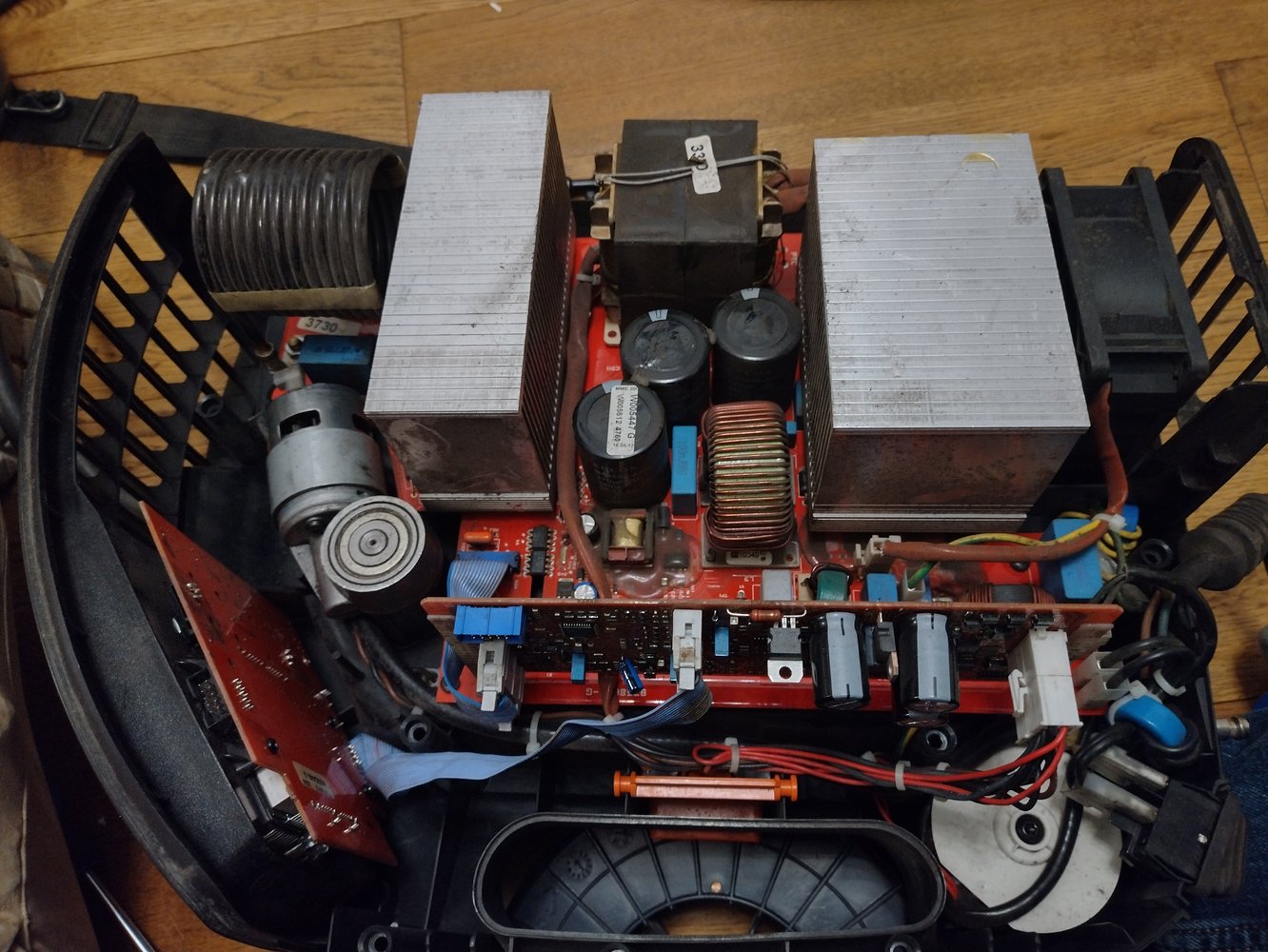

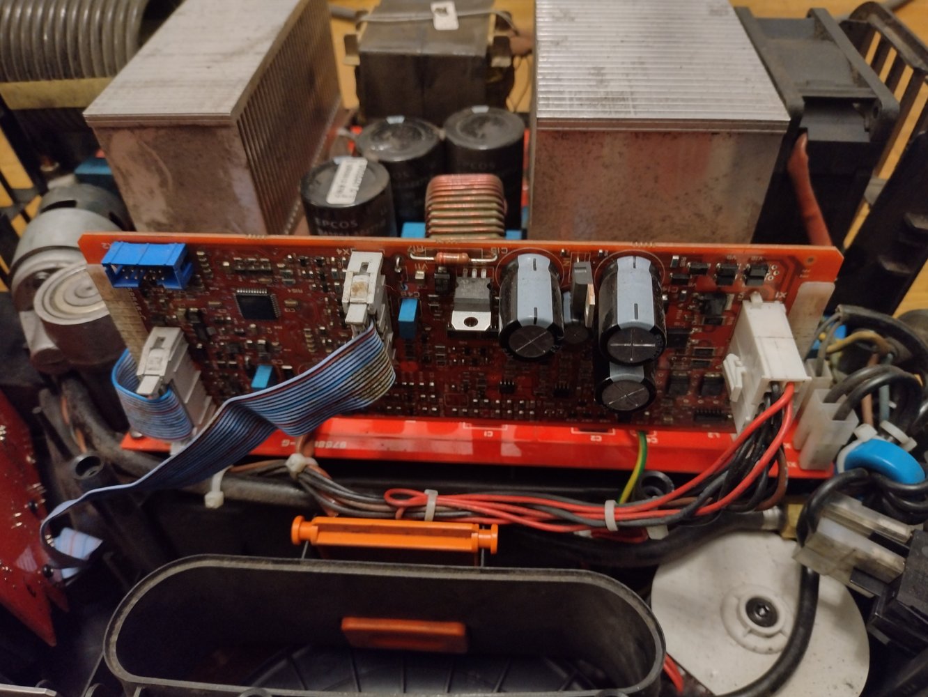

It seems like the wire feed motor is struggling...it does turn on pulling the trigger but it's not really got a lot of torque for some reason (I can easily stop it with my finger for example). Today I stripped the machine down....gave it a blow out and reassembled (it was quite dirty inside) but it's still the same.

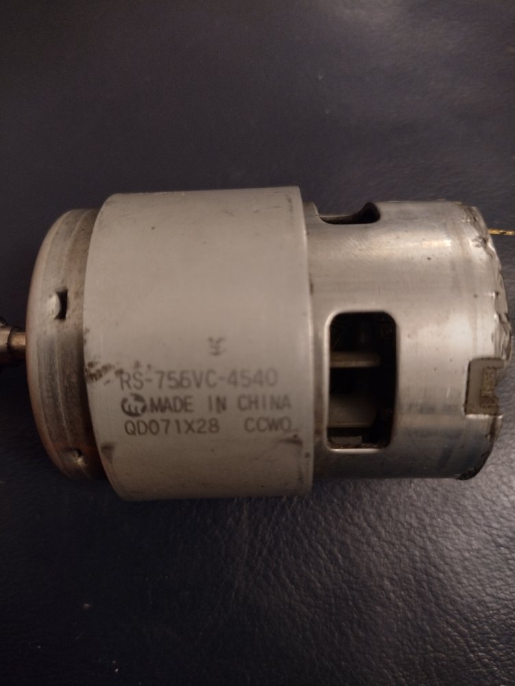

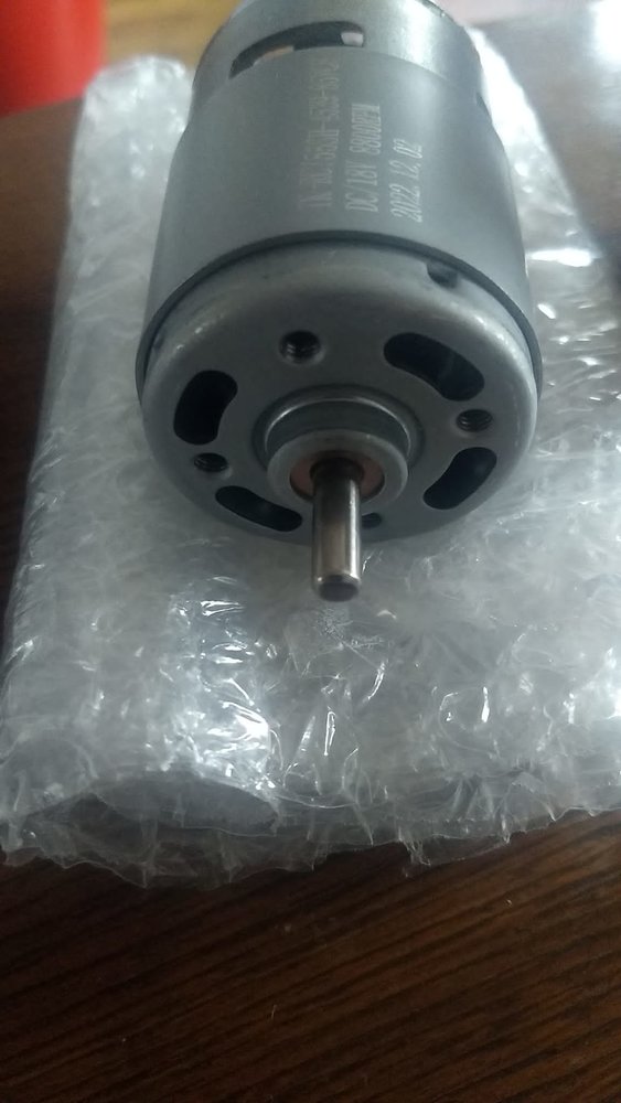

Sadly a replacement Kemppi motor (with gearbox) is £180 so I'd really want to be sure it's the motor before I throw money at it....I'm thinking my next step should be to measure the voltage at the motor to see what's happening.

....bit pricey for what is basically a strimmer/drill motor me thinks!
